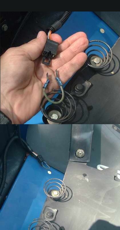

I agree that they are there for my own safety and would like them to function. The seat has been replaced with an aftermarket and doesn't have the switch or any wires coming out of it.... that one will be last. The PTO and Parking Brake I want working.

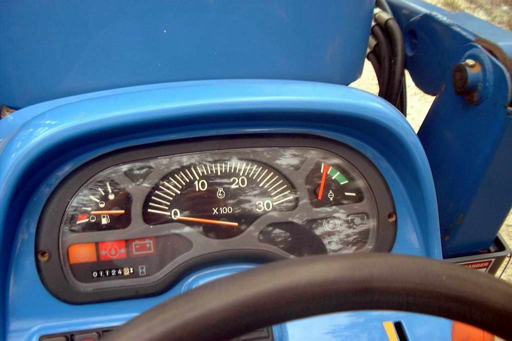

I also searched and read a lot of info on the temperature gauge... mine us usally cold, below the green, but if I'm mowing or running it at 2500 rpm constantly it will get to the green, otherwise, just driving around it stays below the green. Anyone else like that, or should it be in green even at lower rpm's?

Here is a photo of my seat jumper. You can see the switch between the seat base springs. I just disconnected the plug and put the spade jumper between plug connections. The switch is normally open and closes with your weight in the seat.

There are three issues that can have a huge effect on your temperature reading.

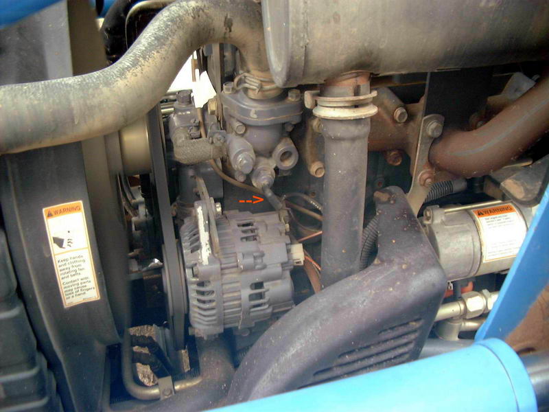

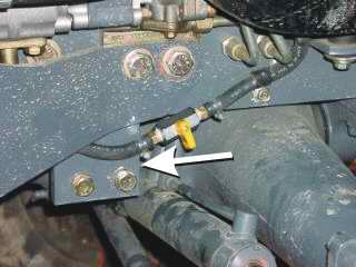

1. On early model tractors, there is a block drain hose that goes from the engine block to the radiator. It looks like 3/8" fuel line/heater hose. That hose provides enough bypass so that in cool/cold weather, the engine never heats up as it should. Below is a photo of a cutoff valve a member installed on his tractor (not me). I installed a brass needle valve on mine, but in the exact place shown for this valve.

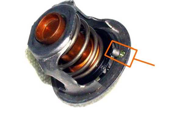

2. The 2nd problem is the thermostat. New Holland's thermostat has a small brass air bleed valve that dangles down on the rim of the thermostat as shown below. When water flow swirls through as the thermostat opens, the less-than-ideal design of this thermostat allows the dangle to become lodged under the flap of the open thermostat. At this point, the thermostat cannot close to control the engine temperature and the engine never comes up to full operating temperature. If you have the problem, just remove the thermostat and clip off the dangle. The tiny flow through the air bleed hole will not effect thermostat operation. There's no need to replace the thermostat, just put it back into the tractor using sealant on the gasket if required.
3. The third problem is that the temperature gage often goes out of calibration due to age, moisture, and sun exposure on the inst. panel. To test the gage, Pull the wire off the temperature sending unit as shown below. Pull the plastic back on the wire end and hook an alligator clip to the female spade connector. Leave the sending unit disconnected. Now, take the other end of the alligator jumper and attach the alligator clip to a good ground like the ground lug on the back of the alternator. Next, turn on the key while watching the temperature gage. If the gage goes to the maximum reading all the way up in the top of the red (2nd photo), then the gage is okay. If it only rises part way, then the gage needs to be replaced. The gage is sold individually by New Holland. If you have to do that, I'll send you a set of photos showing how.

Happy New Year! Thanks for all the information... I finally got to the thermostat issue. I opened up the housing and there was not a thermostat present! Apparently the previous owner removed it. Being Saturday, my local dealer closed at 1pm and it was 12:50 of course. I called up there, they had the parts and left them outside the door for me (after paying of course). It's funny, cause I just replaced the thermostat in a Jeep that I have and it was $4, this sucker was $40! Must be made of Gold-
In any case, I put it in and the temperature looks great now! Woohoo.
