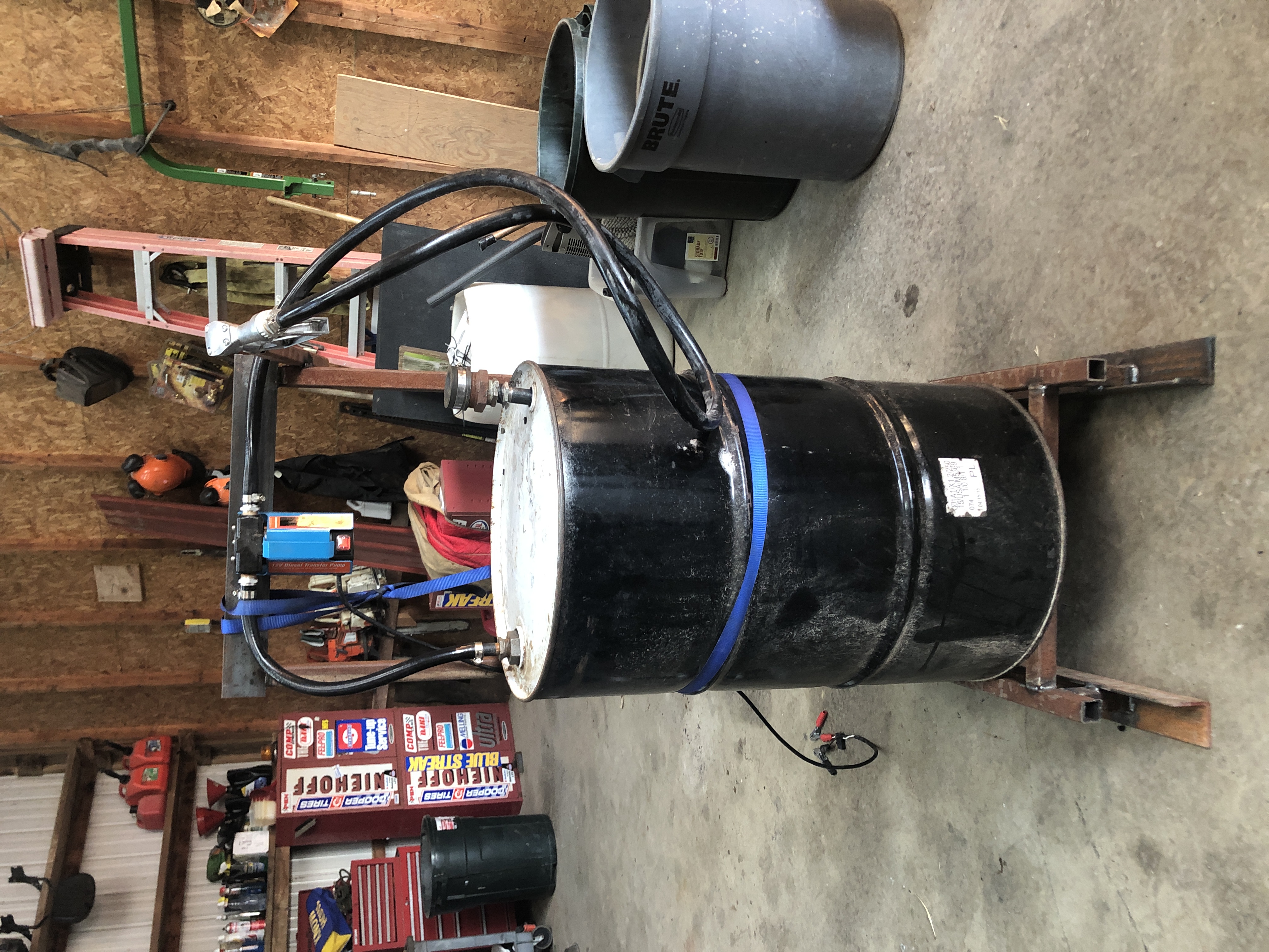

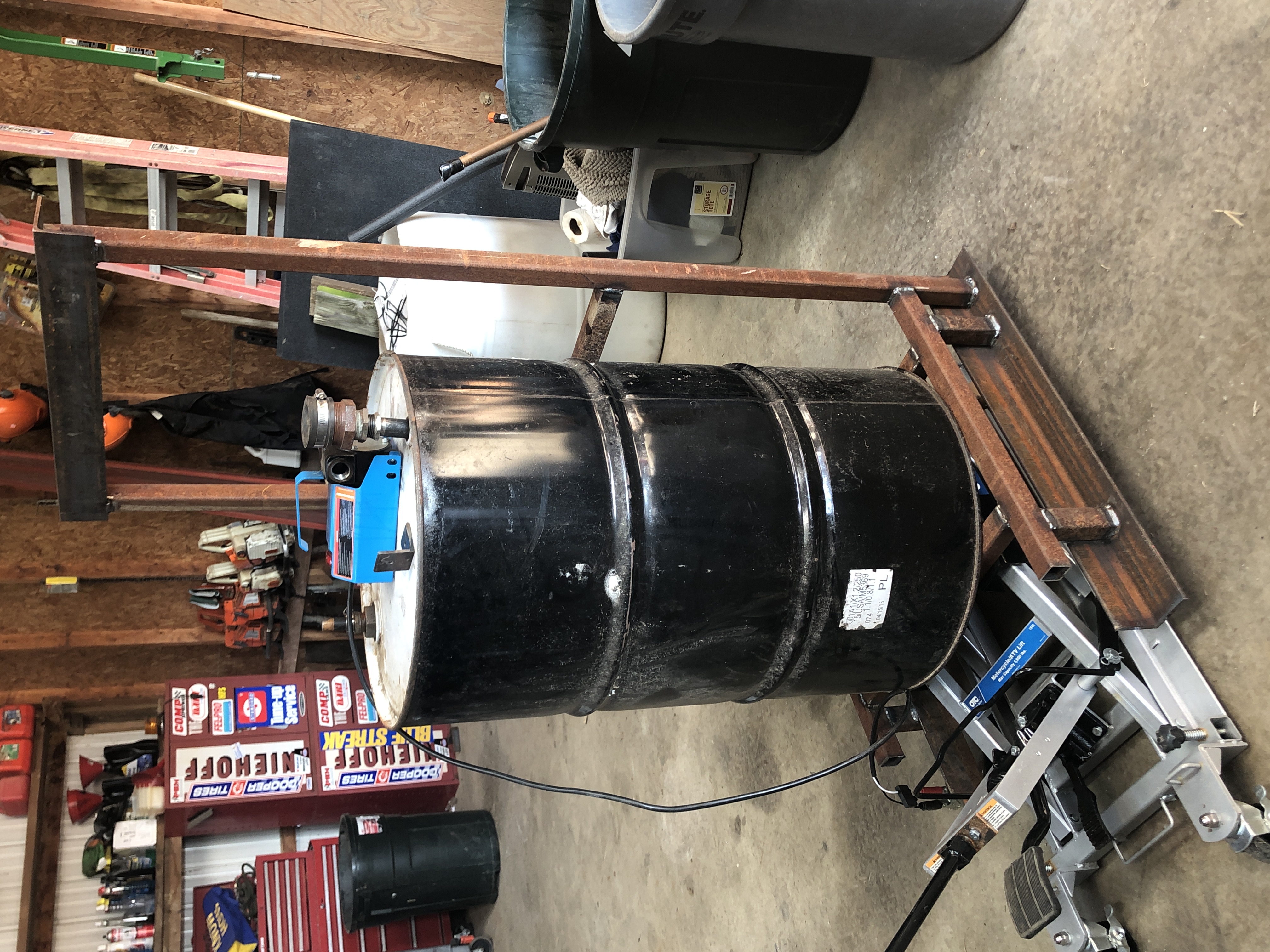

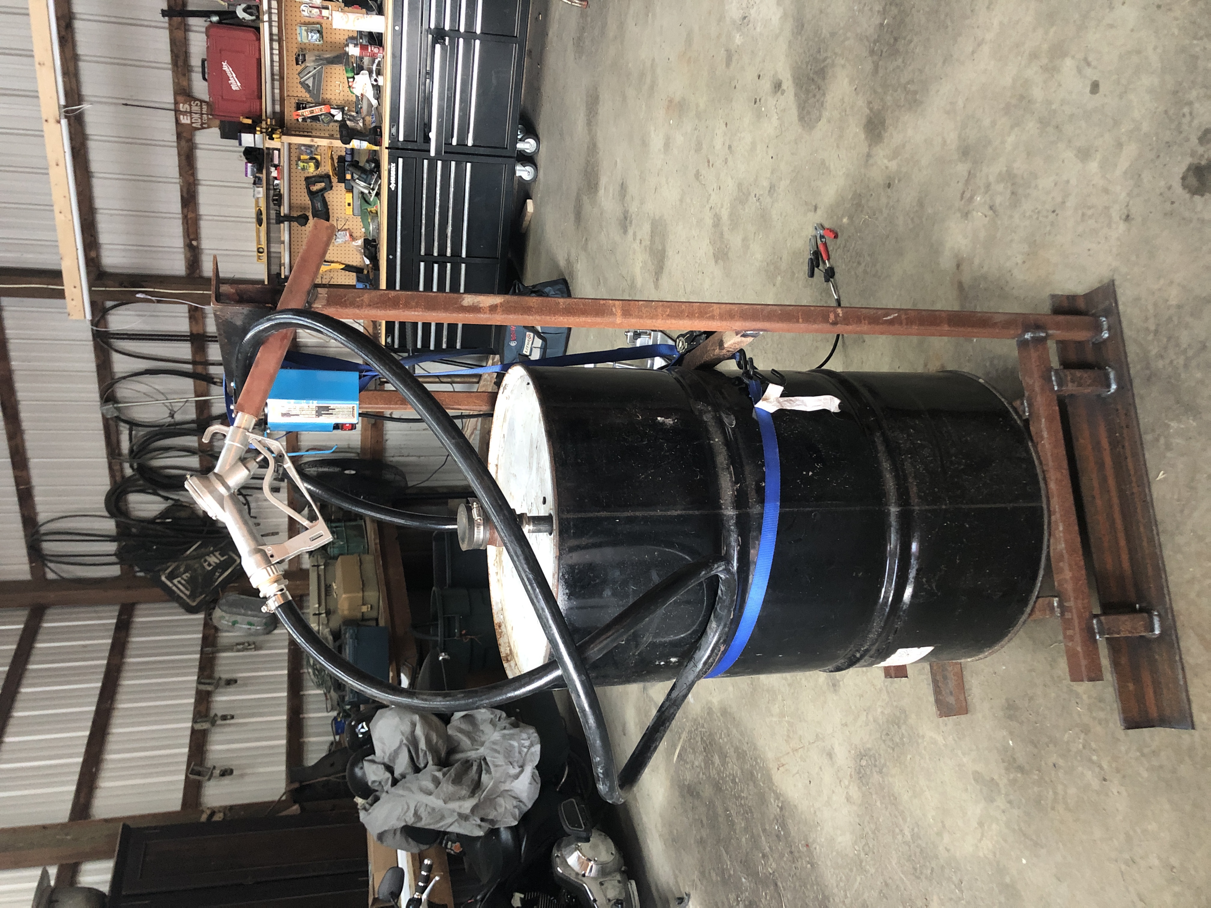

I got a clean 55 gal drum and 12v pump from a friend for free ! Had some scrap metal around the shop and some time ! boom ! I was going to put wheels on it but decided to just make skids and move around with my motor cycle jack. It will sit in trailer better when I take it to fill it. Plan to add a filter and still looking for a 115v pump. My 5400 tractor holds 15 gallons and 997 mower 14 gallons both sip fuel but it will be so nice not to deal with those 5 gallon cans anymore

I like that idea. I hate 5 gallon jugs too.

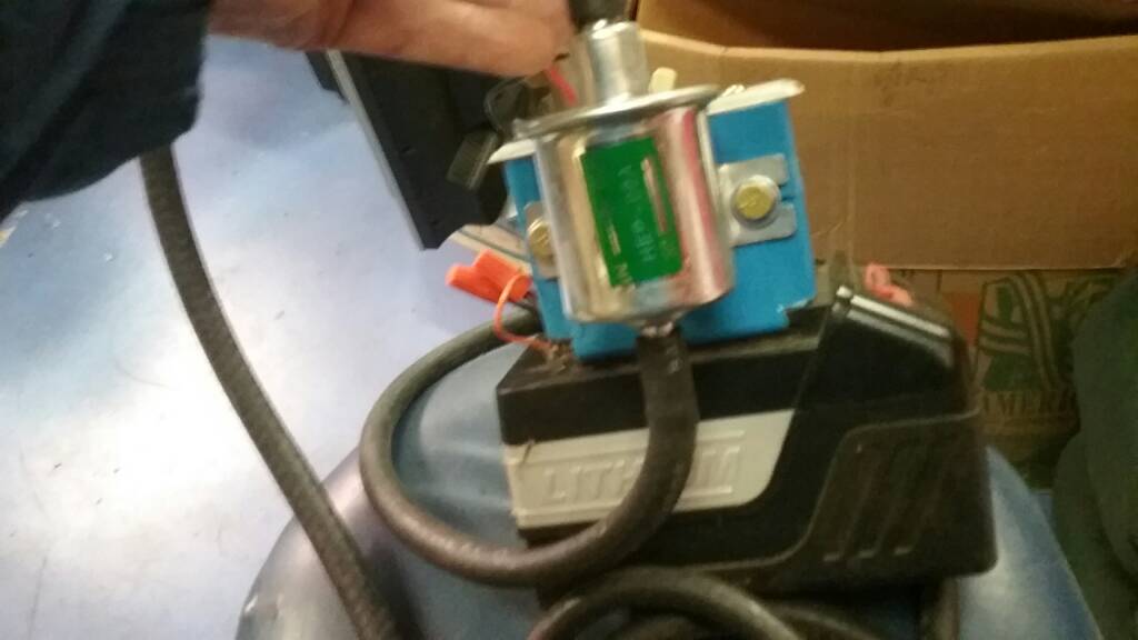

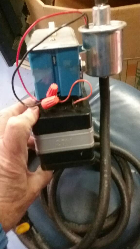

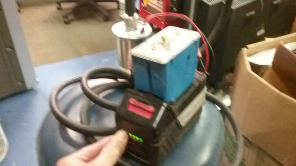

This works for me. It was stuff I had laying around. The 20volt Li-Ion battery was on clearance at WalMart (MTD labeled...$7), any similar 18-20 V battery will work.
A 12v fuel pump (not expensive if you order from ebay). Switch, wire, couple spade connectors, fuel hose.
It runs on higher voltage ok. Pumps about 2-3 gpm. It lasts a long time, I charge it on a supply I made.20181101_175606.jpeg20181101_175633.jpeg20181101_175659.jpeg

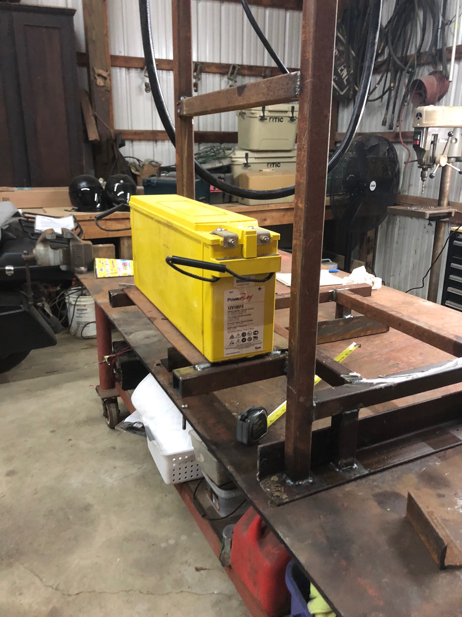

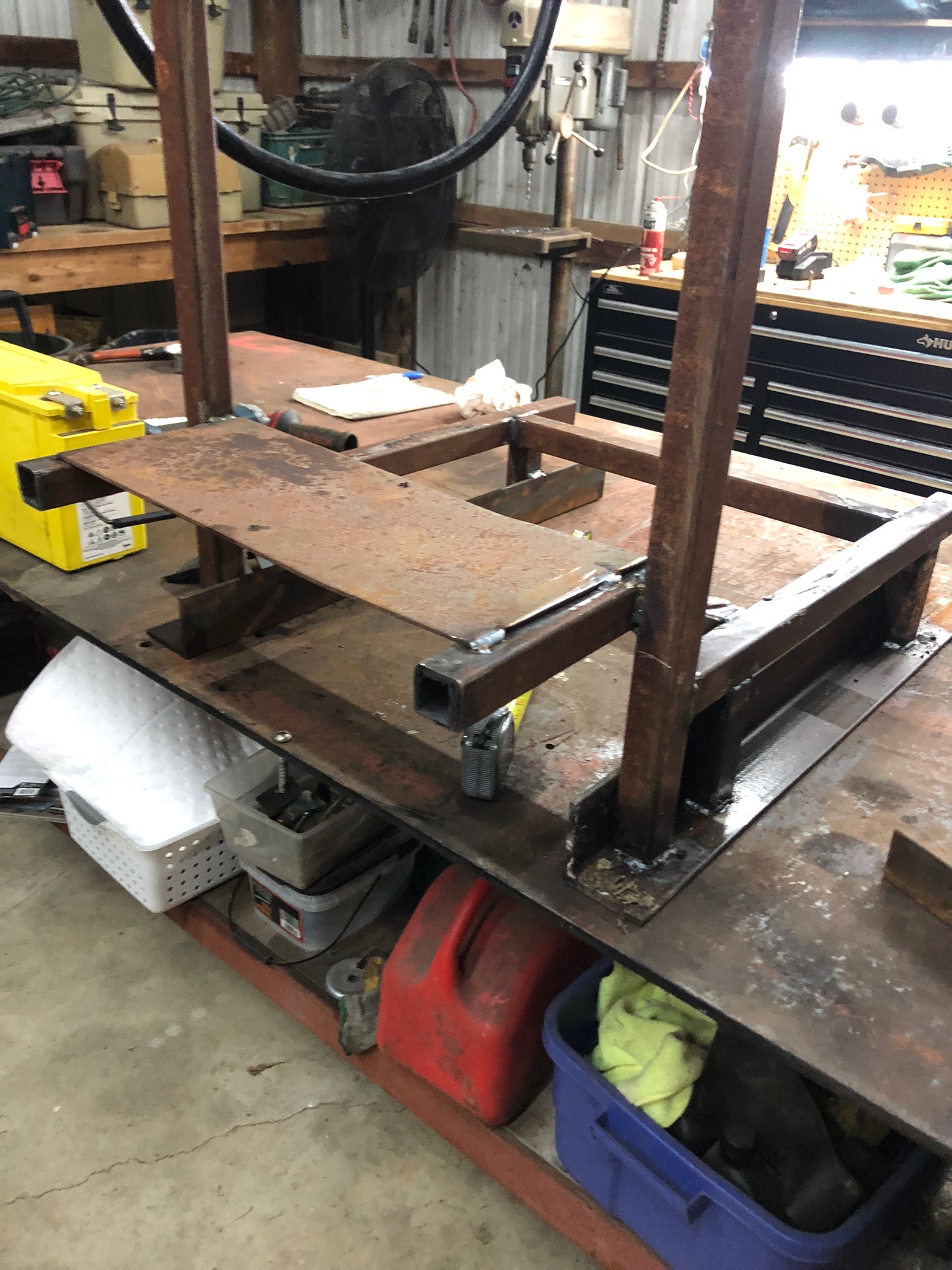

Frustrating update. I thought I could tack weld the barrel to the frame to keep it secure - turned welder down some - welded lip of barrel to frame then it happened !!! leak ! ugh so I pulled mower around and fueled it and filled up some 5 gallon cans.
After grinding off weld and getting barrel off I decided to build a battery holder while I find another barrel. Was gifted a nice battery from a friend and dug into scrap pile and found enough metal to make a holder. I have all thread and a plate to hold battery when i mount it. somewhere I have an extra trickle charger for my Harley I plan to leave that on the battery.

I’ve got a gravity flow tank that works a lot better than people said it would. It’s even got an inline filter. It’ll run 30 gallons in under 5 minuets. The one trick to using a gravity flow system is park at the right distance to keep the hose slack out. It doesn’t like flowing down a loop and back up. I would have thought it would make much difference since the end point is still lower than the start point and it’s not changing the height of either but it does.

How will you load it on and off your trailer?
