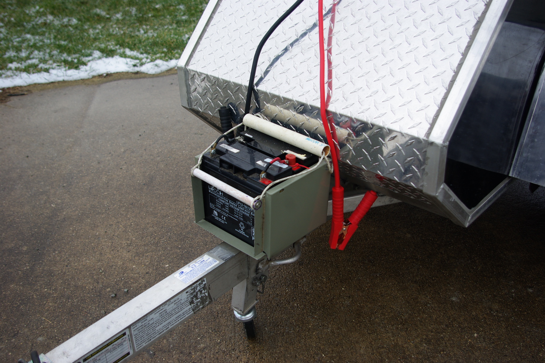

I put my transfer tank in a small 4x8 trailer.. that way when it needs fuel, I just hook it up to the truck and drive it down to the station. For a power sourc,I use a battery jump pack and the alligator clips right to the jumper cables. For the few times a year that I need to fill machines it is super easy and no aggrition with keeping a trickle charge on anything.

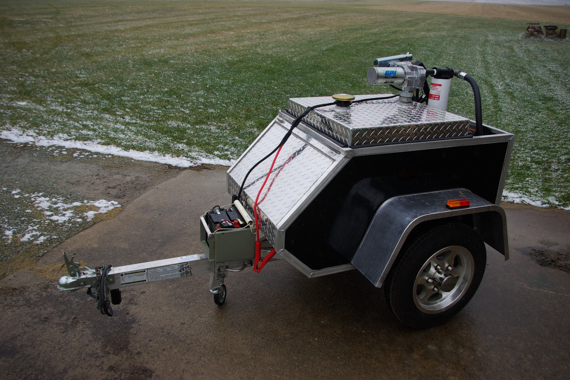

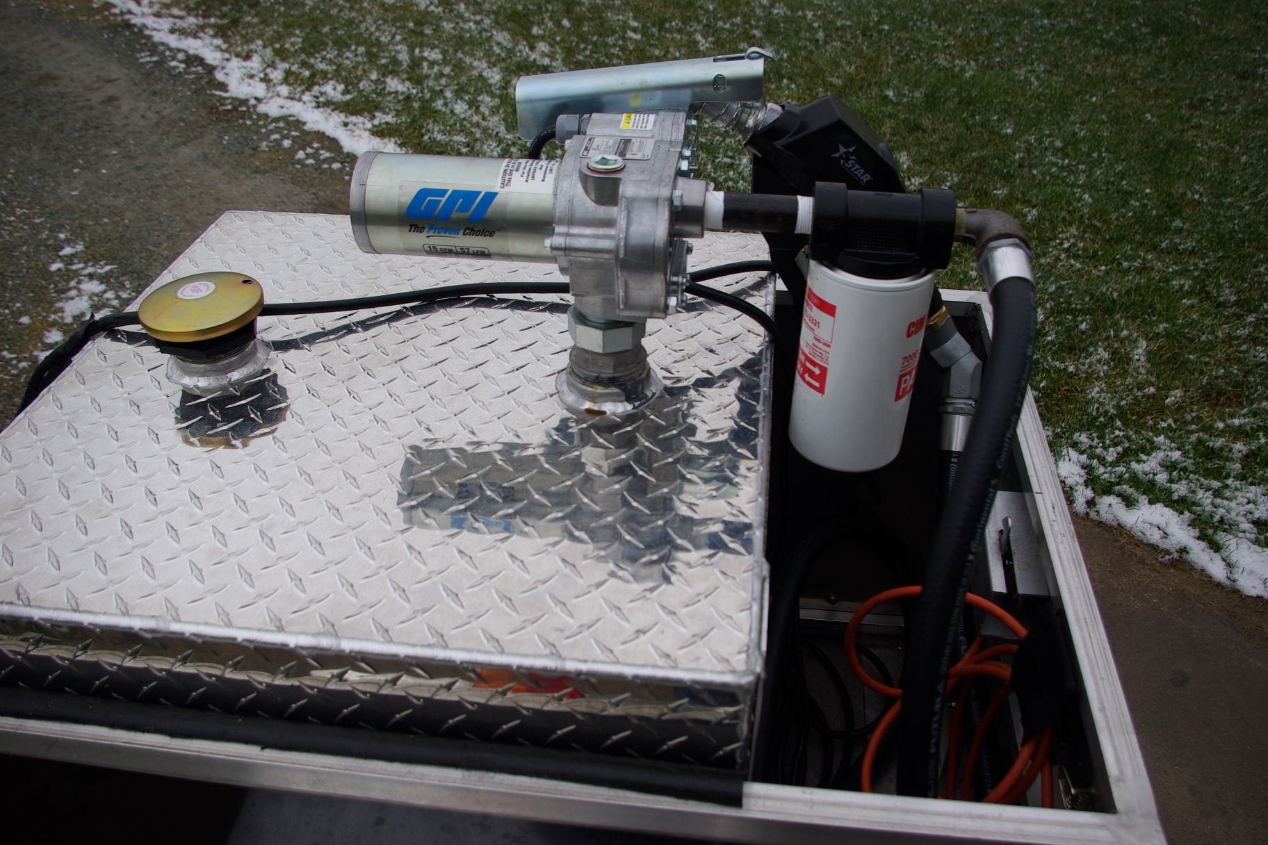

Ok, I'll admit this is not in the $8 investment group, but I have got to show it off and it meets the thread title. Tired of lifting 5 & 6 gallon jugs to refuel the airplane (esp. wing tank) with non-ethanol car gas. Considered a stationary tank but delivery charges were outrageous. Wanted an aluminum tank and found a 55 gal. rated for transfer/transport (DOT approved). A used trailer with torsion suspension took a while, but found this used motorcycle trailer on CL which was just wide enough to fit the tank. Had to cut a hinge off to remove the cover of the trailer but it could be replaced. Battery pack is removable. Yeah, I had to put a reg plate on it too. Compared to the similar commercially made trailers ($4k+) I got less than a 1/3 in it.
