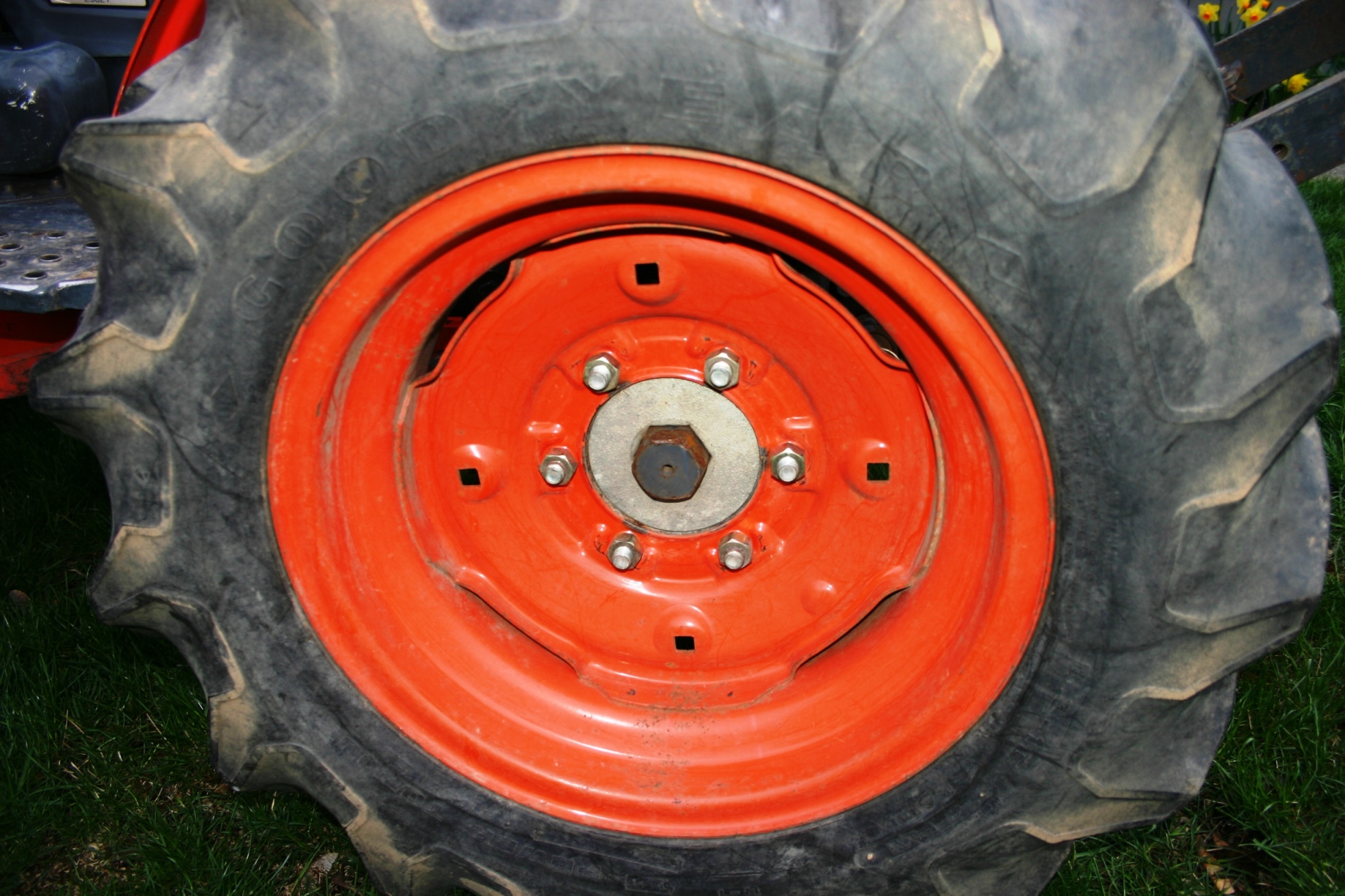

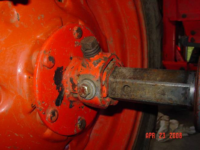

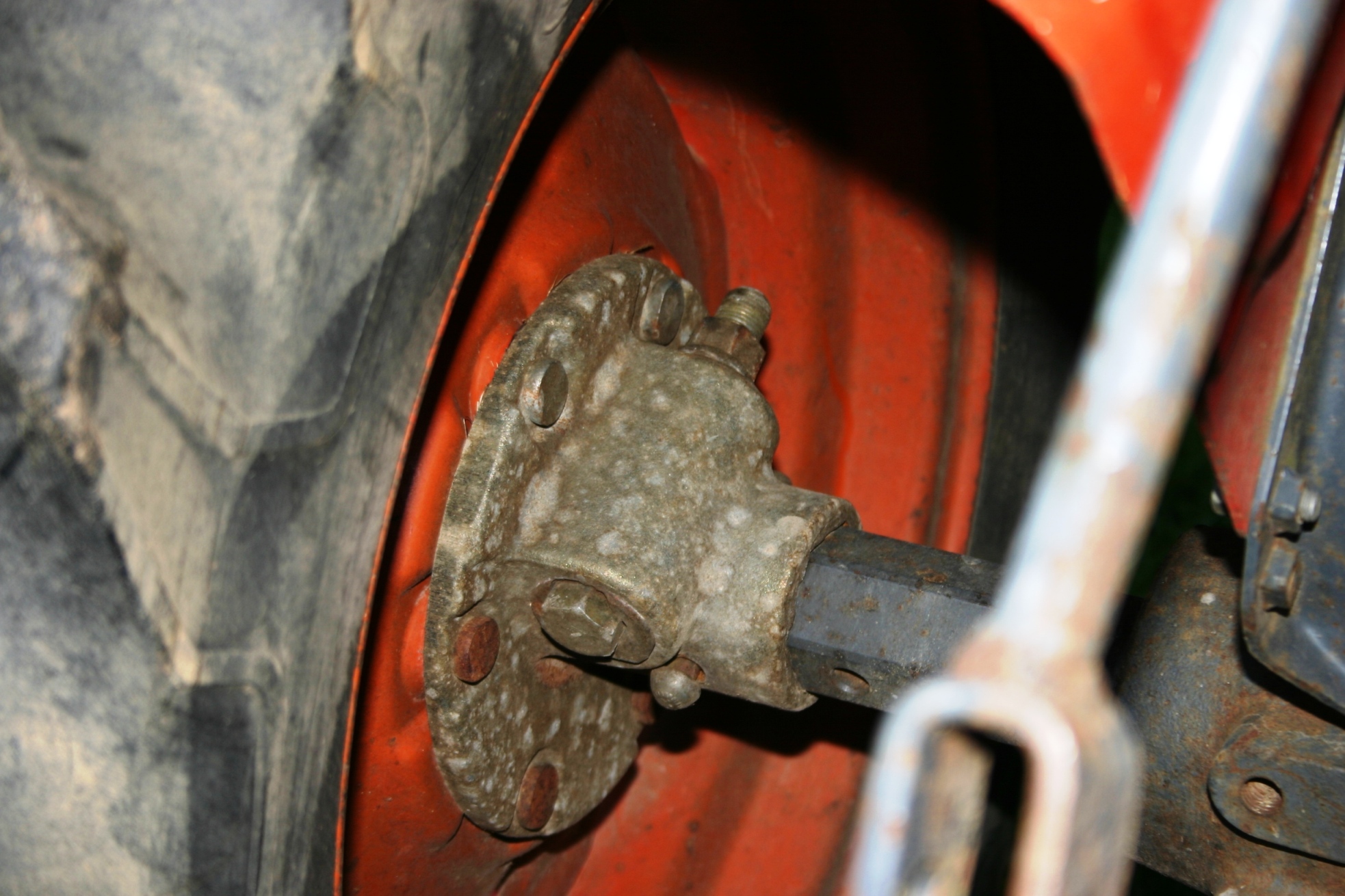

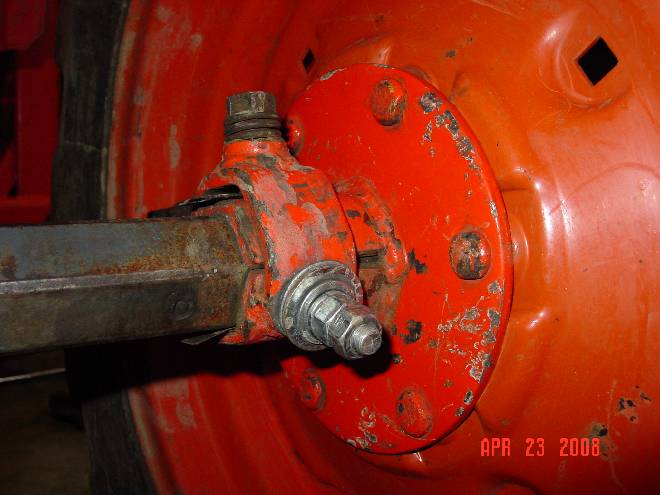

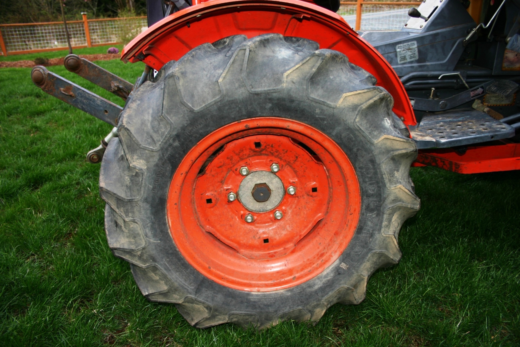

Chuckanut, ---.I noticed you have different rear hubs on your tractor,the new style I believe. Mine are the old ones that get loose form time to time. Do You think you could take a close-up picture of your rear hub for me to check it out? Mike
Ok mike, here are my pictures of my hubs....
(whisper the next sentance ;) ) What are exactlly we looking for?
Chuckanut

I wanted to see what the new style hubs looked like. I am putting in some pic's of my hubs and you will see what I mean. I would like to have some for my tractor but I understand they are pretty expensive. I am not sure of the best place to buy them nor sure of the price. If you look at the 2 pictures you will notice shim under the pinch bolt on one of the hubs, which works pretty good to keep it tight. I see yours are not painted so it looks like they have been updated. I also put in a picture of my counterweight. It is 600lbs. Before I put the weight on I had lots of tire spin when using the loader and it was hard to steer because of the lack of ps. The rear tires are also loaded and weight 135lbs a piece. It now steers very easy, even with the loader full. I can push into hard ground with plenty of traction. I am still looking for the price of the manual and will post them when I find my receipts.

Wow!! I had no idea they have that much difference. So to make sure I have your hub setup correct, You have one bolt that goes thru your axle and (what looks like) a Retainer ring and the second bolt is cinched down on the hub to lock it in place. It looks like it would be a straight swap if you had the parts.
Well I will try to find out the part numbers. That is when I receive my parts manual.

The part number for the hub is 66416-17303, around a $120 per side. But much better set-up.

Chuckanut, ya they would be a direct swap, there is suppose to be a pin and a hairpin where the bolt is, just like yours. Mine had the bolts when I bought it. The counterweight is a loan from a friend. I thought it would be to heavy for the 3pt but it lifts it fine. The 3pt is rated to lift 1036lbs and so we tested it. My buddy and I stood on the block and that was well over 1000lbs and it lifted us fine. The front of the tractor is still planted firmly on the ground. I keep saying I am going to make my own but have not got around to it yet and he is not in a hurry to get it back. When I mention getting it back to him he will just say not to worry about it. He is a good friend and we help each other alot. Before I had the weight on the back it was very difficult to get any traction when using the loader to dig. As soon as the weight would come off the front tires the back ones would spin. There is alot of info here on TBN on making you own and some really good ideas.My tires are filled with Calcium. When I bought the tractor I noticed that one tire was much lighter than the other. One was 75% full and the other was maybe 20%. I took them to Les schwab and had new Calcium water put in both for $43. The color of the old fluid was very light brown and the guy said that the wheels were ok and if I keep it at 75% it would keep the wheel covered and be less likely of rusting out the wheel. Of cousre if you run over something and put a hole in the tire it will leak out. I do alot of work in the woods, brush and heavy limps and have not had any problems so far. Oh I found prices on the manuals. parts manual for tractor was $32 , the manual for the engine was $33, tractor manual was $157. I took another look at the tractor manual and Its not a bad as I thought , the picturse are not very good but the rest of the content is not to bad. But I would probably try to get a better price if i were to do it again. Most of the photos are just to dark to be of use. Maybe I just like pictures.

My hubs were $300 apiece.:confused: :confused: I tried shims on the old ones but that was a never ending repeat job. The hubs make a world of difference.:D :D
