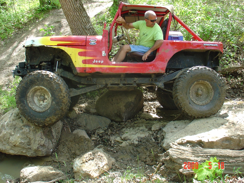

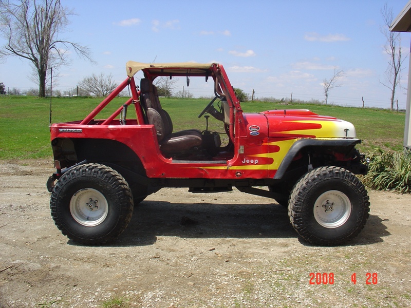

Good find. You'll get many, many years of service out of that Jeep. 4cyl is fine for what you will do with it. If putting a lot of hiway miles on a Jeep I prefer a 6cyl. But you'll be fine.
Cut the sway bars off and the front track bar. Then weld the rear diff solid. You'll then be surprised how well it'll get around on the farm.
You've got a Dana 30 front axle and a Dana 35 rear. Being a 4cyl they are 4.10 gears.
If you want to run a slightly larger tire the cheapest and easiest way to get clearance is a body lift. 1" will allow a couple sizes larger tire. 2" will allow a 32" tire if you don't mind a bit of rubbing when turning sharp. I don't recommend more than a 2" BL.
I'm 5' 10" tall. I like seat risers. Best for me is 1.5". Makes seeing over the hood much easier when offroad. Also uncramps the legs a bit.
I wheeled an 87 Wrangler for 15 years until I lost it in a shop fire. It had evolved quite a bit by then. :)

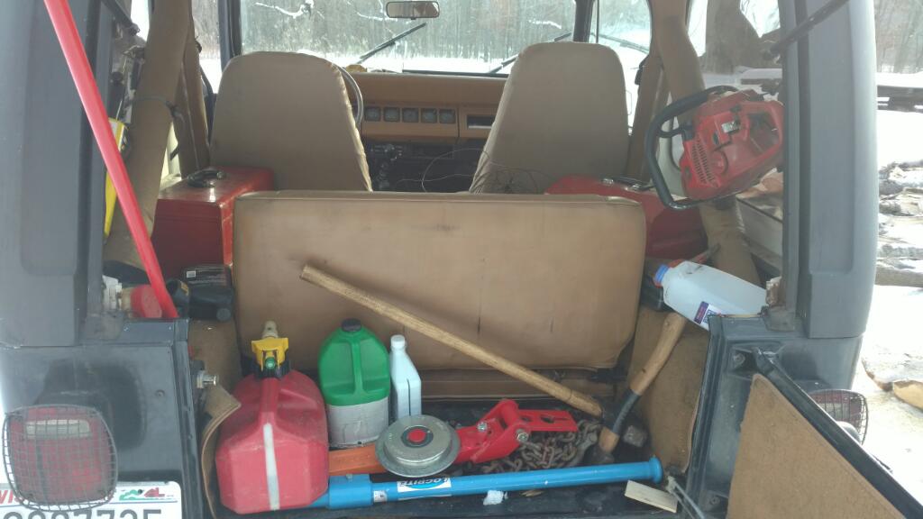

I just wanted to add an update. The Jeep has become indispensable on our farm. I always figured that a UTV wasn't worth buying because our place is relatively small (we own 20, and I spend time on the neighbor's places with 10&20 each, so I roam about 50 acres). I was wrong. I still can't imagine buying a new side by side, but even a cheaper used one would be worth it.
The Jeep carries my 50cc chainsaw, gas and bar oil, a chainsaw toolbox, another toolbox with a basic set of wrenches and sockets etc, a pickaroon, a 30" cant hook, my splitting maul, saw safety gear, a first aid kit, a couple of chains, a bernzomatic MAP torch and few other odds and ends. And it's still got seats for someone up front and 1 person in the back seat (2 could squeeze in).

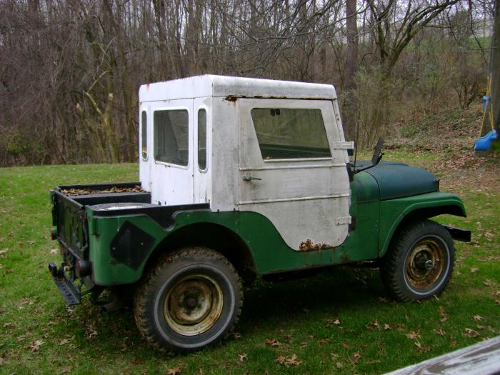

Long ago, almost every farm Jeep in my area had a half-cab so it was a short pickup.
Bed extensions were also common.
