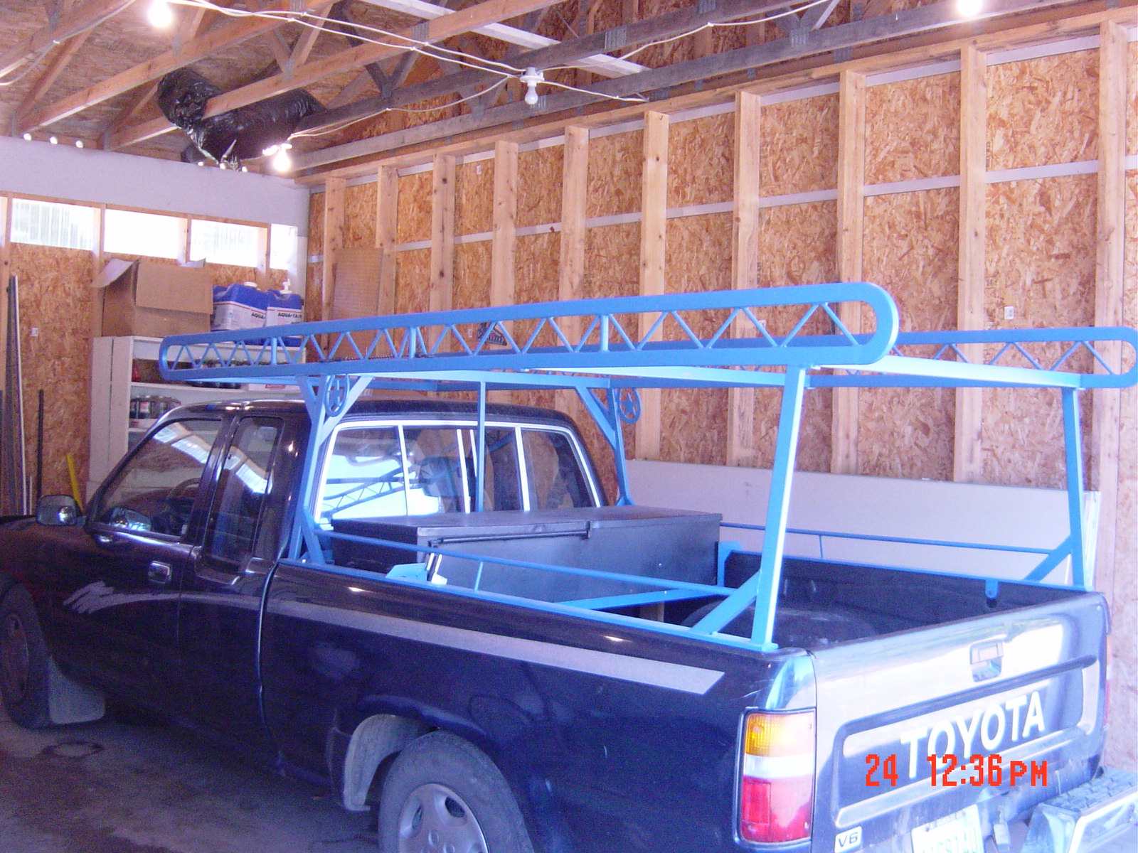

When I built this lumber rack, all the square tube is 1/16-inch wall. I used .023 wire. My Linde Mig machine had lots of trouble feeding that small of wire. I had to keep the gun as straight as possible at all times. If I would have had the Dynasty at the time I would have just Tig welded everything.
A lot of times on thin material, if I can I run everything down hill. But when building things you can't always roll it around to the best position.
