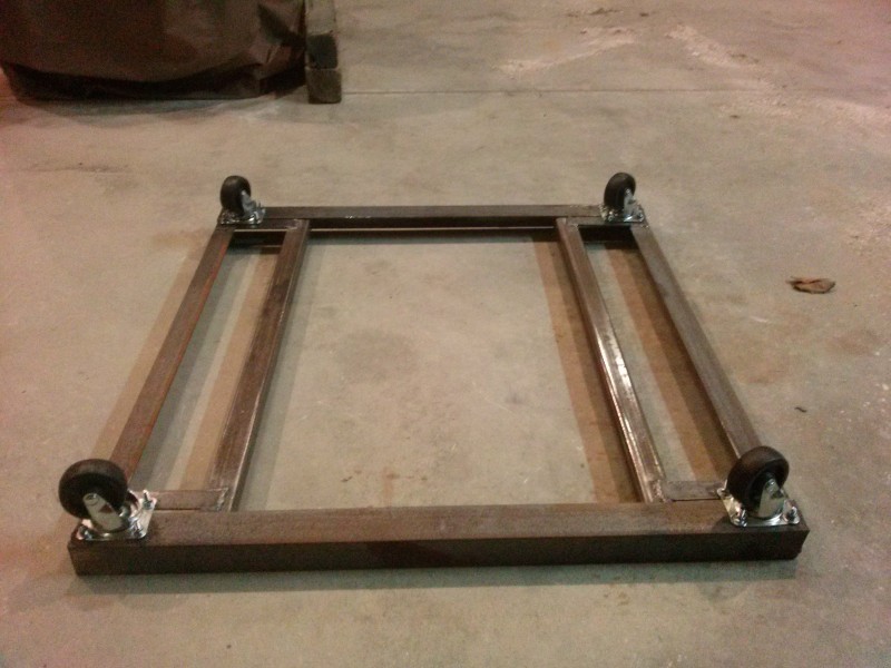

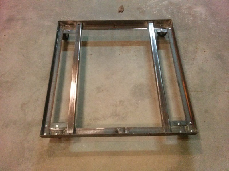

Here are some photos of the dolly that I made from the steel crate/frame that my chipper came in. I got lots of welding practice on this. I didn't have to buy any steel. All of it came from the crate except about 2 feet of 1.5" x 0.125" flat bar that I had left over from another project.

I like your dolly idea, never thought of it because I don't have a concrete floor storage area. But my question, issss, so you lower it on the dolly, disconnect the three point, disconnect the drive shaft,right? Well, is this thing tippy at all? Mine has a stability leg on the back left side of the feed that is supposed to be used if you set it down and leave it be. How stable is the chipper on your dolly?
   / My new Woodmaxx WM-8H wood chipper #48
I'll have to get back to you on that, because I haven't had time to really test, since I got the dolly together. When I took the photo of the chipper sitting on the dolly, it was still attached to the tractor.
With the chipper sitting on the floor, and detached from the tractor, I tested by pushing down on the infeed chute with that stability leg retracted. I could tip it, but it took some force. I think the leg is to prevent someone from accidentally tipping the machine over.
My son and I discussed the design of the dolly and he convinced me to make the stance wider and longer than the chipper base. I gave it an additional 6 inches each way. From my experience with the home-made dolly that I set my backhoe on, I know that when the caster swings toward the center, you effectively have a narrower base.
Due to the added height of the dolly, the rear leg won't reach the floor. My plan is to use a block of wood under the leg when it's parked.
I work part-time, with a rather indefinite schedule. I may get time this afternoon or evening to unhook the chipper and really test the dolly. I'll let you know how it goes.
   / My new Woodmaxx WM-8H wood chipper #49
Cool, thanks for the input and betcha I am not the only one interesting in your research and development efforts. chip chip hooray
   / My new Woodmaxx WM-8H wood chipper #50
hslogger -
This afternoon, I unhooked the chipper from the tractor and tested the dolly. I find it to be quite stable. You could tip it over backwards if you tried hard enough, but it would take some down force on the infeed chute to do it. I tried installing that stabilizer leg, down as far as it would go (still about 4" off the floor), then pushing down on the infeed chute. The leg will stop the chipper from being tipped over, even without a block under it.
The setup seems to be very solid in a side-to-side direction.
I probably should have used some better casters. I may change them. I used a set that came from a Harbor Freight mover's dolly that was rated for 1,000 lbs. I would say they are barely adequate for the weight of the chipper, which is a bit under 1,000 lbs. I had some of that "kitty litter" style oil absorber on the floor. That trigged the casters a bit. If I had swept that stuff up, the casters would have rolled easier.
When I reconnected the chipper to the tractor, I did it by moving the chipper, on the dolly, to the tractor, not moving the tractor.
My son and I discussed whether I needed to anchor the chipper from skidding on the steel dolly. The "quick and dirty" idea I came up with, was to use some large zip ties. I didn't bother with them for today's test, but might do that when the chipper is going to be on the dolly for a while, and possibly rolled around the floor a time or two.
Overall, I'd say the operation was a success.:dance1:
