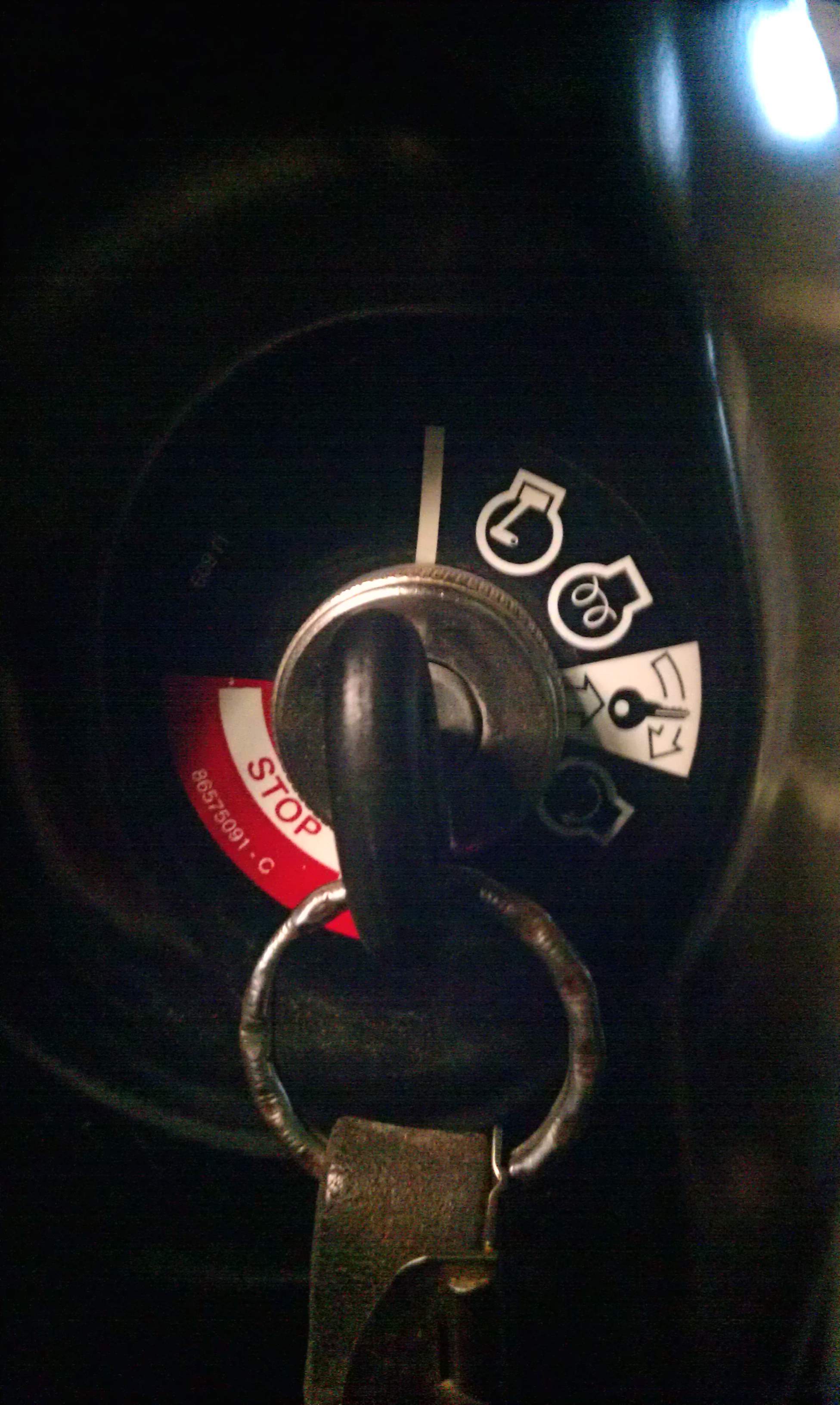

My switch does not go counterclockwise so that seems unusual to me.
   / my newly purchased TC30 wants to die, hard to start. #12

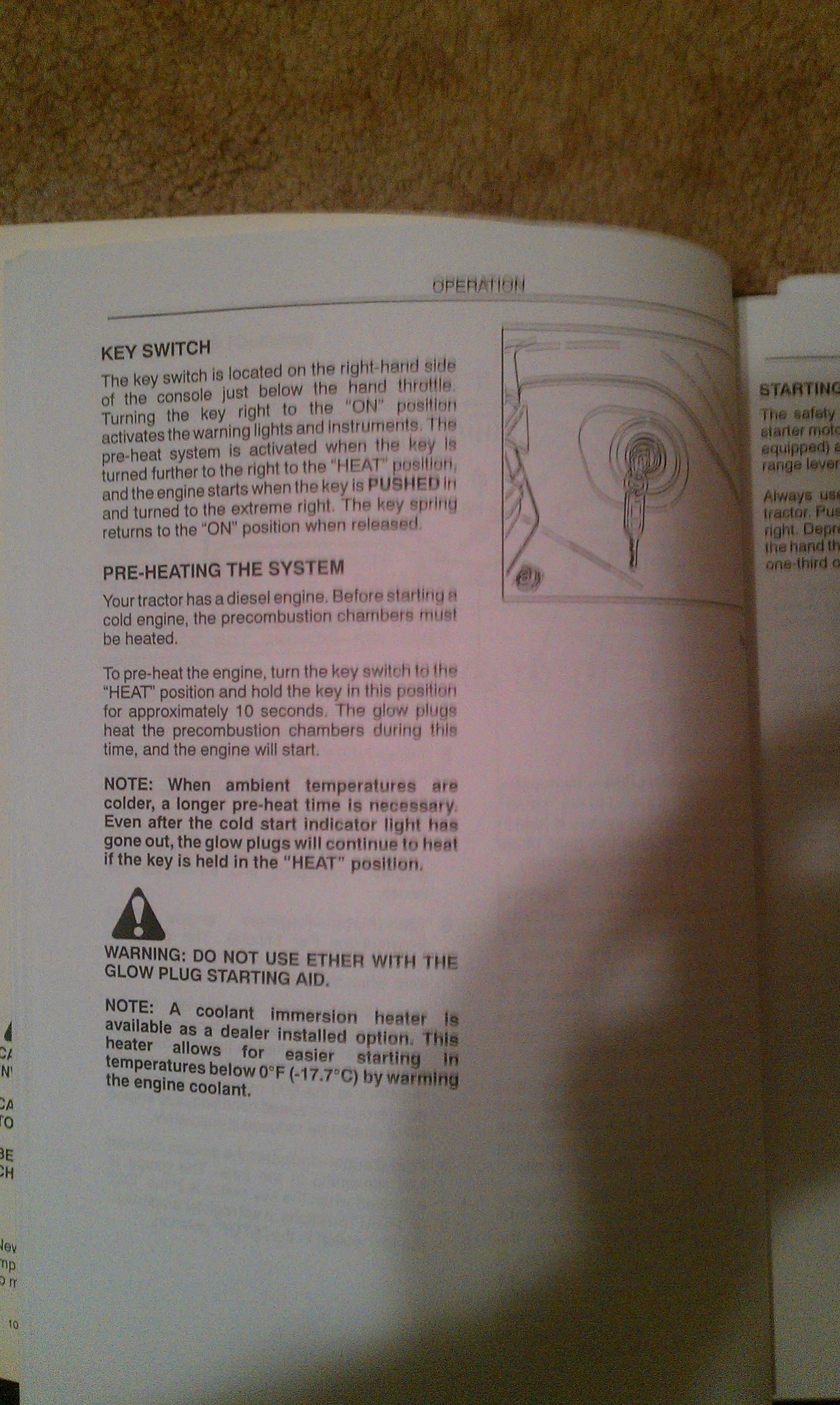

If you turn the ignition switch counterclockwise on mine the glow plug light turns on for 5 seconds or so. You'll have to follow the voltage from the ignitions switch.
   / my newly purchased TC30 wants to die, hard to start. #13
My 2003 TC30 switch turns back toward me (counterclockwise) and I hold it. The red lights light up and when they blink 2x, I release and start the tractor. -about a count of 12-20 depending on the temp. I even use the glow plug switch in the summer (count of 5).
Doesn't start easily if I don't warm the glow plugs after the engine is cooled.
My key switch needs to be tightened up- swivels easily - then I hold the housing as I turn the key.
Change the filters and fluids. Run it some, then change again (hydraulic too and front axle). Keep it greased. Great tractor- rugged.

My 2006 TC30 starts with the key turned counter clock wise, the glow plug light will stay lit for 10 seconds or so then when it goes out turn key clockwise an it starts on first or second crank. without useing glow plug it will take 10 cranks or so.
   / my newly purchased TC30 wants to die, hard to start. #20
If you use starting fluid do not heat the glow plugs. It can cause realy bad problems. Have you checked your valve lash. HF sells a diesel compression tester for arround 25 bucks that will screw in to the glow plug hole.
