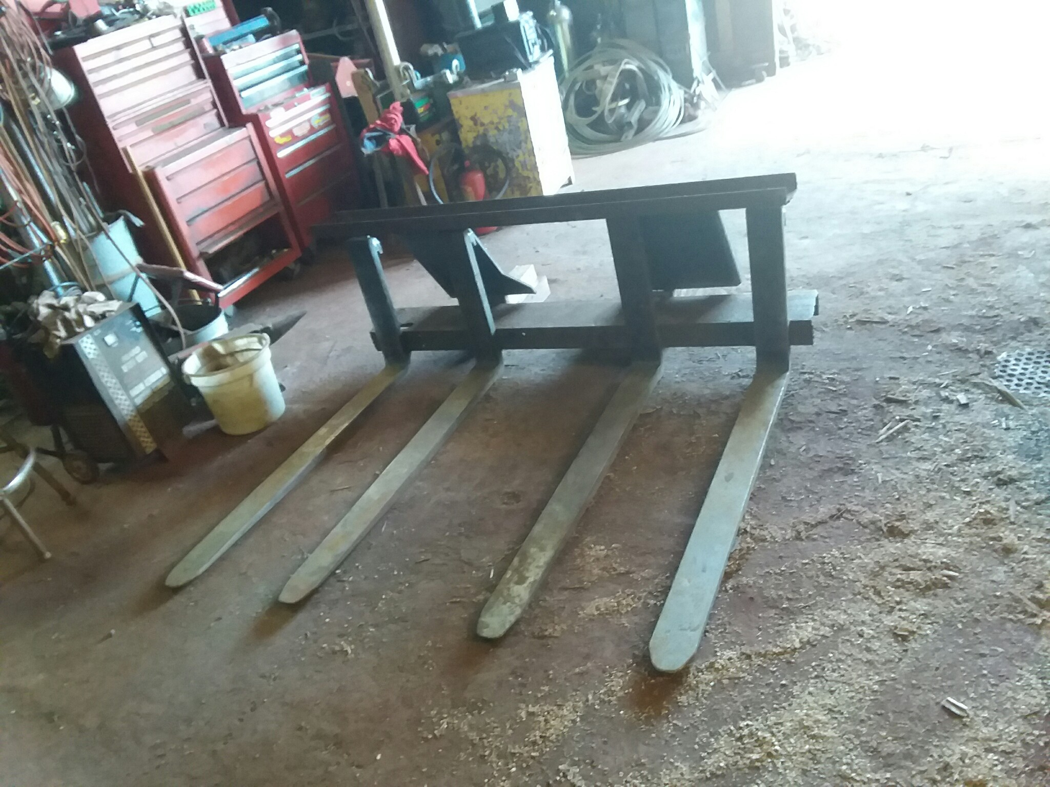

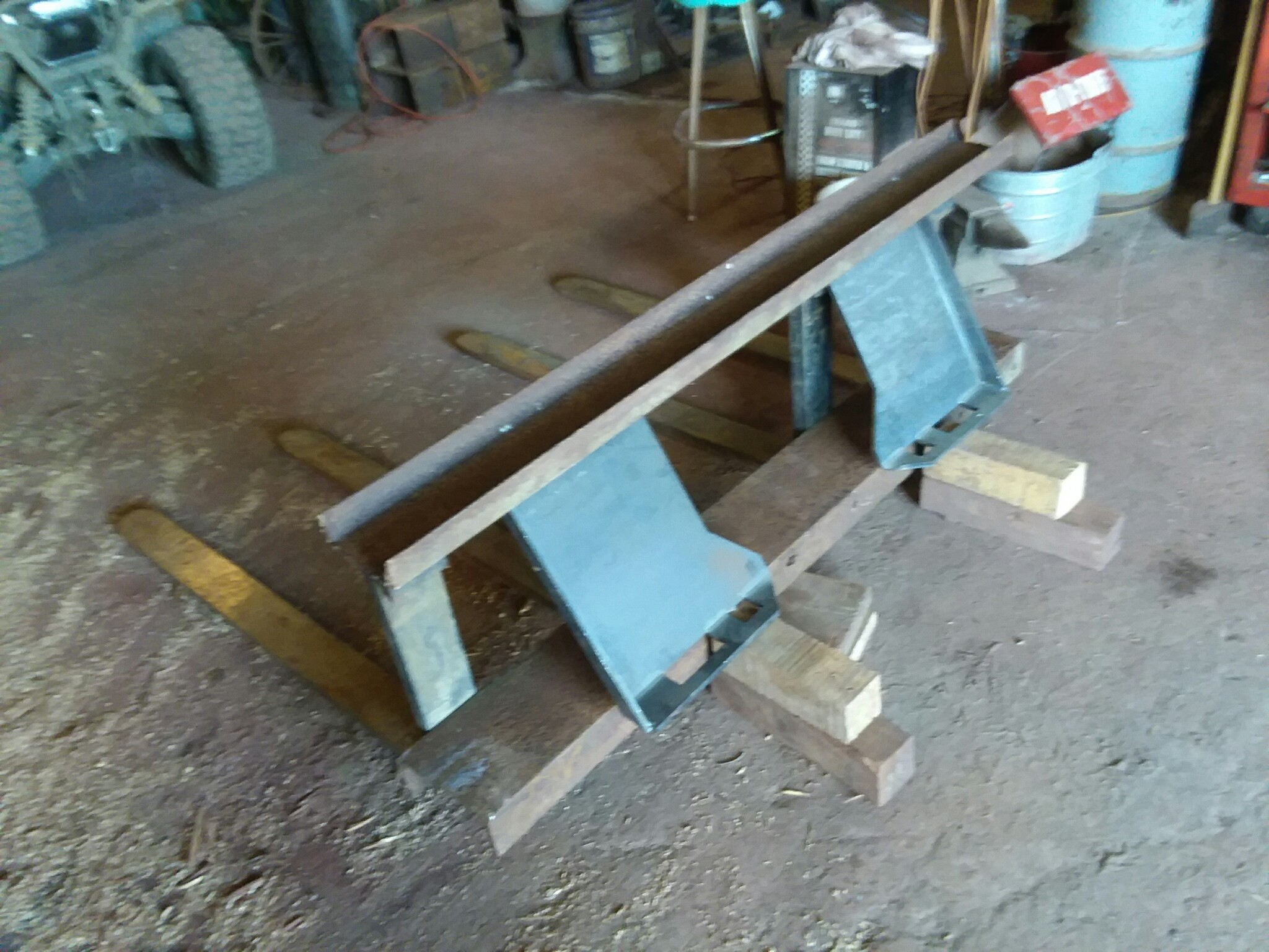

Debris forks being built by neighbor/friend should help in land cleanup work with L45. I found two separate sets of 48” forks for sale.
I’ll use these on brush, branches, logs, and stumps already dug out. I see burn piles in my future where I need to clear unwanted trees in an area for more horse pasture.
Will leave the nicest trees for shade though.
