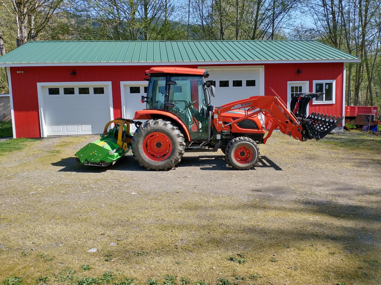

Going out to mow with the new flail (first mowing- lots of wood debris, which is why the grapple):
NOTE: Not shown is the damage to a small pole shed's roof I managed to inflict from the grapple. Was dodging a tree branch and couldn't see the corner of the shed. EA "Wicked" grapple took on another meaning! I was glad to get the grapple off (done with first mowing). ALWAYS use caution when working around buildings and fencing!
