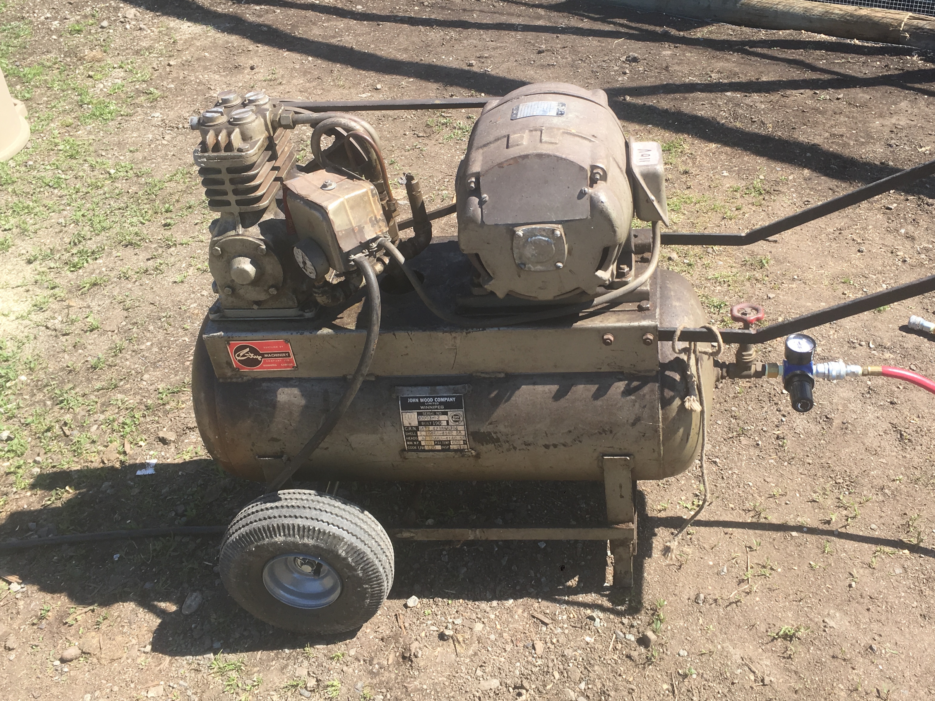

I like old stuff, especially when it still works well and serves its original purpose. I bought this a couple of years ago for next to nothing from a guy whose grandfather had it from new. I questioned why he would sell it, I would have considered it a family heirloom, but he just shrugged and took my money.
It weighs a frikkin ton, but I still use it around the property, albeit on a new axle and pneumatic wheels.

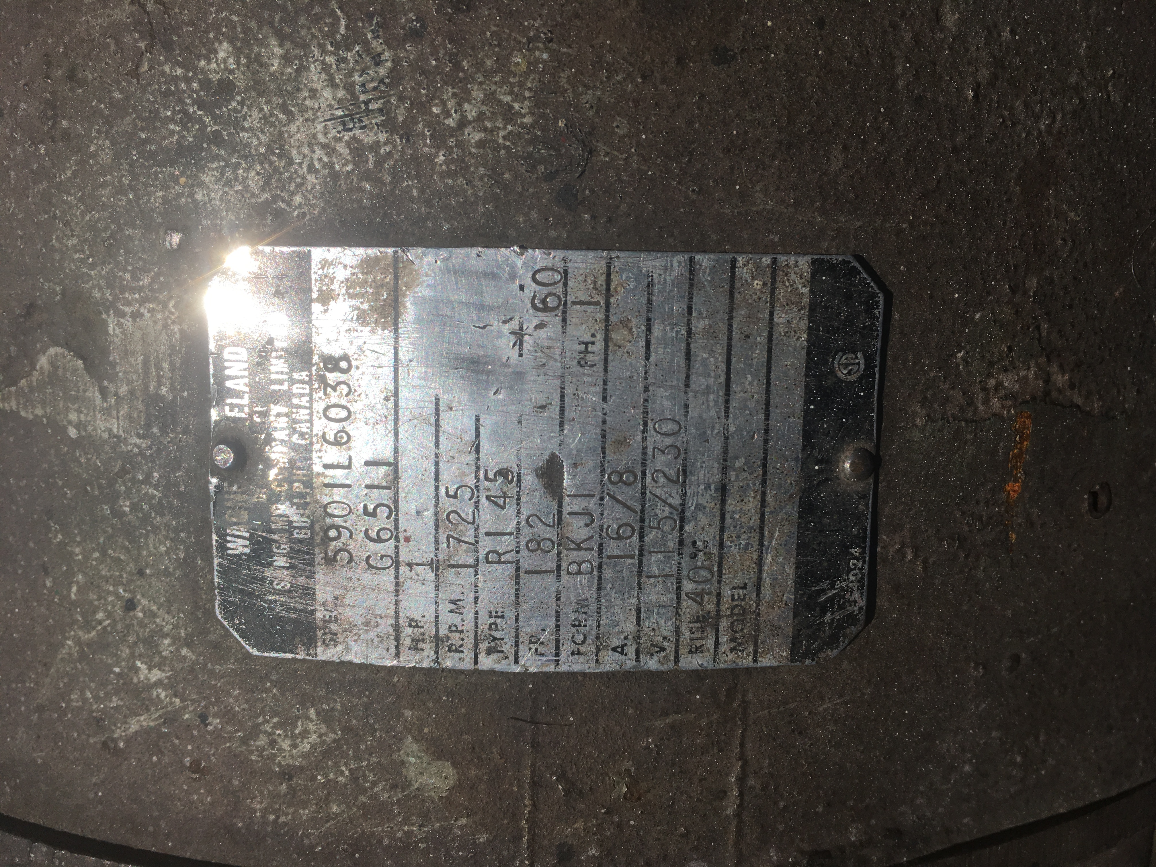

I have it wired 110, but that creates an issue with electrical outlets. At that voltage, it draws 16 amps, and there aren't very many 20 amp outlets around my place.

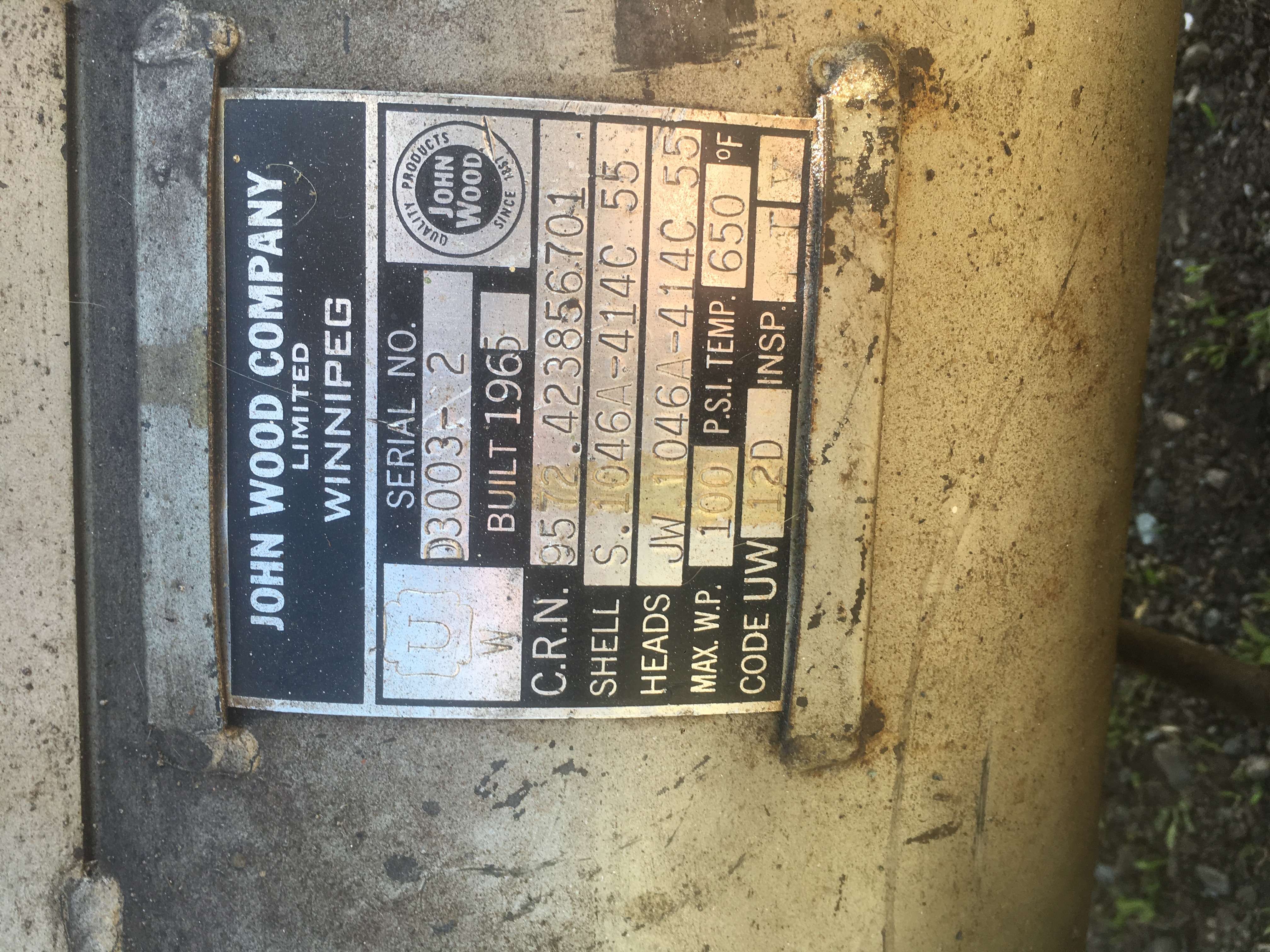

The unit itself and motor still have readable tags as shown, but I don't know much about the compressor, the only markings I can see are "2107" on the top. Anybody know more?
   / My old compressor #3
The tank seems to have been made in 1965. They have an inspection cycle (or take out of use) of 10 years. I see that you are using it so it's still working. I suggest you keep an eye on it for rust and be sure to keep the tank drained. I had one I used beyond it's 10 year inspection and it eventually failed while I was in the shop. No one was hurt and no shrapnel, but all the light things like paper and dust got stired up all of a sudden. To say I was startled would be an understatement.
