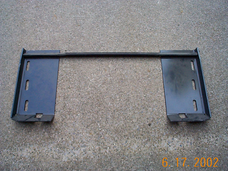

Spence why are you buying attach plates?
Heck you can make your own and chances are most likely they will be stronger and much more better than the production ones cause you're not going to be obsessed with cutting corners.
I made the set up for my back hoe thingy and I've hooked it up to Bobcat without a problem. Monday I'm going to attach it to a Case 1845C and I'm sure there will not be a problem.
It isn't magic. It's just a set of measurements. Do it!

Harv, we were just about to leave today to go to the in-laws so I didn't have much time to write. What I mean't was that I thought you probably made your own quick-tach plates, not a personnel lift. I was wondering what type and thickness of metal you used? If I made on it would be attached between the 2 levels to the 2" square tubing on the 60" side of the lift. It looks like the top and bottom of these quick-tach plates are at a 45 degree angle and I wondered what method you thought would be best for fabricating that.

I personnally think that the uin-hitch is the way to go. You can fabricate your own attach plate for the "cage" .

Thanks again for the tip on the Bobcat quick-tach plates. I did find a dealer and picked one up today. The cost was 78 plus tax. I wish I had known I could get one for that kind of money before I started the project. I guess I should bounce all my ideas off you guys before I act on them. The Bobcat plate will have to be modified a little bit. The square holes for the locking pins will have to be enlarged to accomodate the spacing of the pins on my Kasco Uni-Hitch.
Here is a pic of the Bobcat Quick-Tach plate.
