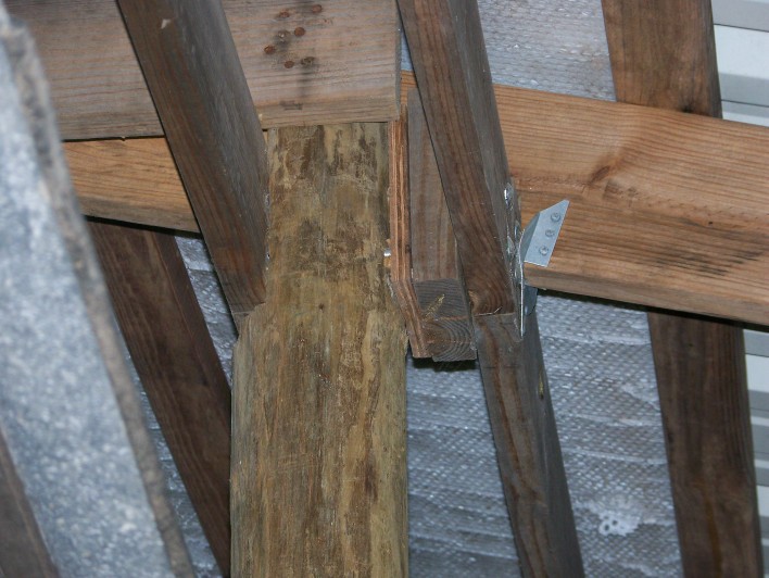

Barn door to you.;) Work of "pinafore" art to me.:D Believe me, I had fits when I found out my plumb poles sighted 6 foot off the ground could be warped 2-3 inches (and more) at the top of the joists. Next pole barn will be 6x6 inch square milled poles . More expensive, but will help you keep your sanity.;)

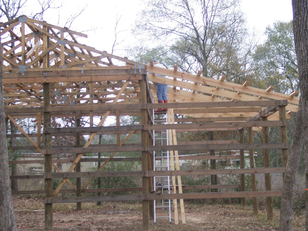

I had a couple of poles that really had a warped curve.:mur: I had to dig two up, concrete and all, and push them over with my old Ford 3055 then reconcrete.:tractor: I got the close one plumb at the top, but the bad one had to have shims and notched.:mur::mur: This was all to the right of me in the third photo. Yes, I am wearing red rubber boots.
You can also see in the third photo the pole that was really curved and is the one I pushed over, then shimmed and notched. It is the third pole back on the right. Notice how it leans in real bad.
hugs, Brandi
