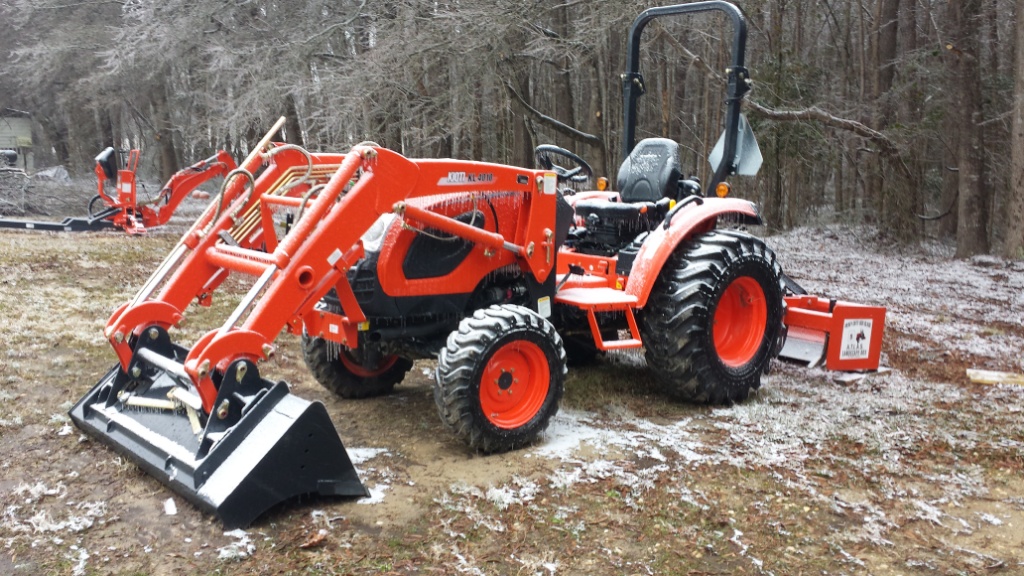

Not to highjack the thread but in a similar thought. I had no intention of starting my machine during recent ice storm here in NC but had several trees acrros the road and my chainsaw died. So I decided to use the loader to push them out of the way. I actually read this thread after seeing this....
I really need to get a shed....
Or at least a tarp.
