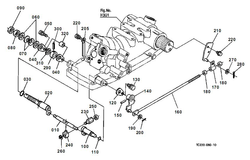

Canoeptr, you said in an earlier post that the function is simple. Looking at the second video, I can see the control handle progresses upward (does not return to center to stop movement)....are there sliding friction disks in the linkage that the feedback linkage causes to slip? Does item 250 attach to the valve?
I tried to do an attachment of a L2800 parts page.

Hey EE_Bota, thanks for your continued help with this. I'm not up to speed on the nuances of the feed back levers mechanics, just the basics as canoetrpr outlined.
I did a quick compare between the L3010 "feed back lever" and the L2800 "feed back lever" and it looks like all the part numbers match up except for the actual feed back rod. I didn't check every number but the little parts like #250 that I did check (at least half at random) all have the same part numbers.
What does it all mean? What do all those little parts do other than seem to make the PCV lever stick and difficult to move smoothly?
I'm pretty sure #250 is the part that connects to the valve but I don't have my WSM or tractor at the moment so I can't take a closer look.

Hi EE_bota. I don't know what a sliding friction disk is unfortunately. Not quite sure how to get my printer to scan. I think it has the functionality so I will take shot at it soon and try to scan in the page from the service manual that explains the workings of the position control valve.
I'll try to describe but its bound not to do much good.
- The position control lever turns a shaft which is connected to the a control on the valve which causes the valve to open thus moving the hitch.
- The feedback linkage from the hitch arms is also connected to the same control on the valve and as the hitch moves into position, the feedback linkage arm closes the control on the valve which causes the valve to close.
- The delta between the position of the position control lever and the feedback arm is what causes the valve to open. Once the hitch moves (or drops) because a delta is created by moving the position control, the feedback lever moves into place to close the delta.
It is all a simple mechanical feedback mechanism. No rocket science to it whatsoever.
