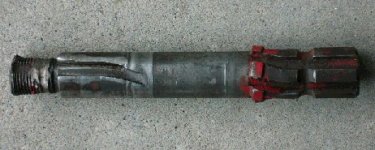

Every nut, bolt and bearing was replaced, as they were all rusted to bits, the bearings making loud grinding noises when I first aquired the mower! /forums/images/graemlins/shocked.gif Also the mainshaft which the flywheel and PTO attatch to had to be relaced after a...err....umm...."altercation" with a 140hp NH. It was the only tractor avaliable to use at the time and seeing as we were doing silage it seemd like an ideal time to test her out. Unfortunately our NH's don't have 'soft-start' PTO's and the mainshaft was twisted almost a full 180 degrees round. I'll get some pics tomorrow, the shaft is still at work.

Heres a pic of the twisted shaft. The keyway you can see on the left, should actually be on the otherside of the shaft! /forums/images/graemlins/shocked.gif

</font><font color="blue" class="small">( Unfortunately our NH's don't have 'soft-start' PTO's )</font>
So true! /forums/images/graemlins/crazy.gif So many of us compact tractor owners with much less horsepower have popped lots of shear bolts before we learned to feather the the PTO engagement at low rpm. /forums/images/graemlins/blush.gif
