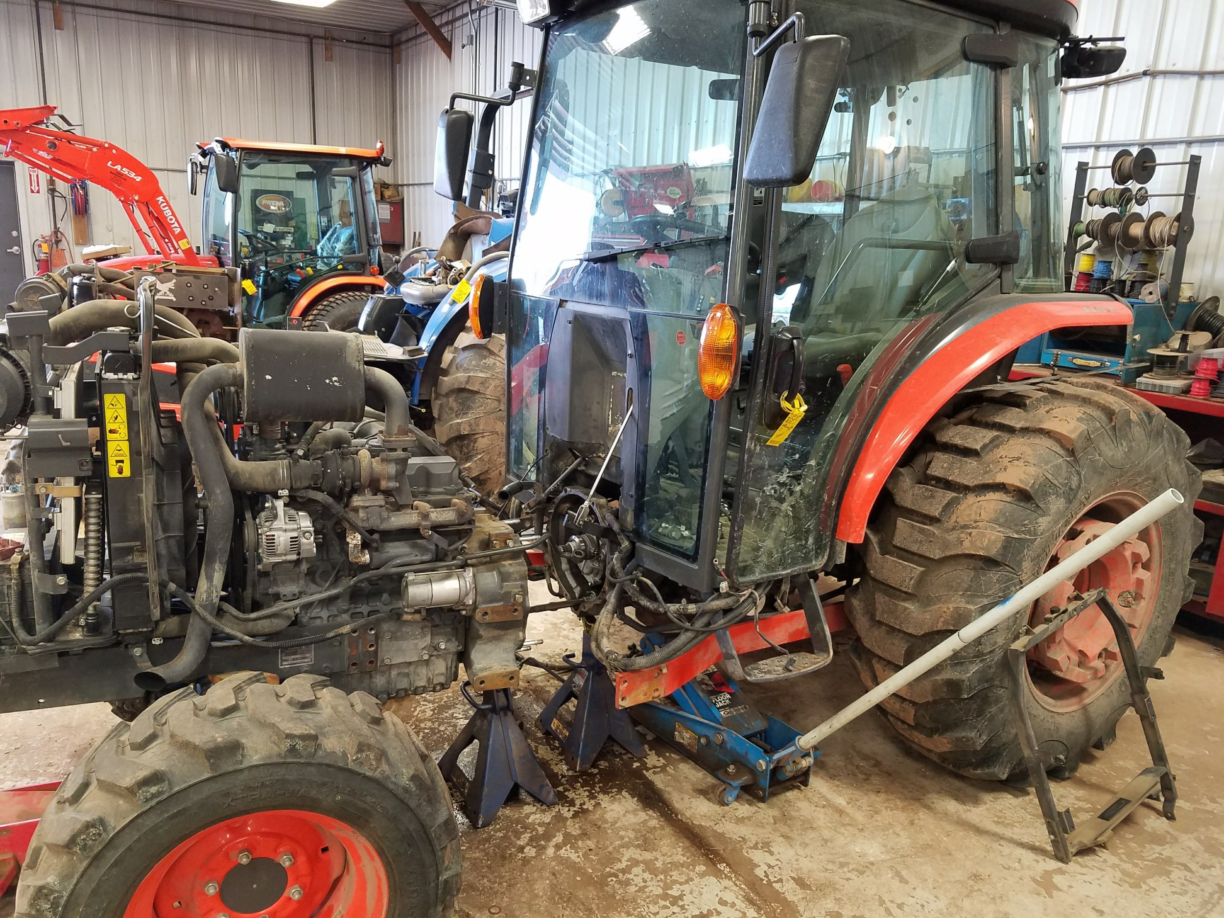

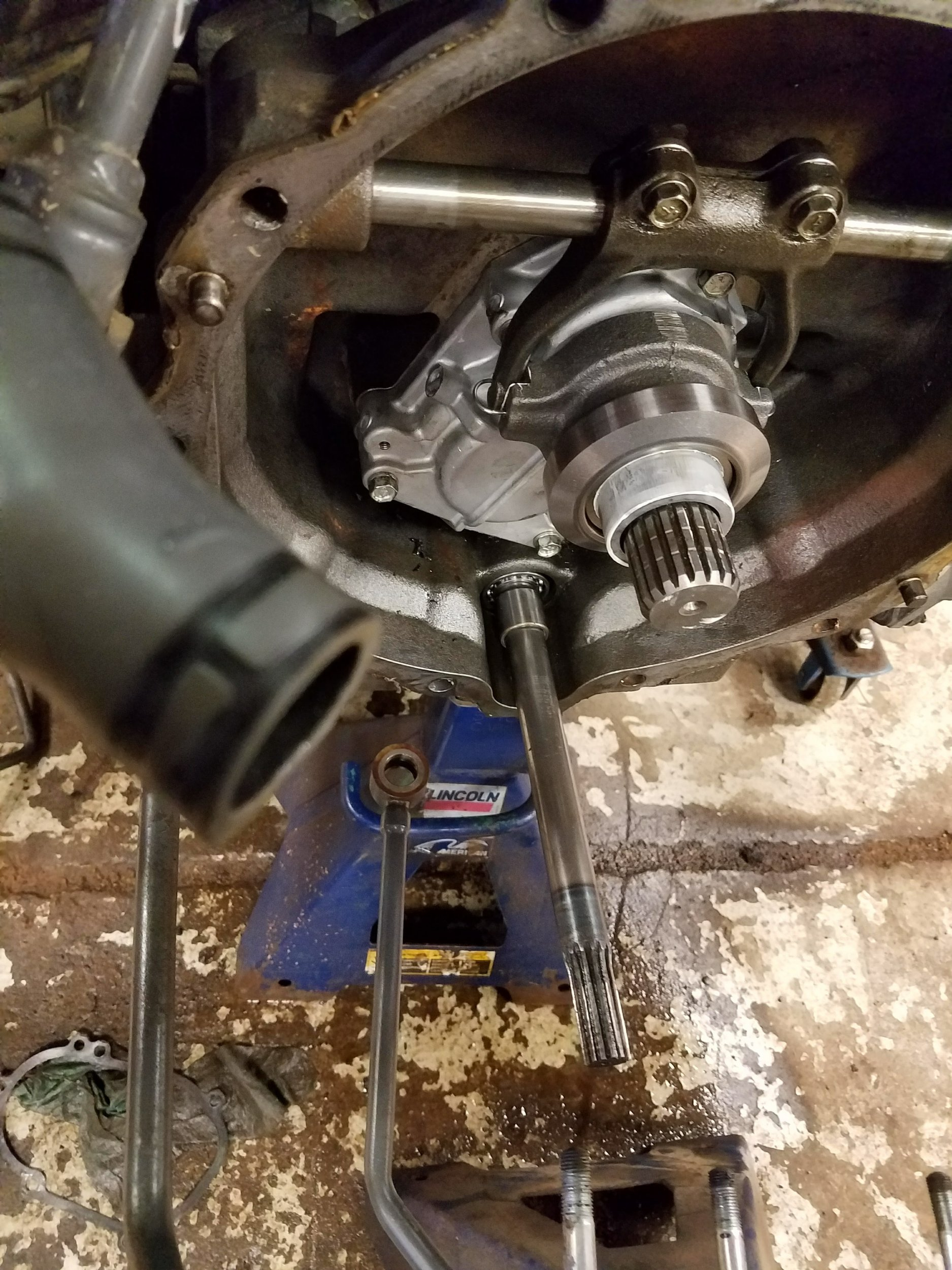

Pictures I took at my dealership when I brought my L5740 in to have the leaking FWD shaft seal replaced. These pics are of another customer's L5740 in for the same repair. Overall shot showing the split. Second picture shows the shaft and the seal with the problem - and why the tractor needs to be split to get at the seal. In my younger days I would have tackled the job but there are so many things that can go wrong and I am a lot more clumsy in my old age. Can visualize dropping one of the halves to the floor during the split not having overhead hoists to lift, but dealer mechanics used 2 floor jacks to move, then stands for added support once separated.
The pics are very helpful. Took mine to a dealer today and dropped it off. I wish I had a shop with concrete floor that I could pull it into, but I don't. Not sure yet what the damages will be . . .
