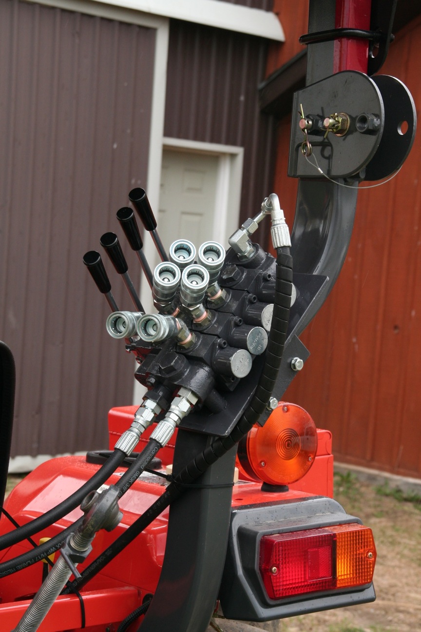

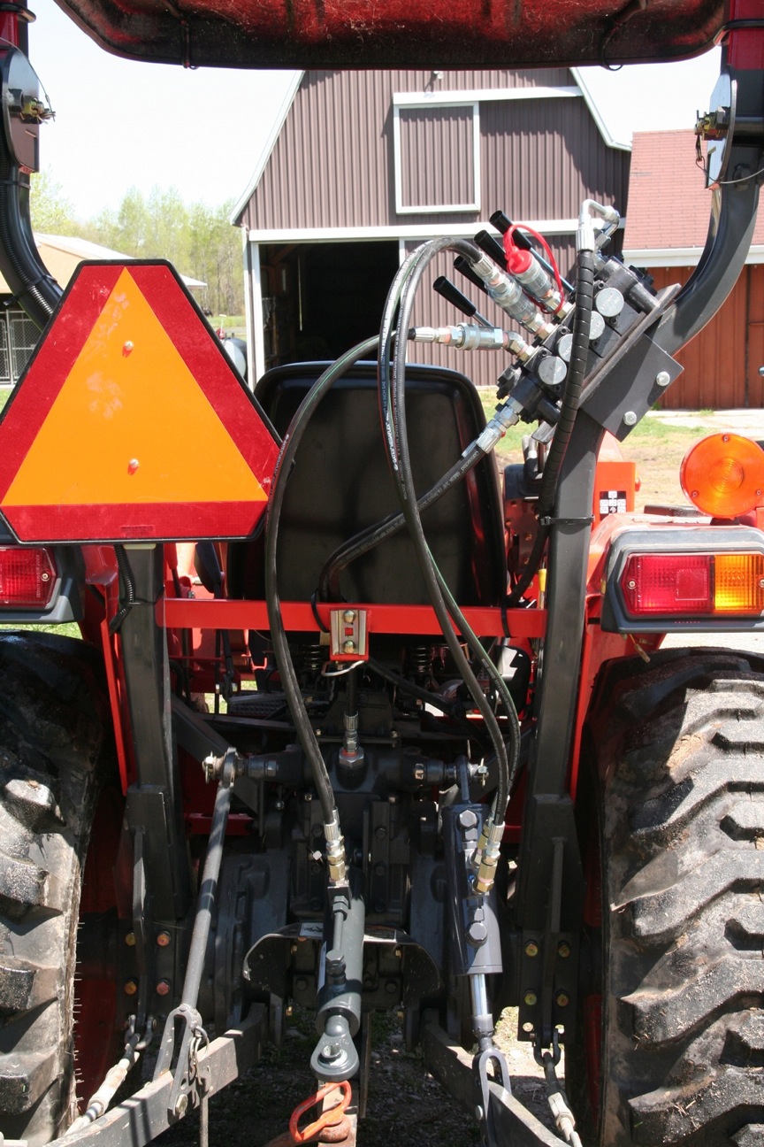

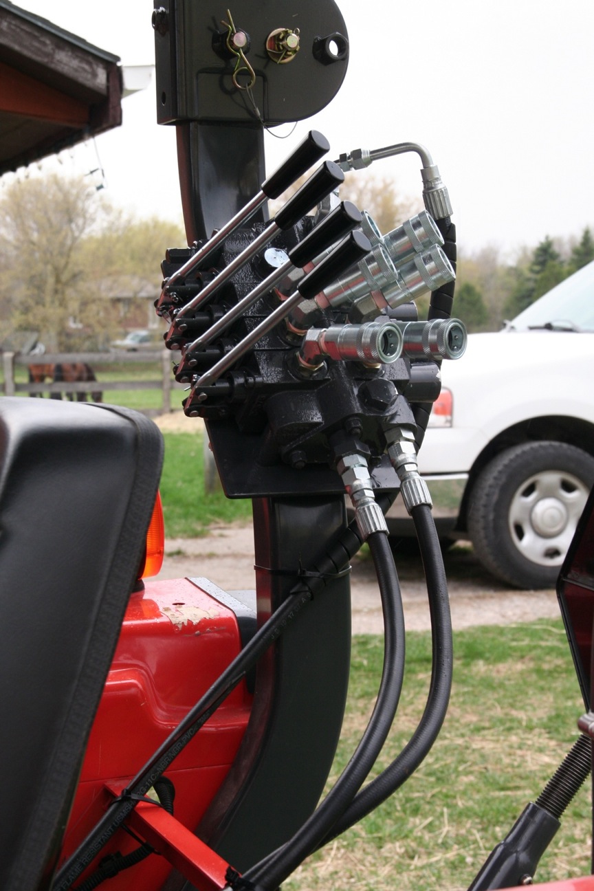

After much research, and a LOT of help from many of you at TBN, I've successfully installed a 4 spool valve and TnT cylinders from CCM.
For starters, let me again than the many of those who have helped me with this, including but not limited to: MadReferee, wushaw, WayneCountyHose, Kenndy and last but not least StrangeRanger who did the exact same install at the same time as me and who I was able to bounce many an idea by (and shamelessly steal many from!).
Details:
- I decided upon a 4 spool stackable Prince SV valve from Surplus Center that many here including MadReferee has used. The valve is nearly identical looking to the 'factory' remote setup that Kubota has for the B series and and standard L series. It is about 1/3 the price. It requires that you come up with your own way to mount it however - which is the own down side IMHO vs. the Kubota setup.
- Mounting cleanly is probably the biggest challenge. I don't weld - wish I did. StrangeRanger came up with the idea for mounting bracket. I copied his exactly - got a local welder to do it for me out of -1/4" steel. He charged me $100 total. I'm very happy with the mount.
- Got the TnT cylinders from Mark Carter at CCM. I'm very happy with them. Mark is a great guy. One suggestion to others that order TnT cylinders. Get a picture of your side link and measure carefully. Some side links (like the one on the L3400) has a 15 degree angle at the clevis. Others (I saw a M5000) at a dealers had no angle. Be careful to note this when you order from CCM.
- WayneCountyHose suggested that I find a local hydraulic shop to help me out with fittings and hoses. That was great advice. The hydraulic shop here was fantastic and a guy there spent a lot of time with me getting the right fittings. It was a lot more expensive than getting premade hoses or ordering fittings on the internet, but it was well worth it for me.
- I picked up Pioneer QD fittings at the local Princess Auto. Could not justify the extra $ for those at the hydraulic shop (they were 3 to 4 x more expensive for the QDs they had there). StrangeRanger did not get QDs for his TnT spools as he didn't see himself taking them off. I pondered whether I should or not but since I got a good deal ($18 each) I did and I'm really happy I did because I realised that the little top link holder bracket on the tractor will no longer hold my new top link :) so I just had to take my top link off as I was out harrowing and only used the drawbar.

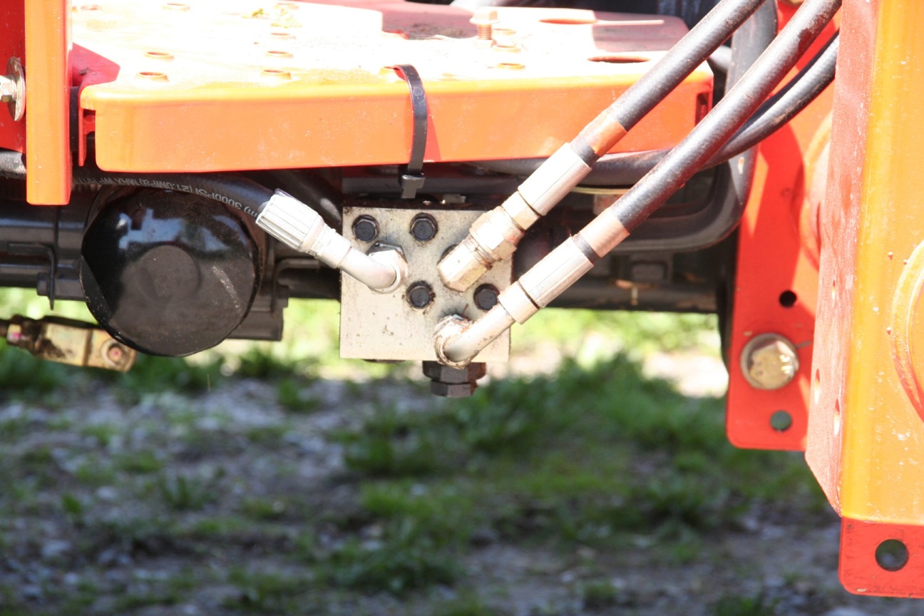

- Hooking up the plumbing to the remote was straightforward. The three hoses I got for that (loader PB port to remote IN, remote OUT to tank, remote PB to tractor hydraulic block) were 3/8" and terminated with JIC -8 female swivel fittings.
- MadReferee had pointed out to me a couple years ago when I first posted for advice that he used 1/4" hoses for the TnT cylinders to limit the flow so that they could be feathered. This was a brilliant idea. I can adjust the cylinders ever so slightly. I got 1/4" hoses. They were terminated with 3/8" NTP male (as one end of each was getting a 3/8 QA on it). All my QD are 3/8" - just the hoses to the cylinders are 1/4".
- I had to think through some details like how am I going to be able to access the QD's on the valve since the ports are so close. I used an ORB 8 to NTP 3/8" and a 45 degree NTP 3/8" female by male on each of the work ports and then put my 3/8" QDs on each work port.
- For the newbie, when you are tightening fittings, think about which ones would be easier to do first. If you've got two fittings that are close, chance are it will be easier to do a particular one before the other. Obvious stuff but I missed it a couple of times.
- I used a Kubota provided tank port plug and o ring for the return to tank hose from the valve. If I were to do it again, I would follow MadRefree's method and tee the tank inlet from the loader at the hydraulic block instead. Doing it the way I did (the factory valve does it this way) just makes it a bit of a hassle when you have to top of hydraulic fluid as you need to undo the tank hose.
I've posted some pictures of my installation. I should point out that I was pretty mechanically inept (and generally un-handy) when I came to TBN. I've been helped by those of you who generously give your time here to do way more than I ever imagined - starting with a 50 hr service to now installing my own remotes and TnT cylinders. To anyone else who is consider whether or not to do it themselves or to send it to the dealer - IF I CAN DO IT...... BELIEVE ME YOU CAN!.
Cost breakdown is as follows. Note that these prices include shipping to Canada, taxes, and UPS brokerage fees.
- Prince 4 spool valve = $400.
- CCM TnT cylinders = $565
- Hoses and fittings + plastic ties + teflon tape = $448.58
- 6 sets of QD (male and female) = 108
- 2 ORB 8 steel plugs (I didn't put QD on one work section) = $4
Total = $1525.58
If you are in the USA then I imagine you can easily take $200 to $250 off that given you won't have to pay brokerage fees to UPS, your shipping will be slightly cheaper and you taxes lower.
I should point out that what I spent in total is not far from quotes I have gotten from dealers for a 3 spool remote setup (aftermarket) once you throw in paying them to haul the tractor to and from the dealership.... so I think I did pretty well as I got an extra spool and the cylinders for that price.

Realised that I left a couple things out of my cost breakdown. Here is the revised one:
- Kubota port plug and oring for return to tank = $45
- Kubota grey ROPS paint = $20
- Mounting bracket = $100
Total = $1690.58

afish - no questions are silly.
The work sections I got are SVW1BA1 - Dual Acting cylinders spring centered. For the vast majority of what a CUT owner will do with rear remotes this is what they need.
I have 4 spools (thus the 4 levers). Since I have no plan to use the 4th (bought the extra spool anyway as it was only an additional $56), I just put steel plugs on the work ports. Plugs are much cheaper than fittings and QDs ($4 for two). Will add the fittings and QDs if I ever need to use that spool.
Three rear remotes are generally plenty - two for TnT and one spare for whatever else, but more never hurt :).
One of the reasons I did not spring for the 'factory' setup is that it is nearly identical in cleanliness of the install to what I got aftermarket but for a higher price. This statement is specific to the B series and the standard L series. The factory setup on the Grand L series is definately nicer and I believe uses hard lines to get the flow from the valve to bulkhead fittings on the rear.
If I were in your position and getting a brand new Grand L (wish I was!), I would get the dealer to work it in as part of the deal. A dealer should be able to give you a decent price on remotes since they are setting up the machine for you anyway.
Feel free to ask any questions you might have about hydraulics. I am a noob just like you to it but will do my best to answer.
