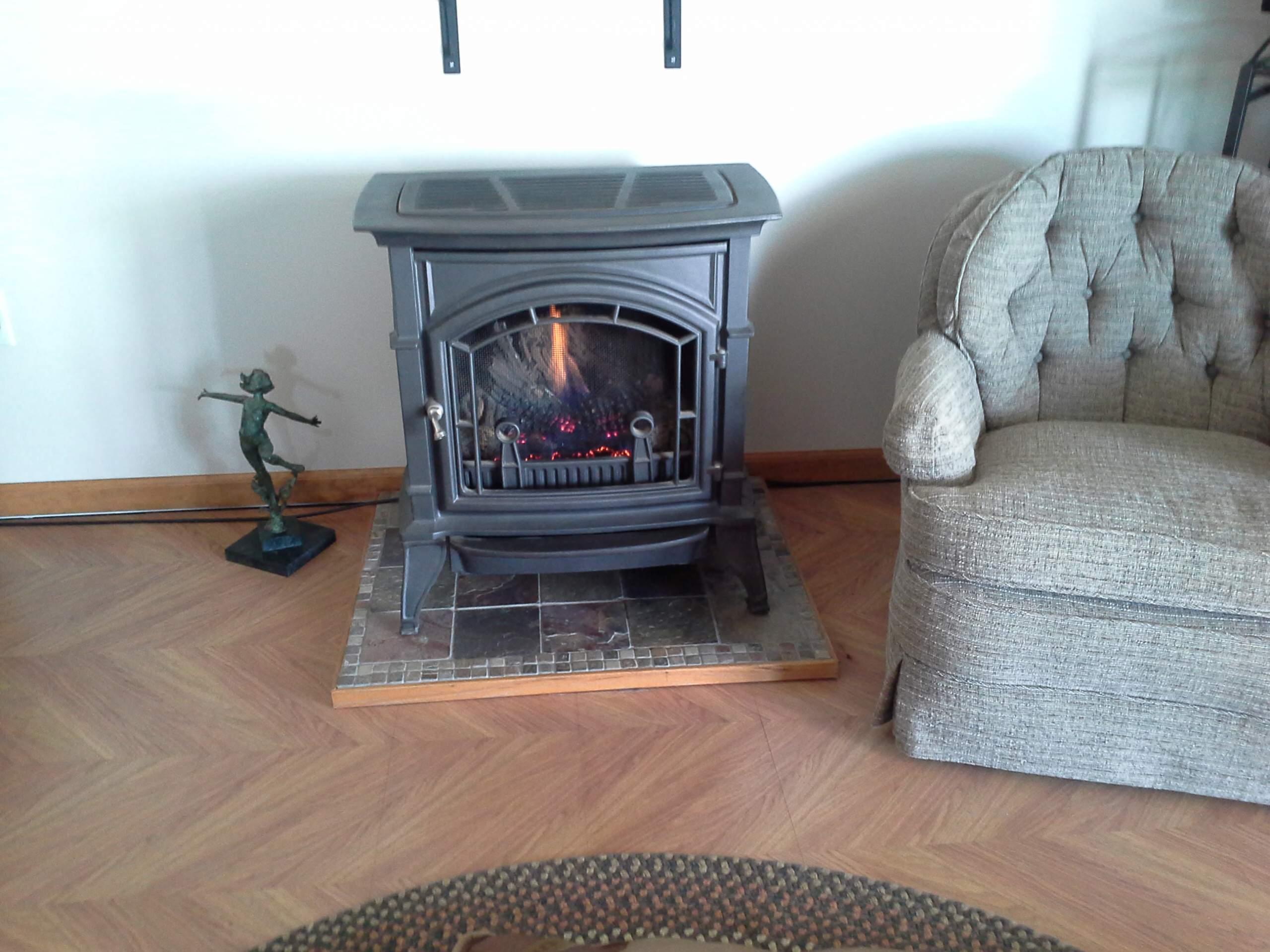

A covered porch or deck would be in my needs list. I love being on a covered porch in the rain. Doesnt even have to be real big. It could also be used to have a few days supply of fire wood just outside a double french or sliding patio door in the Big room with the fire place.
Now regarding burning wood, I love it as back up heat and ambiance but it is work and messy. I have that in the cabin and wouldnt change it. But at my home, I compromised and got a natural gas cast iron stove with fake logs. Turns on with a click of a button, even has an option for a remote or thermostat. Sure is convenient and clean and it is great to warm up with after being outside in Michigan's cold winters.
