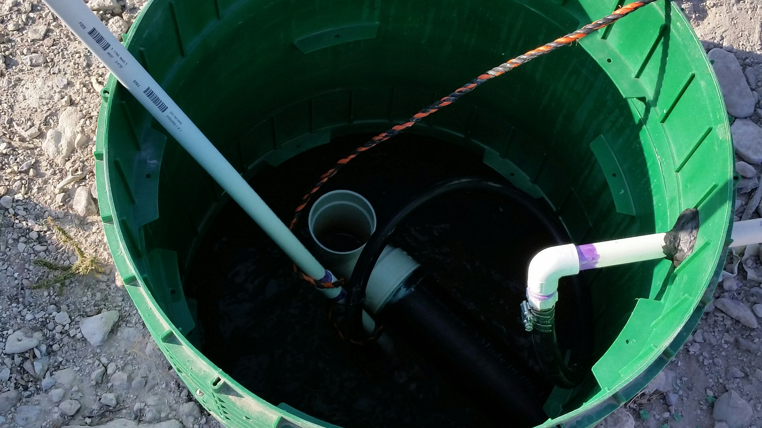

I installed a fine air tube diffuser inside my first chamber in my 2-chamber septic system and ran air to the diffuser 24/7 for the past 6 months. It costs me about $3.00 per month in electricity. It's a new system on a new home.
Here are the results after 1/2 a year of use:
A - The septic tank has NO smell once you open the tank lid. It actually has an "earthy" smell, kind of like soil when wet.
B - There are NO solids in the tank. It's just liquids.
C - The effluent filter in chamber #2, before it heads to the leach field, was very clean. No debris on it, just some slime bacteria.
This proves to me that aerobic systems are way better than anaerobic systems. Studies I read show 10x faster digestion and breakdown of wastes and the effluent is much cleaner as it heads into the leach field. This also helps with the biomat in the leach field. One is less likely to have a failure in the biomat with an aerobic system. In addition, I might never have to pump the tank since the solids (poop & toilet paper) are breaking down so quickly.
My last home had an anaerobic system that smelled really bad when accessed and required pumping every 5 or so years. The methane gas produced by anaerobic breakdown is very caustic to the concrete septic tank. Since the aerobic system has basically no methane gas, the longevity of the concrete tank is indefinite.
I'm now a believer in aerobic septic systems. The entire setup cost me $300 in parts and labor was free (me). :laughing:

My tank is a 2-chamber 2,500 GAL concrete tank (it will eventually serve 2 homes). The leach field consists of the Infiltrator chamber systems. My system is a 100% gravity fed conventional system.
Your system sounds like an "engineered" system that has air injection and grinder pumps. You must be in an area that the soil did not perc good.

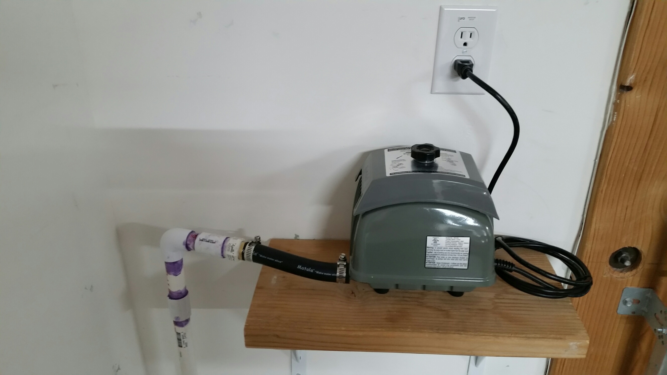

I run a Hakko 40L air pump with a 3/4" PVC pipe that then feeds air to a Matala EPDR rubber air diffuser. The diffuser then sits in the 1st chamber of the tank. It's pretty much the same setup they use in ponds to aerate the water.

I run a Hakko 40L air pump ($180) with a 3/4" PVC pipe that then feeds air to a Matala EPDM rubber air diffuser ($60). The diffuser then sits in the 1st chamber of the tank. It's pretty much the same setup they use in ponds to aerate the water. The other $60 was spent on PVC piping and some rubber weighted air hose. The air pump sits inside the garage so it is protected from the elements. I ran the PVC pipe next to the 4" sewer pipe from the home. That way it is buried and out of sight/protected.
