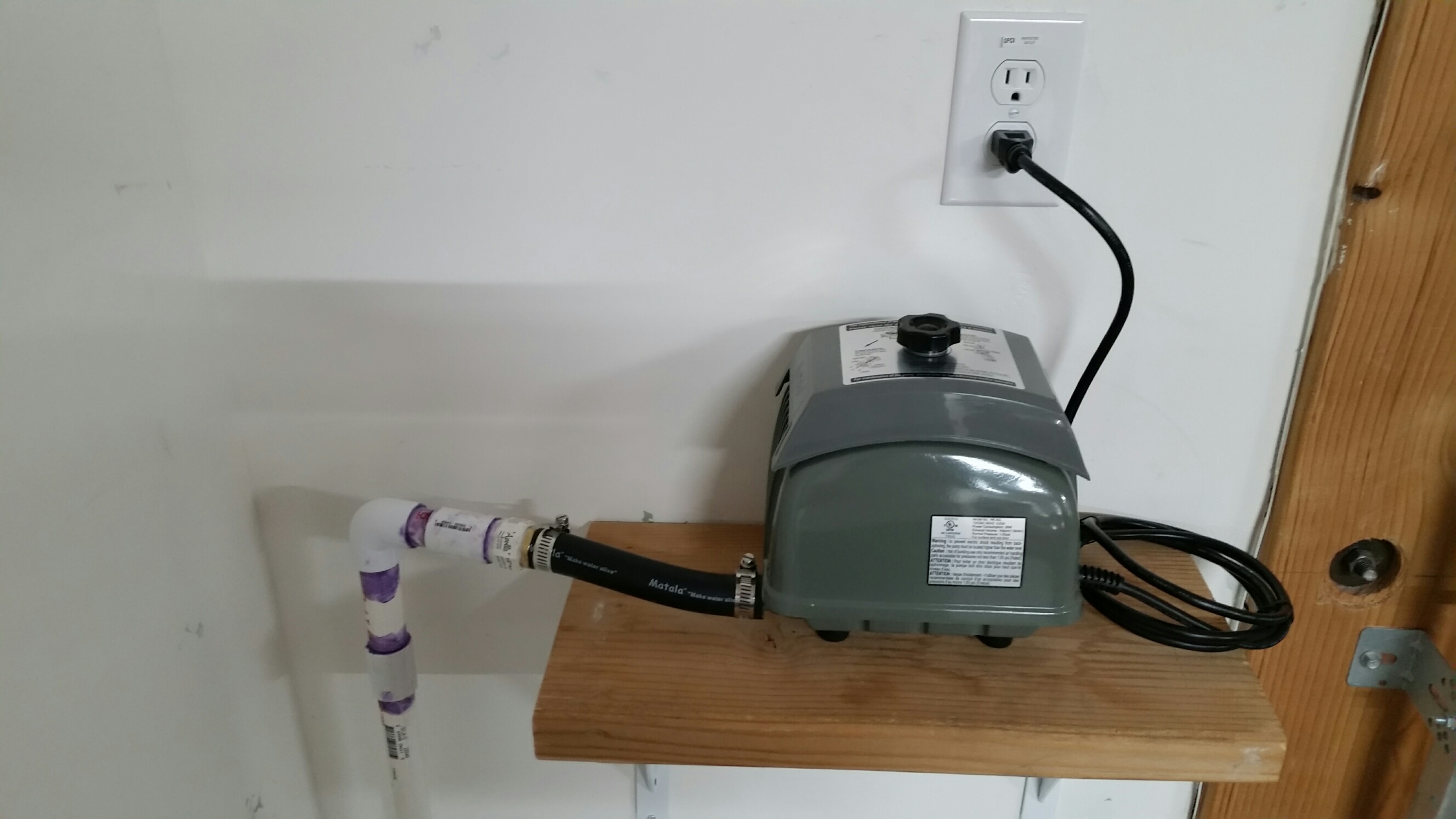

We used to have an aerobic system, but instead of a leech field, it ran out to two sprinkler heads so it watered a fair sized part of the yard. That worked well for us but might not be as good in colder climates up north. Of course you never knew when the sprinklers would come on, it just depended on when the level of water reached a certain point in the last tank. And you never knew which way the water was going to start when it came on, but they were sprinkler heads that gradually rotated. Only once, when I was on my way to the barn, did it come one and catch me full broadside.:laughing: But at least in appearance and smell, it was just clean water.
Yes, I was wondering about up North, where it was 41 below with the wind chill a couple of days ago. If you just need to run an air hose into the tank, I suppose the temperature at the surface doesn't mean much. And if I just use it in my conventional system, the effluent could still go out to the buried eptic field.

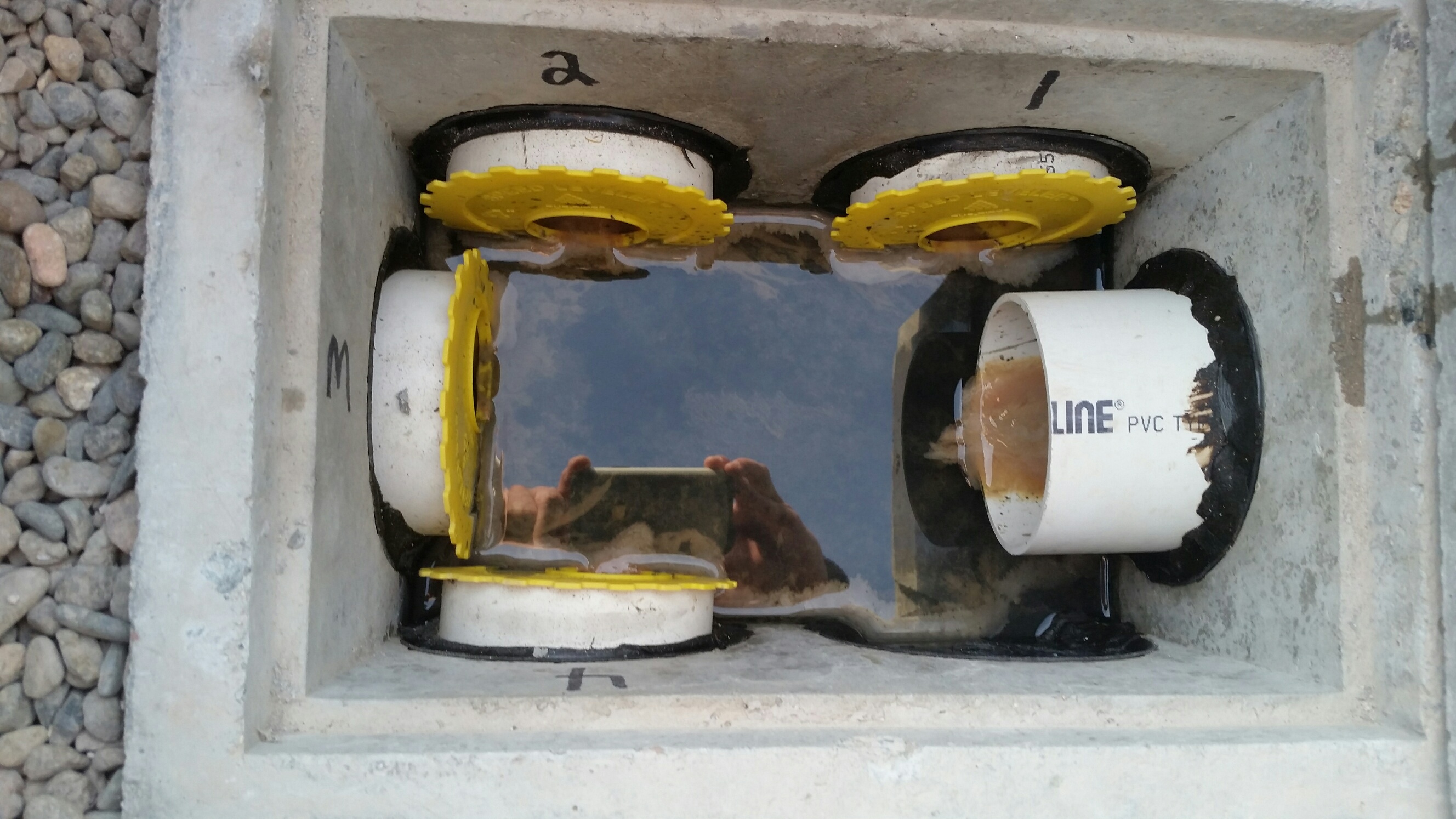

Here is a pic of my D-box. As you can see, the effluent is pretty clear and there is no black bio-mat showing. Just a yellowish slime bacteria on the PVC lines.

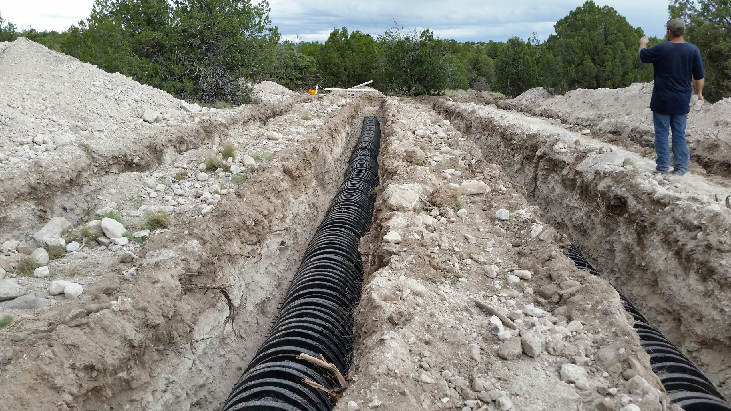

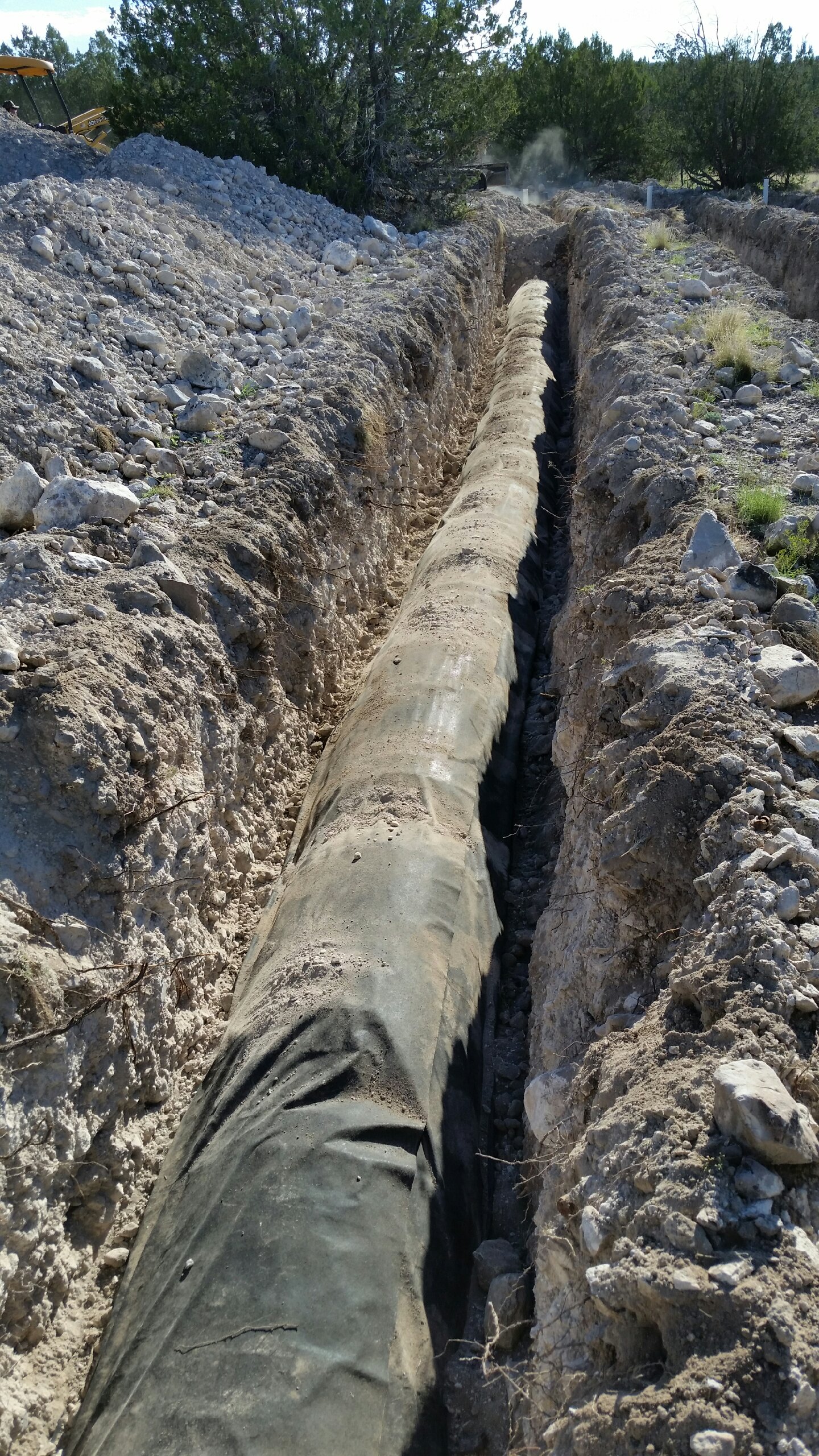

For my leach field I used the chamber systems. I put landscape cloth over the chambers to prevent siltation.
What I noticed is that my installer ran the PVC drain line vertically, from the top into the units, not horizontally. That shouldn't pose an issue, would it?
I don't think it would since the effluent drops in via gravity, either way.
