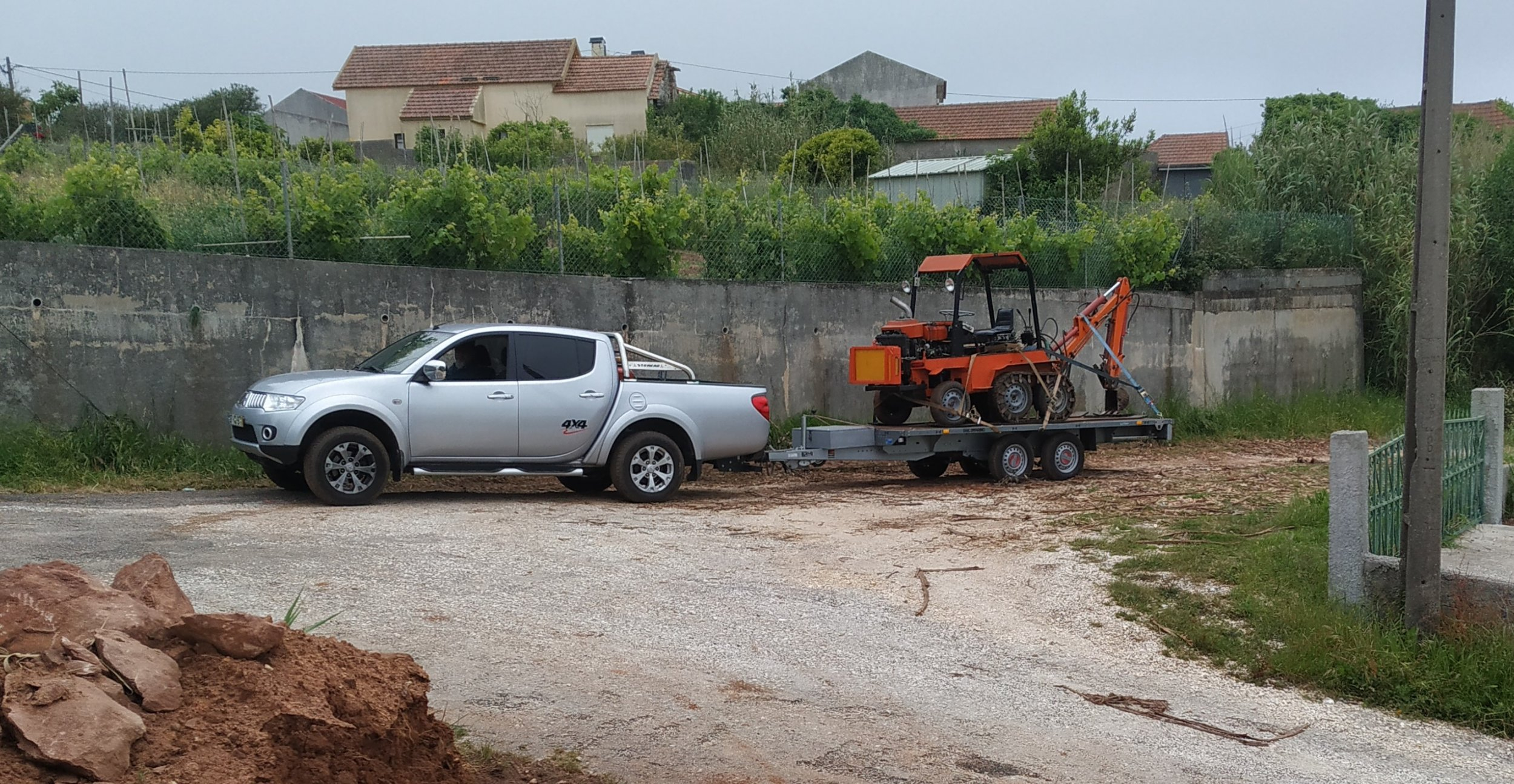

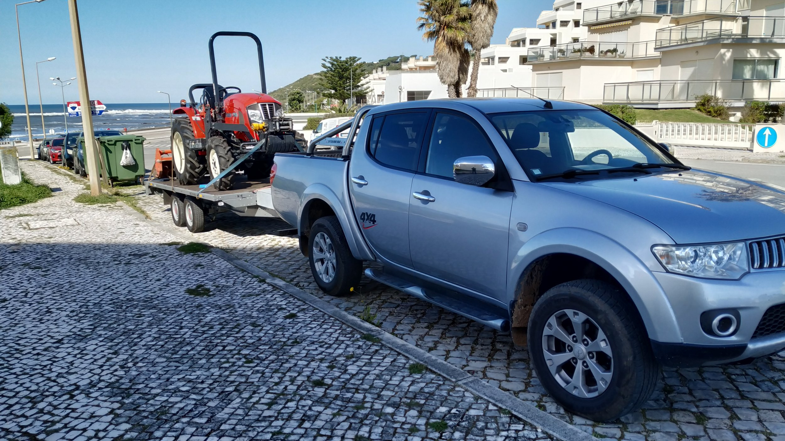

I am wondering, why U guys in USA don’t use trailers with overrun (or inertia) brakes ?
This my trailer is rated GVW 1500 kg, Neto - 1200 kg. And it handles that weight really good. When it comes to breaking there are no issues. Really like that.
