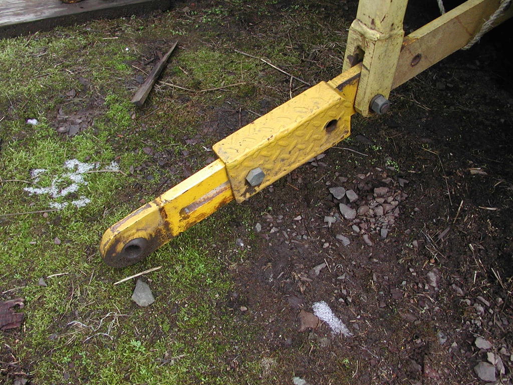

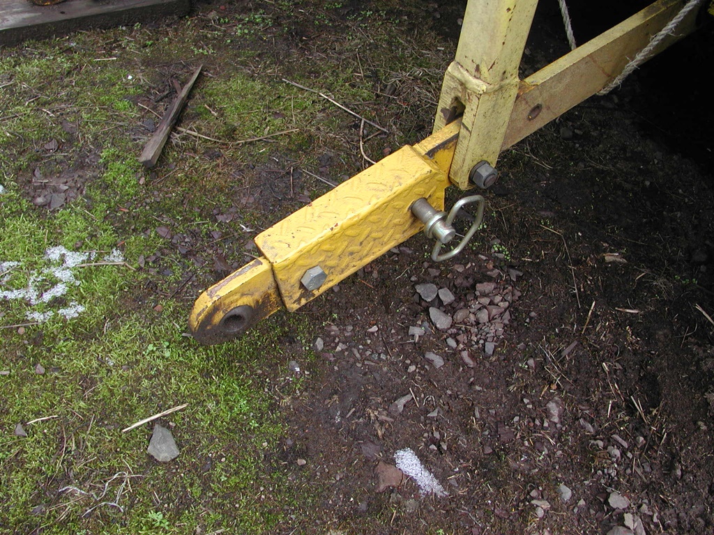

my simple quick hitch
   / my simple quick hitch #11
That's pretty slick, nice job. I modified my lift arms so they telescope, but I think I like your way better. Took me a lot more than three hours too.
Can you show how you did this?
John Deere has some that do this made out of square tube (3020/2640 and others). Due to that that I have considered make new lower arms for my tractor out of 2" receiver hitch tube so they can extend.
   / my simple quick hitch #12
I cut the end off the arm and welded an extension on it with a slot in it. I made the arm into a box with some 1/4 diamond plate I had.
