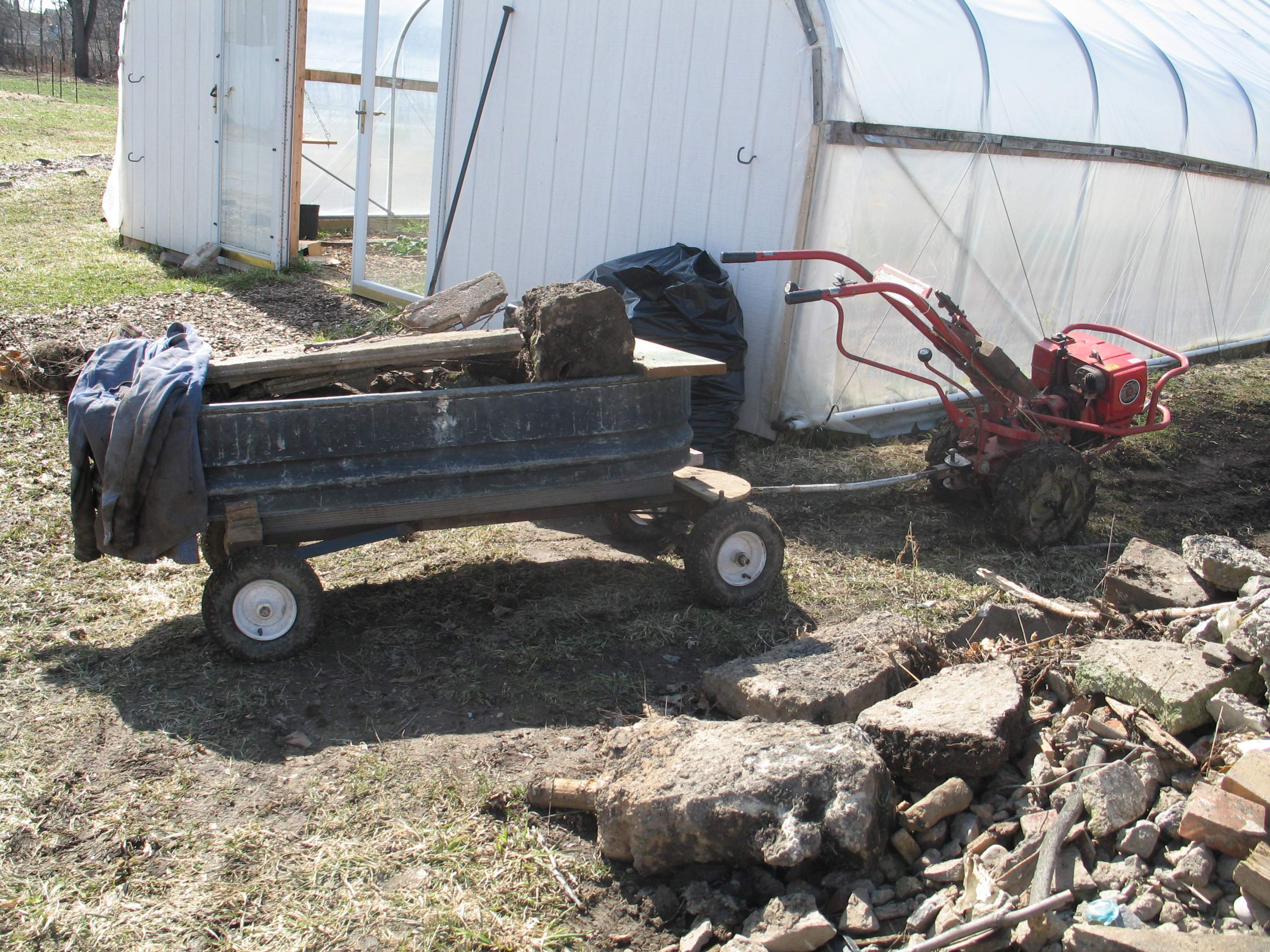

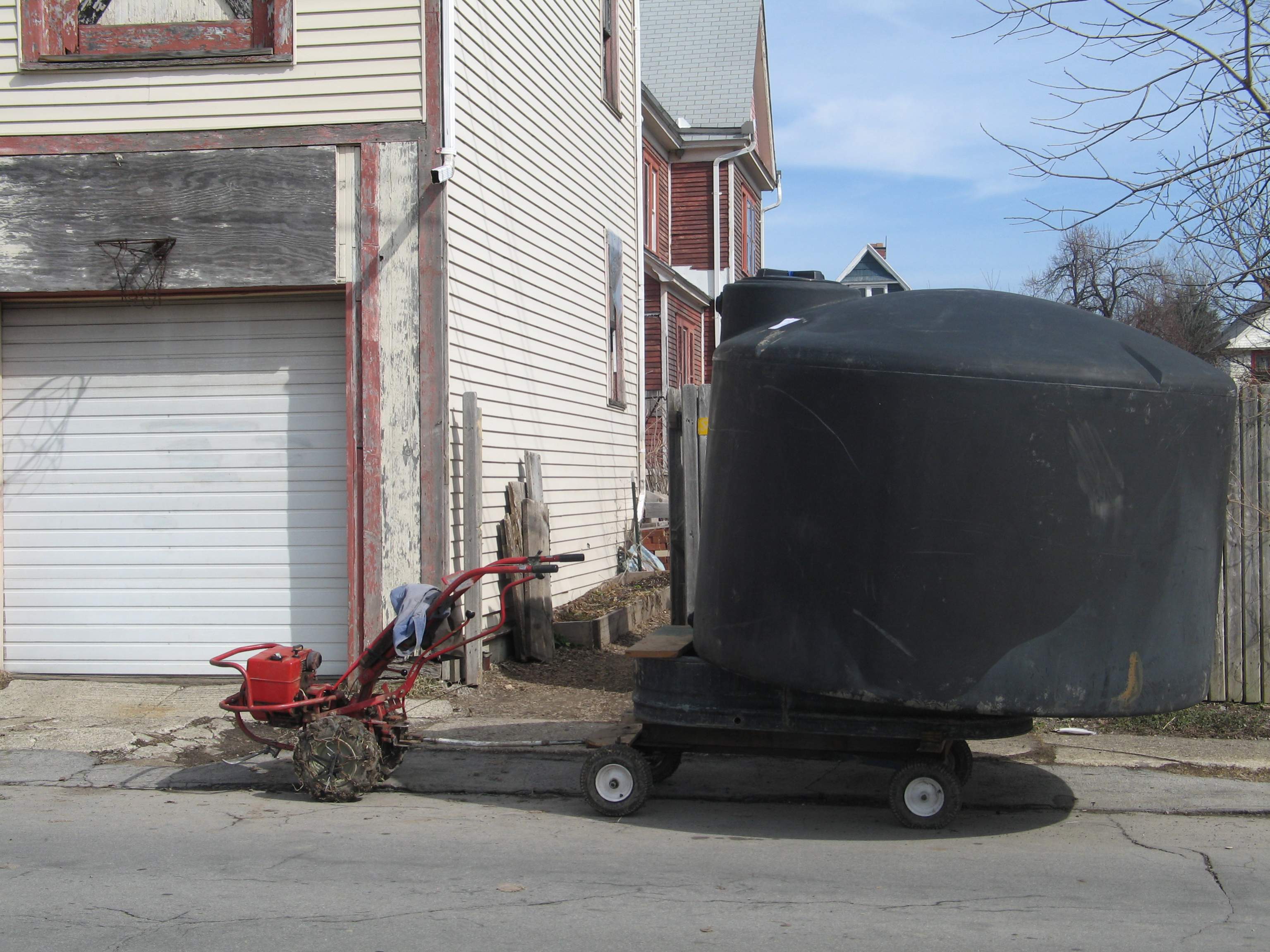

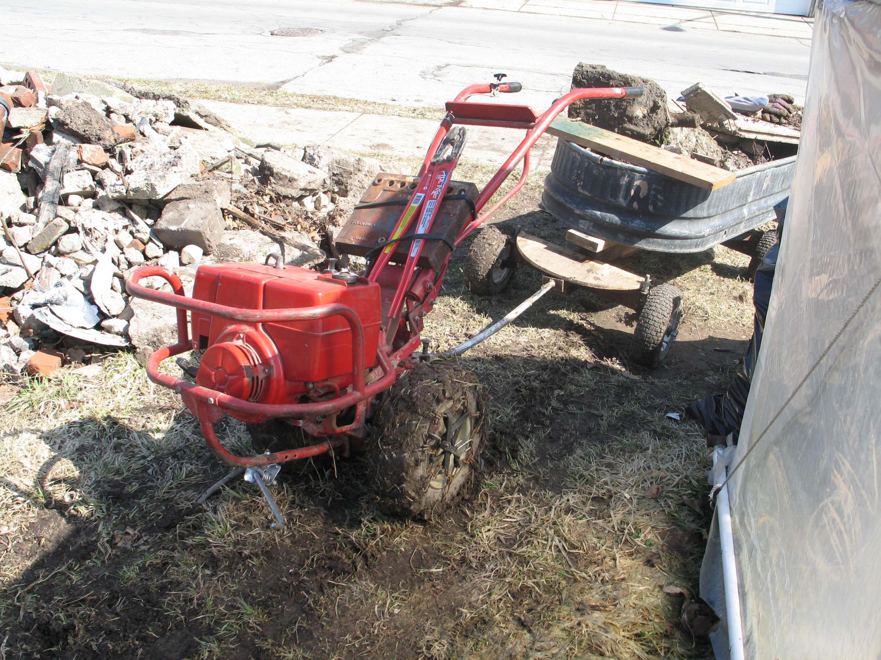

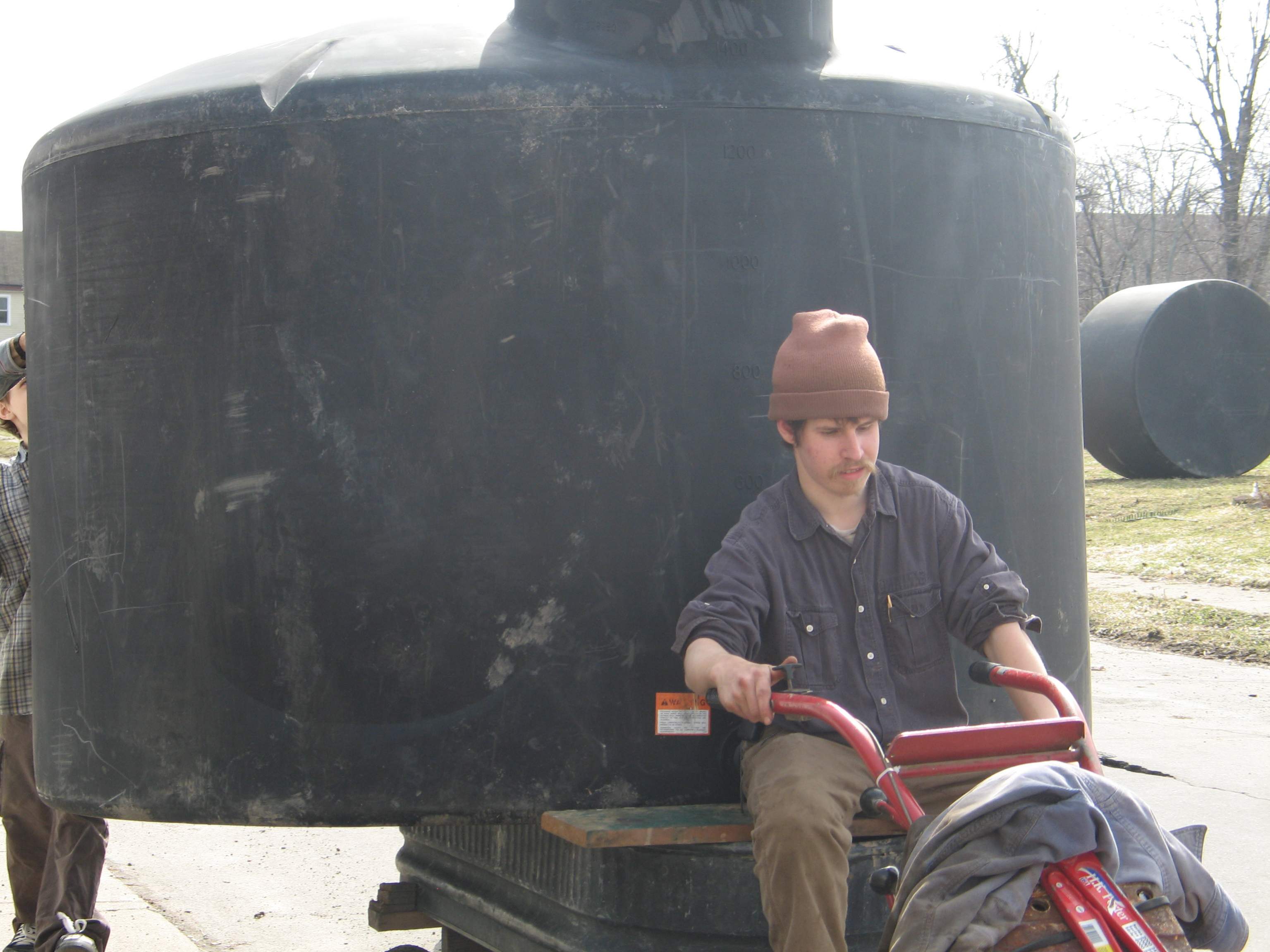

I posted a thread over on another 2 wheel tractor forum and mentioned something about how there was very little 2 wheel tractor forums in the US, someone mentioned this forum so I though I'd post here as well. Was doing some cleanup the other day, picking rocks and garbage out of the field we are turning into garden this year and out of the brush along the field. The first pics are of a heavy load of rocks and concrete and then we got a delivery of 1550 gal. water tanks for collecting rain water so I transported those over to the yard. Max speed on the Troybuilt is about 2 mph but it's easier than using a wheelbarrow and it is also easier to get on and off of than my tractor when picking rocks.
It gets decent traction with chains and a 80 or so pound weight. I would like to eventually put wheels weights on it for added weight.

Neat wagon, good idea to use the old water tank as a box. DO you think a wagon would work better than a single axle trailer? I've got an old boat trailer axle that is just looking for a project:)
/ My Troybuilt two wheel tractor.
No, cause you can load up toward the front on a single axle trailer to give the tractor more traction. I am hoping to make a single axle trailer soon that I can pull with the Troybuilt. I think I'll have much more traction even just with my weight. I actually never have seen people using 4 wheel trailer on a 2 wheel tractor and I assume its because it is harder to maneuver and cause there is no tongue weight to give the tractor traction. I used what I had and it works decent for now.

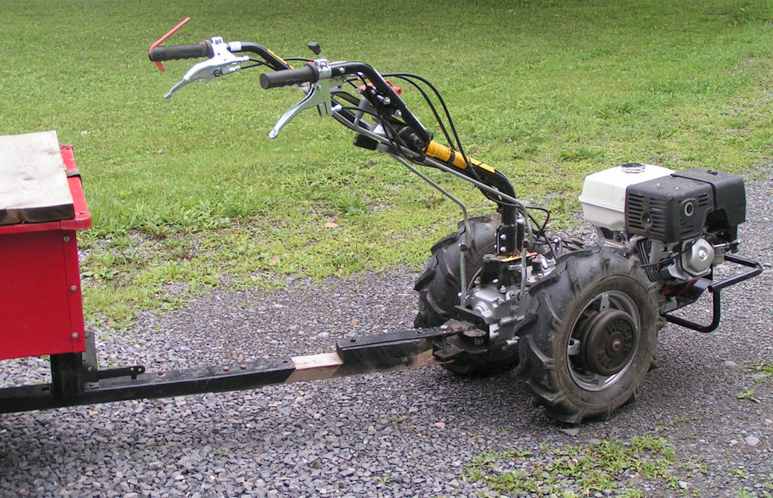

HI! I use for many years a 10 cu ft. garden trailer I make tongue adaptor with 2x4 wood and a piece of 2x10 for seat. Very easy to drive and the trailer dump. I joint a pict Good luck Oldmech

I like it. A simple and easy adaption.
