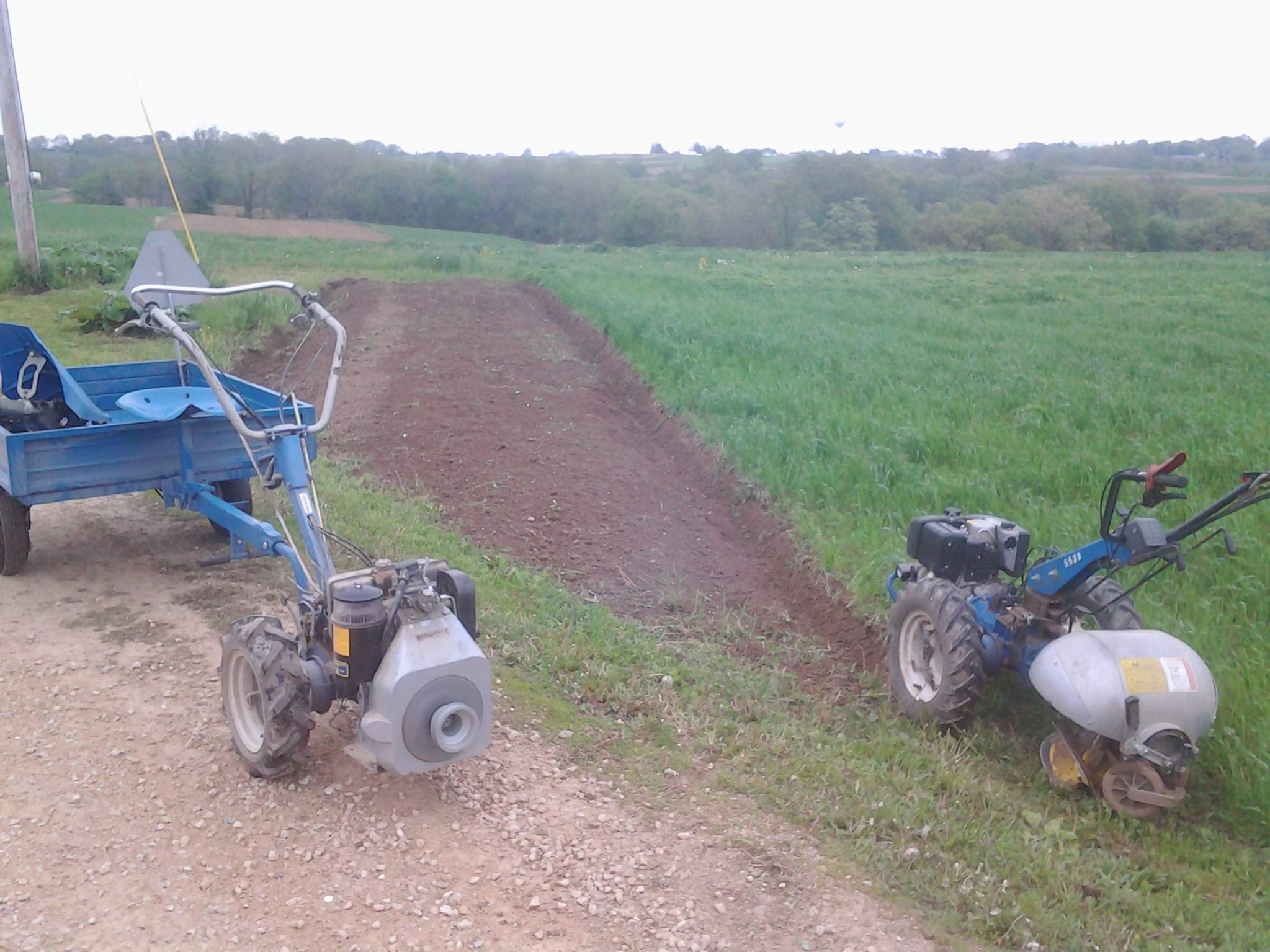

Hey all,
Bought this 735 several years ago. It had been in a shed fire - the tires, cables, and engine were burned badly, but the transmission was only discolored by smoke. The cables still have the sleeves burned, and it still has the smoke residue, but I transplanted this NOS Acme diesel I bought from Paul Sullivan jr., and it runs like a top. I actually haven't used it in a couple years, but when I got this trailer recently, I realized it makes a much better puller than my 850 diesel. It has 2 more speeds in rear mount mode, including road gear. The 850 has road gear in mower mode, so only pulls the trailer at 2.8 mph - VERY slow.
The other is my 830 that had a 9 hp briggs POS that I replaced with a KD440. It's running a Berta 2 way plow. Fantastic pair. I can't believe how much I like my two way plow.

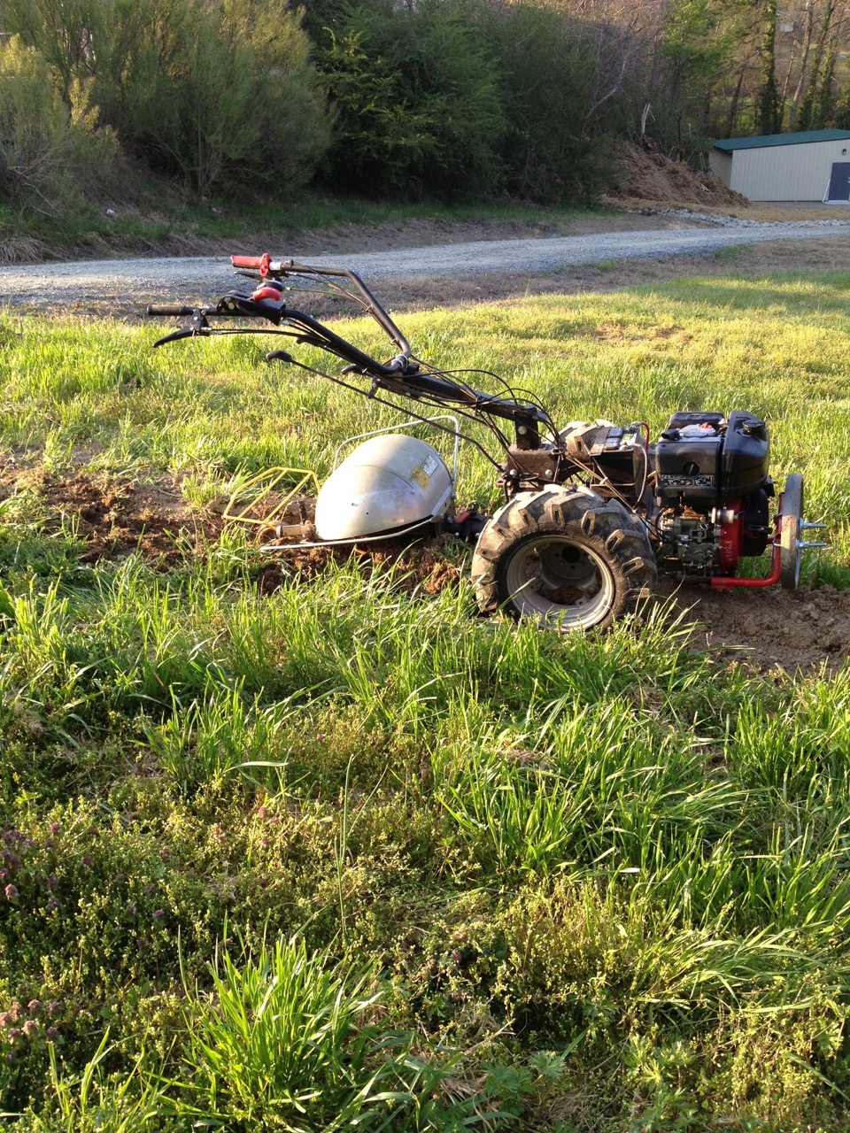

   / My two Diesels #3
Love my Berta rotary plow.

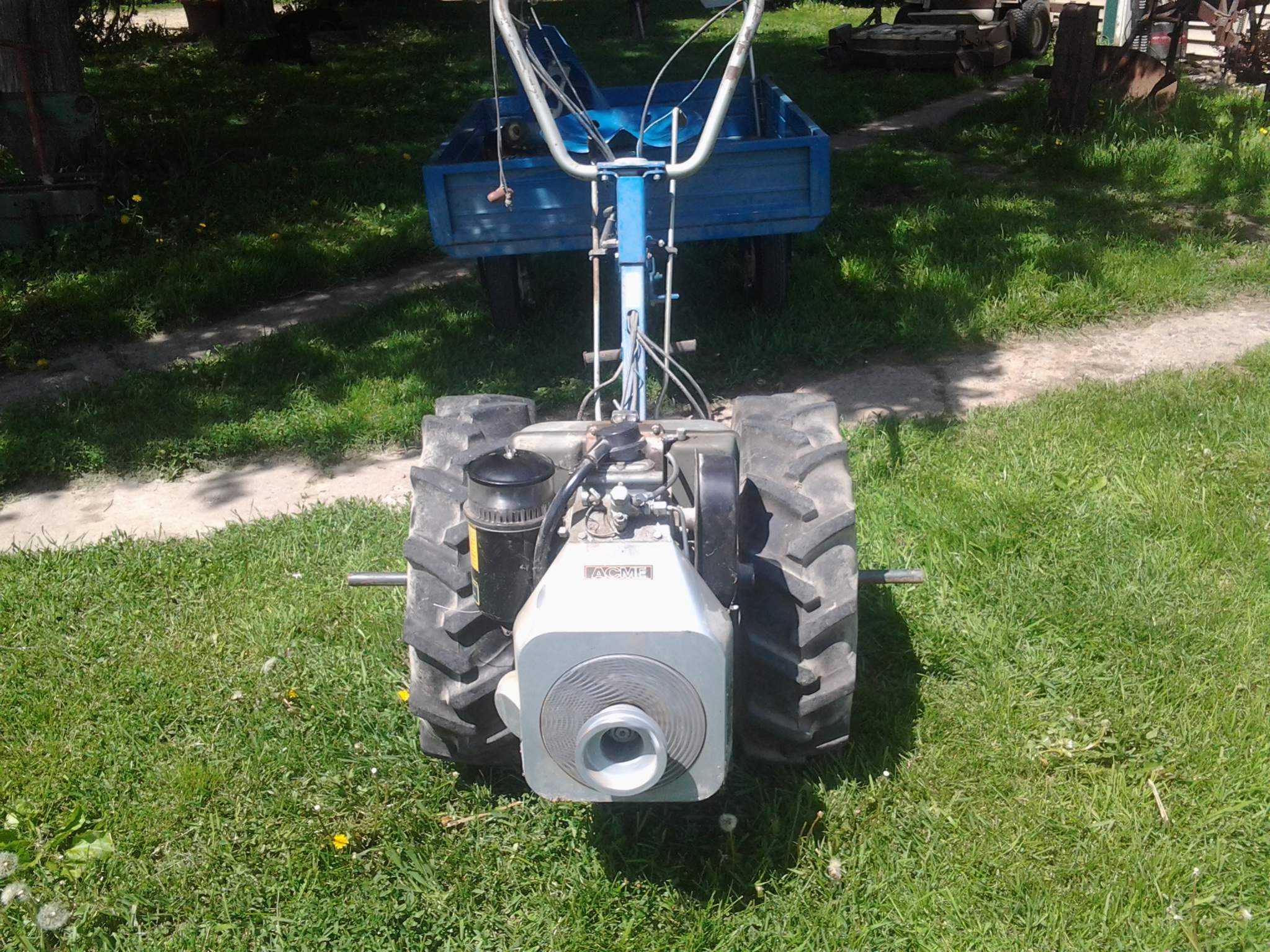

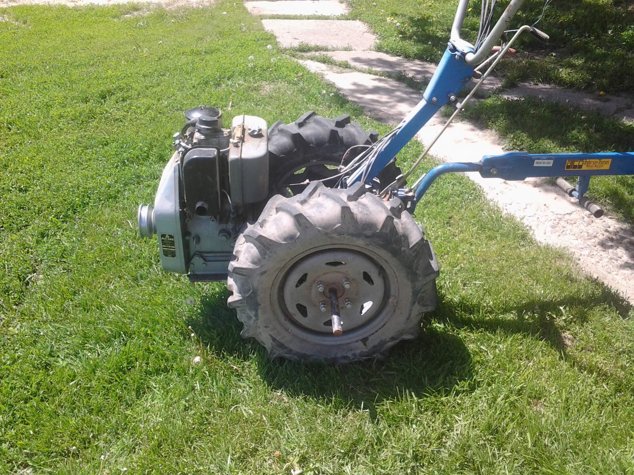

Now with bigger rubber! I had these on an 852 for mowing a couple years ago and hadn't used them since. They're on 4 wheeler rims,so I took two plates, drilled one for the BCS, one for the rims, and welded them on a 5" piece of pipe. The Honda GX390 was too wide to mount them up directly, I had to mount 3 pairs of 5" axle extensions to get them out far enough to clear the engine, but Acme diesel is narrow enough to allow these to be used. They're 24 inches tall and work great for this 735. Really, the 735 is well suited for this job, It was built pre-OPC, so I can leave it running with the clutch engaged and in neutral. Leaving a newer BCS running with the clutch disengaged is hard on the clutch's bearing. With an OPC, a driver can turn fairly tight left, but has to go quite wide right, simply because he has to hold down the OPC. I'm probably not going to use this rig much (I have 4 wheeler, gator, and pickup), but it sure is fun to drive!

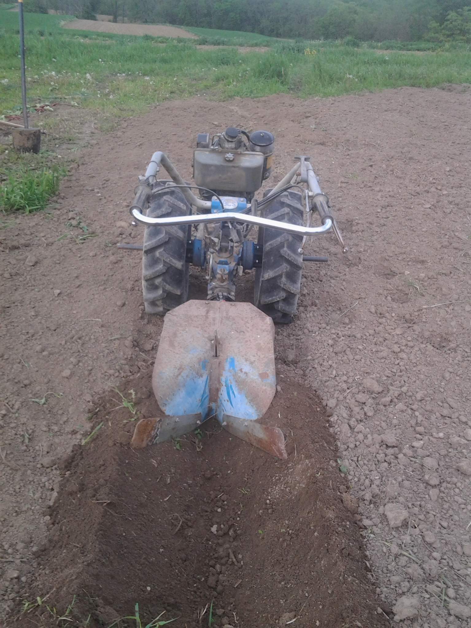

Planted my potatoes last night (yes, VERY late). These wheels are ridiculous! They're great!
