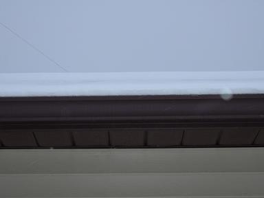

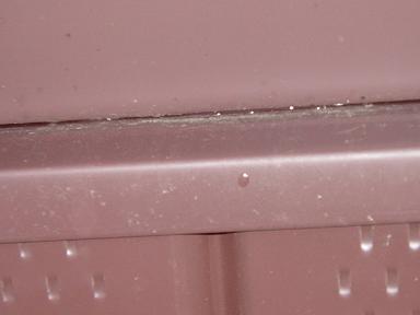

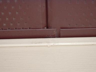

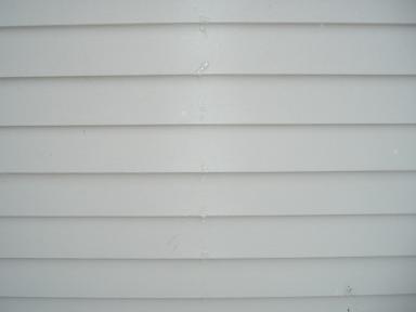

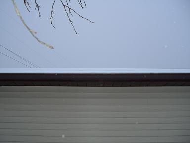

This maybe a hard question to answer but I will try to describe it the best I can. Four days ago we had an ice storm (1/2 inch) then a little rain then snow. I was checking the area around my pole barn the next day and noticed on one area (north side) of the siding there was a little (not big) frozen waterfall. It started from the inside bottom of the soffit and ran all the way down along the siding right to the ground. I have a 24x32x8 with 1-foot overhangs and gutters. It has vinyl siding and aluminum soffit and fascia, and is not heated nor is there insulation. It’s 4 years old. Things like this always rack my brain as I try to figure the causes. First thought was ice dam but I really don’t see any build up at the drip edge other then some tiny icicles that hang half way down into the gutter. I think somehow the water is getting behind my fascia trim and running down on top of my soffit trim on the inside and towards the wall and then drips out at the other end? I also see that a little water is getting behind the gutter right there as well. Now correct me if I’m wrong. The fascia is a 2x6. I’m thinking when they installed the fascia trim they dropped the lower lip (which receives the soffit trim) down lets say ½ inch or so below the fascia board. Now this left ½ of exposed fascia board were the drip edge goes. Of course with the drip edge installed it covers this up. Now my gutters were installed after the drip edge was installed and this seems to be right around were the transition of the gutter being over the drip edge to being below the drip edge. Anybody have any thoughts on this? I could take some pics if need be.

I believe the water was getting behind the gutter and it started to freeze and build up to were it was getting behind the drip edge and entering the fascia that way and then dripping down in the soffit area. My gutters were installed after the drip edge was up. So on the high end of the gutter the drip edge is behind it (the gutter was installed over it). On the low end it’s just underneath it. The leak seems to be where the gutter makes the transition of being over the drip edge to being right below it. This has never done this before during the winter. Like I said before looks like I had all the right ingredients in the wrong place.
It’s not dripping down anymore. If you look at the first pic you can see the water getting behind the gutter. Its all dry at that spot today. We received this ice,rain and snow storm last Sunday. Since then we received around 3 inches this week so the roof is snow covered all the way down to the gutters. I thought about getting the ladder out and pouring some hot water in that area to see what’s going on.

That's a pretty typical ice dam and not a bad one. Forget your saw it for several years. That's how long before you see it again on your building IMO. Now if you were heated, in your locale, I'd guess you'd see it again in a year or three. I read the posts rather quick but I'm not seeing you mention it appearing inside the building, so no major problem I presume. I've had it just like that in Maryland and no inside problems. Your interpretation of how it got there is correct. Capillary action of the water primarily. No big deal.
