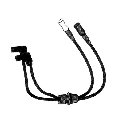

I just couldn't resist. I don't believe # 55 is the switch. I think that number is the two wire harness for the switch, which is located somewhere in the guts of the transmission. It probably looks like this. They probably bypassed the switch assembly because it didn't work. One of the leads could have come off the switch, or the switch is bad, in which case , he probably needs a switch and definitely needs a wire harness, which cost $19.60

As if this post on a simple ID of a NS start switch hasn't already been covered ad nauseam.
Not sure who brought up #55.. but it's not part of the NS start system..
55 1 81815256 DOWEL Dowel, Case Cover, Start Year: 01/01/1975
I believe these are the parts the owner will want to inspect when /if they check the old switch and/or repalce it:
56 1 81817901 SWITCH, NEUTRAL START Switch, Transmission Control Select Neutral, Start Year: 01/01/1975
57 1 E1NN11N002AA RETAINER Retainer, Safety Starter Switch, Start Year: 01/01/1975
58 1 C5NN11N003B SPRING Spring, Safety Starter Switch, Start Year: 01/01/1975
60 1 C5NN11467R PLUNGER Plunger, Safety Starter Switch, Start Year: 01/01/1975
61 1 E4NN7A488BB HARNESS, WIRE Wire Assy., Safety Starter Switch, Start Year: 01/01/1975
62 1 389006S2 CLIP Clip, Safety Starter Switch, Start Year: 01/01/1975
I brought up #55. It is part of the NS Start System on the 6 speed trans. Your part numbers are for an 8 Speed Trans. I didn't see in his first post where he mentioned which one it was, so I just looked up the 6 speed.

This looks like and is described as a safety starter wire harness. If you guys have a better picture and description, please post. Will someone just take off the cover plate and take some pictures, and let us know the truth. If the switch wires are very much different, I will apologize for making an educated guess.
The illustration below is your # 61. which is the picture above.

the entire 6spd and 8spd diagram is on the nh parts website... no need to disassemble just to take pics.
I didn't see anyone being negative.. just stating facts.
I've never seen more discussion on what a part was as bad as this one is getting kicked around... that rubber plug with 2 broke wires on top is exactly, and only.. a ford NS switch.. I can't imagine what the ballance of the rest of the discussion is for.
if it's a 6 spd.. the part numbers are gonna be different than the 8spd.
big deal...
the function is the same.. and the electrical circuit is the same... it's a switch that interupts power to the solenoid when in range. nothing more.. nothing less.
I can't imagine what all the discussion past that is for???
as for the pic of the wire harness.. what point are you trying to make... it's a wire harness.. 2 conductors.. some terminal ends and a rubber grommet / plug to fill up the hole in the trans top... this horse is well tenderized hamburger by now....

it's a moot point either way. did you happen to notice that the EXACT SAME part number is used for the 8spd and 6 spd NS switch. It makes little difference that the diagram specific line item numbers ( 50 vs 56 ) are different.. you don't order with the line numbers.. but rather the part numbers... which in this case.. for the NS switch is 81817901
it's not a glow plug connection.. and there's no need to pull the trans top to simply check it with a test lamp or ohm meter... and there's no need to pull the trans top just to verify what it is.. its quite obviously the wire stubs for a NS switch.
Now.. if it is bad, and the op wants to replace it ( reccomended ).. then he needs to grab the right part numbers once he pops the top and finds out what all needs replacing.
