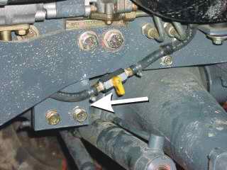

It turns out the tractor is not getting up to temp. after all.
I used it this weekend while burning a large pile of brush.
Had it running for a good 30 min. and the radiator hoses were barley warm.
The gauge does move up just a bit but not nearly where it should be.
What does it meen to re tube the cooling system?
Other than that she runs great and is a joy to use
   / N H TC35 #23
I will probably be the first of many to tell you of two possibilities you have on your tractor. In the case of my tractor, I had both. Here's the scoop:
  • 1. Your thermostat may be stuck open because of a design defect
  • 2. Your engine block drain has a hose going to the bottom of the radiator. Cool water bypasses through this hose and keeps the engine cool, especially in cold weather.
Here is a picture of the thermostat with the stuck bleed valve. Most of us have found that you can just cut the little valve flapper off and the thermostat will work fine.
The second problem is cured by putting a valve into the bypass hose as shown. Turn the valve to off and the bypass will stop. If you ever drain coolant, open the valve so the engine block can drain.

You guys have been right on the money with all the advice.
I pinched of the bypass hose and she came right up to temp. in no time.
Also the fitting on the block that the bypass hose is connected to is dripping a bit.
I will check into that when I get the parts for the bypass hose.
