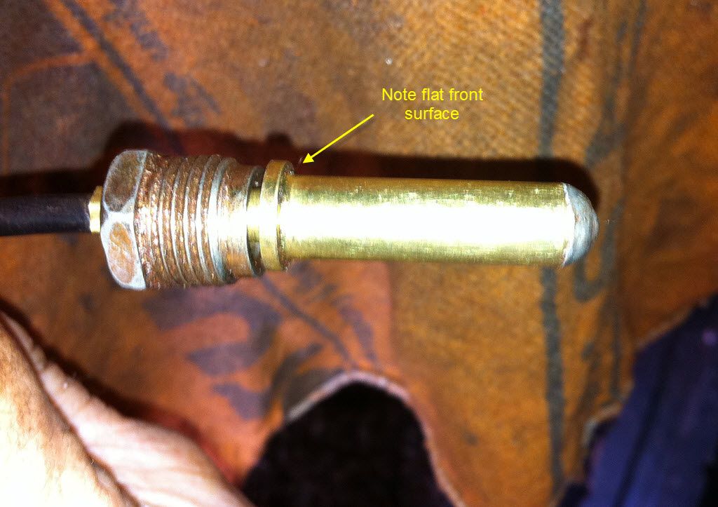

I purchased a new temperature gauge for my NAA and replacing it was easy enough but the temperature probe will not tighten on the engine. Even once the retaining nut is tight, the probe itself wiggles a bit - and while I didn't start the engine I am sure it would leak coolant big time! :)
I compared the old and new probes and they appear identical except the original probe appears to have a slight flange at the top whereby the new one is more flat.
My new gauge came with a large adapter nut (not needed) and three little tapered rings which I did not use because I couldn't figure out what they were for. After I discovered the probe was loose despite a tight nut I tried sliding one of the tapered rings over the probe but then it would not insert far enough to get the retaining nut started.

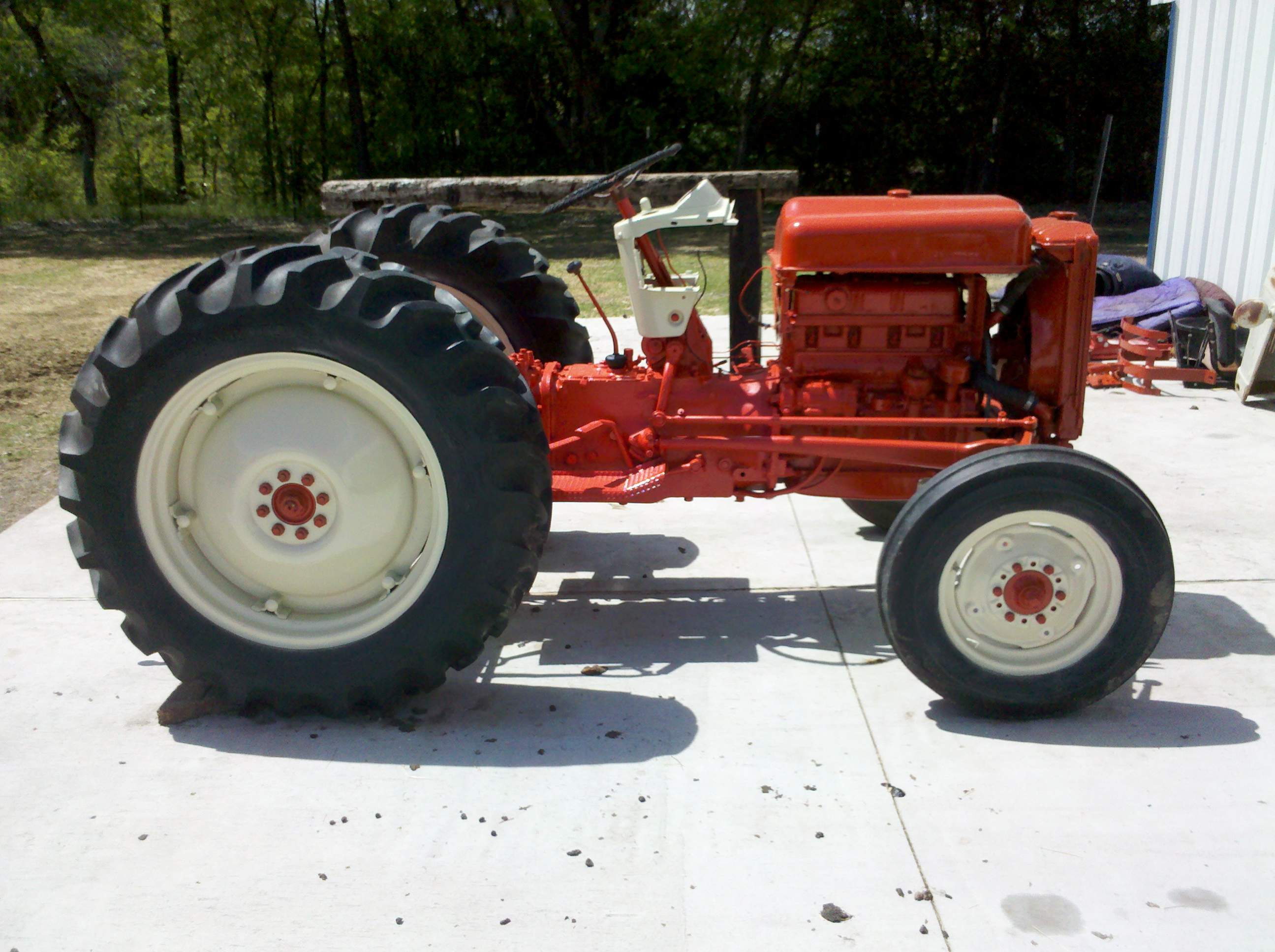

I am having the same problem with my temp gauge. Any help would be greatly appreciated.

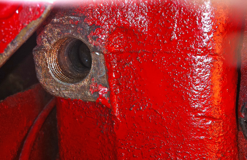

Hmm... I will have to drain the coolant and check the hole again. I looked in there with a flashlight and didn't see anything but it's certainly possible something is stuck.

There was no removable collar on mine but the old probe was tapered and the new one is flat. They sent 3 of those tapered rings (all the same size) 1/2 inch but the probe itself is 3\8 inch in diameter. I tried putting it in with an o ring but that didn稚 work either. I cleaned the probe hole out with a wire brush and I am pretty sure there are no more parts up in there.

I had a chance to work with the tractor again today. There is definitely nothing in the block hole. I took some photos to illustrate the difference between the two probes. I hope this helps to explain the difference. Sorry the one is fuzzy, my goofy camera kept focusing on the background. :-(
I just received yet another NAA temperature gauge from another source and it has the same probe with the flat mating surface (i.e. won't work).
I'm open for suggestions.
