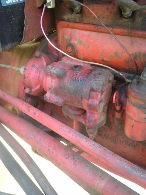

I was mowing the field last weekend with a 6ft flail mower. When I started, everything was fine, but about an hour into it I realized that the 3-pt lift wasn't lifting anymore. If I rev the tractor up or wait a few minutes it will lift a little bit-maybe a couple inches off the ground. If I take the weight of the mower off the back, the lift arms seem to work fine- up, down, quick response- This flail mower is stupid heavy, though.
I rebuilt the hydraulics and flushed all the fluids over the winter when I bought the tractor, and it has worked famously since then. This was a pretty sudden thing. The tractor does sit outside all the time, and the UTF is a bit milky. I've let it sit, and I've taken the hex cap off the side to maybe relieve pressure or something... I dunno; I really don't know what's going on.
HELP! My grass won't stop GROWWWWWING!!!!
THanks!

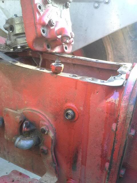

The hex cap on the right side- the pressure valve or whatnot. Honestly, I don't have a complete grasp on how the whole hydraulic system works- When I took the top off for the rebuild, the pressure valve just seemed to sit there through the hole in the side case- it's not hooked to anything. Does the whole case pressurize, or what?
I don't know if the flail mower bounced hard on the lift arms when I let it down and bent something inside, or what. I'll just crack the top off in a minute here (now that my daughter is off to ballet for an hour) and see if anything is obviously awry.
   / NAA stopped lifting weight #5
sounds like you are talking about the back pressure valve that sets under an acorn cap nut on the side of the case. prior to removing the lift cover you MUST remove the nut and back off the back pressure valve to prevent damaging it. if you didn't do this step.. i'd look for valve/ring damage.

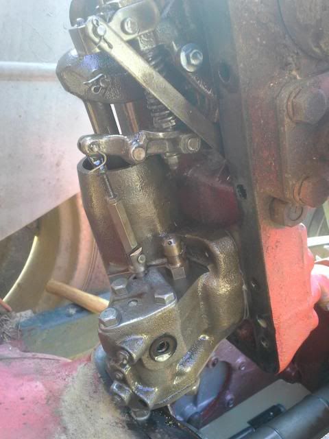

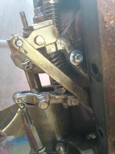

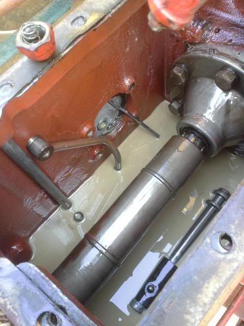

Alright, here is what I'm looking at. I took the acorn nut off the side of the body, there is just a spring in there. I took the spring out, turn the tractor on, and a little bit of hyd fluid squirted out when I moved the quadrant lever around. I took the lift top cover off, and I don't see any sort of oring around the valve. I assume it is threaded into the tractor body, then the pickup tube is pushed into the side of the valve? It doesn't just push through the body, but it will turn. From what I can figure, the way that the whole system gets the fluid from the tank to the piston is that one hole in the bottom/side of the top cover that just rests against the pressure valve? If that seal is bad or not tight enough, then it's like poking a hole in straw, right? The fluid looks like it would be low to me, but the stick says it's good. What do ya'll see?
Thanks so much for helping me through this!
