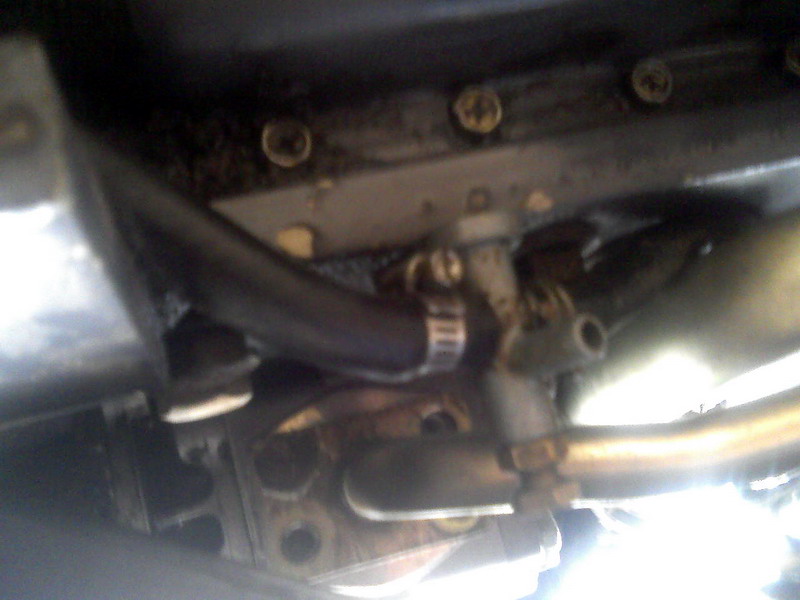

I've had great luck with the hydraulics on my 2000 model TC45D and had no problems until recently. Last year, I had my hydraulic pump seals replaced on my tractor and all went back together nicely except for one pinched o-ring I had to replace at the diverter valve. About 3 months ago, I developed a spewing hydraulic leak where the high pressure line bolts to the diverter valve. That's directly under the right foot rest of the operator's platform. The leak was so bad that the whole bottom of my tractor had a hydraulic bath. I had measured my pressure at exactly 2500 psi, so I know the pressure is not too high. I figured I had not tightened the fitting properly. When I removed the nut, I found that it and its lock washer seemed to not tighten the flange properly. Below are some photos that show the flange, o-ring and screen. Notice that the pipe is made to slide straight upwards between the hydraulic pump and diverter because you cannot move the pipe horizontally to get it out. That's why there is a slot on the top of the flange. It has to slide onto a stud and then a nut added. The bottom uses a bolt. I've included some photos of the pipe installed.

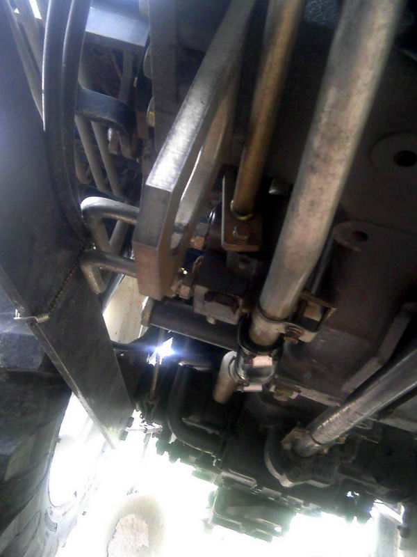

On the hydraulic pump end, the flange has four bolt holes. If you look at the illustration below (Item #9) it shows the pipe has only two bolts on the flange and the diverter end does not show the slot. I found by research that the TC35D's hydraulic pump flange only has two bolts. With its pressure being only 2300 psi, only two bolts are required in the pump. I have never had a problem with the pump flange and seal leaking, only the diverter valve flange. The tiny o-ring on the diverter end just seems to blow out and spew hydraulic fluid. It's frustrating to me because it was never a problem for almost 12 years and 1700 hours. Now, a "simple" job has turned out to not be so simple.
After replacing the o-ring AGAIN, I put a flat washer under the bolt head to help apply pressure. I think the slot may have deformed or the bolt head and lock washer could not apply even pressure, allowing the flange to move outward enough to blow the seal.
After repair, I went to work boxblading my dam and moving some rip-rap with the loader. A whiff of hydraulic fluid told me to look down and my heart sank. It was spewing. Obviously, I've bent the pipe or flange so much that with the normal hardware and o-ring, sealing is NOT possible. So it's time to go to Plan B on getting the seal as it should be.

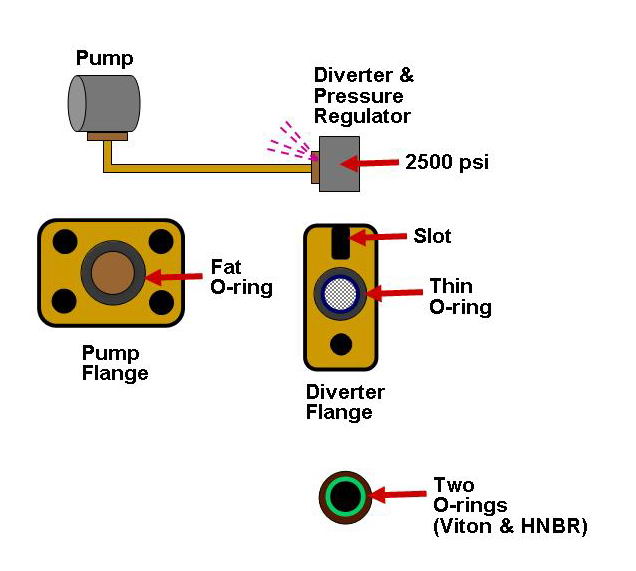

So, on Friday morning I started with "the final" fix before I order a whole new pipe. I'm sure I've bent this pipe or messed up the diverter side flange. If my Plan B doesn't work, I'll spend the $135 for a new pipe.
Below is what I did in the illustration. As I said before the pump side is no problem at all. I have used the same o-ring seal on the pump since I changed it when I first got the pump repaired. It just works perfectly. Since the diverter flange has a tiny thin o-ring, I found a fat Viton the same diameter as the original and an HNBR o-ring that would fit into the center of the Viton. There is plenty of metal sealing surface for both of them if the little thimble looking screen is removed. I know it's there to catch debris, but only if the pump completely destructed would there be any metal. The fluid is drawn from the reservoir through the main hydraulic filter and only goes through the main pump before coming to the screen. I'm gonna run without it so I can put double seals in this flange.
Next, I went to Tractor supply and bought grade 8 flat washers. I put three big flat washers on the stud and still had plenty of threads for the nut and lock washer to go on. The big flat washers span the gap well and provide even pressure on the top of the flange. With trembling fingers, I started the engine and checked for leaks. Yippee! None were found. I put pressure on the system several times to open the relief valve and there were no leaks. I then went and used the tractor to boxblade my road I made to haul materials to my pond dam project. A check afterwards showed the fitting still dry. So, I think I'm going to call this problem fixed. I've got my fingers crossed that the dual o-rings will solve the blowout problems.
Again, I don't blame this problem on anybody but myself. I'm sure that if I'd been careful not to bend the pipe while first removing the pump and also didn't spread the slot on the flange, I'd be fine with the OEM parts. As it is, I'm correcting my own bonehead mistakes. I'll report back if I run into any problems. I don't know if there's a moral to this story or not, but I'd sure say that what looks simple can easily be the thing that eats your lunch.:eek:

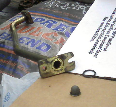

Tubing arrived Wednesday as promised and I picked it up yesterday. This morning, I decided to tackle the job of replacement. The first thing I did was crawl under the tractor and inspect the old tube. As I expected, I had parts of two o-rings hanging out the back side of the diverter/regulator end flange (1st photo). The Viton is red and the HNBR is green.
When I removed the tubing, the Viton ring had exploded due to over-compression. The HNBR had an extruded "tongue" on one side (2nd photo). I compared dimensions of the old part to the new one with my antique micrometer and found them to be as close as I could measure. The o-ring that fits is supposed to be .969" o.d., and .0945" o-ring thickness. I measured the gland at .9515" wide and .0915 deep. That means the o-ring diameter is slightly compressed to fit into the gland and it is only .003" thicker than the gland depth. My gland diameter measurement may have been off a bit because one of my tips is nicked on my old micrometer, and it's hard to measure diameters on such a shallow gland.
The real story was when I put the micrometer's edge across the flange (final photo). The ends of the flange were slightly bent so that the center around the gland had a gap when the flange was tightened. You can't see light in my photo, but I could easily see it under the mic on the old tube flange and not on the new one. The new flange is perfectly flat.
I installed the new tube carefully, tightening the diveter flange end before tightening the four bolts into the hydraulic pump. I cranked up the tractor and raised the bed on the dump trailer until the cylinders extended to the end and the pressure relief popped. I did the same with the loader. NO LEAKS!. I'm not sure it's fixed, but I've done my best to do the job right. I put the correct o-ring in from New Holland instead of my experimental ones. Everything is back to stock and I've got my fingers crossed that this time it will all be good.
