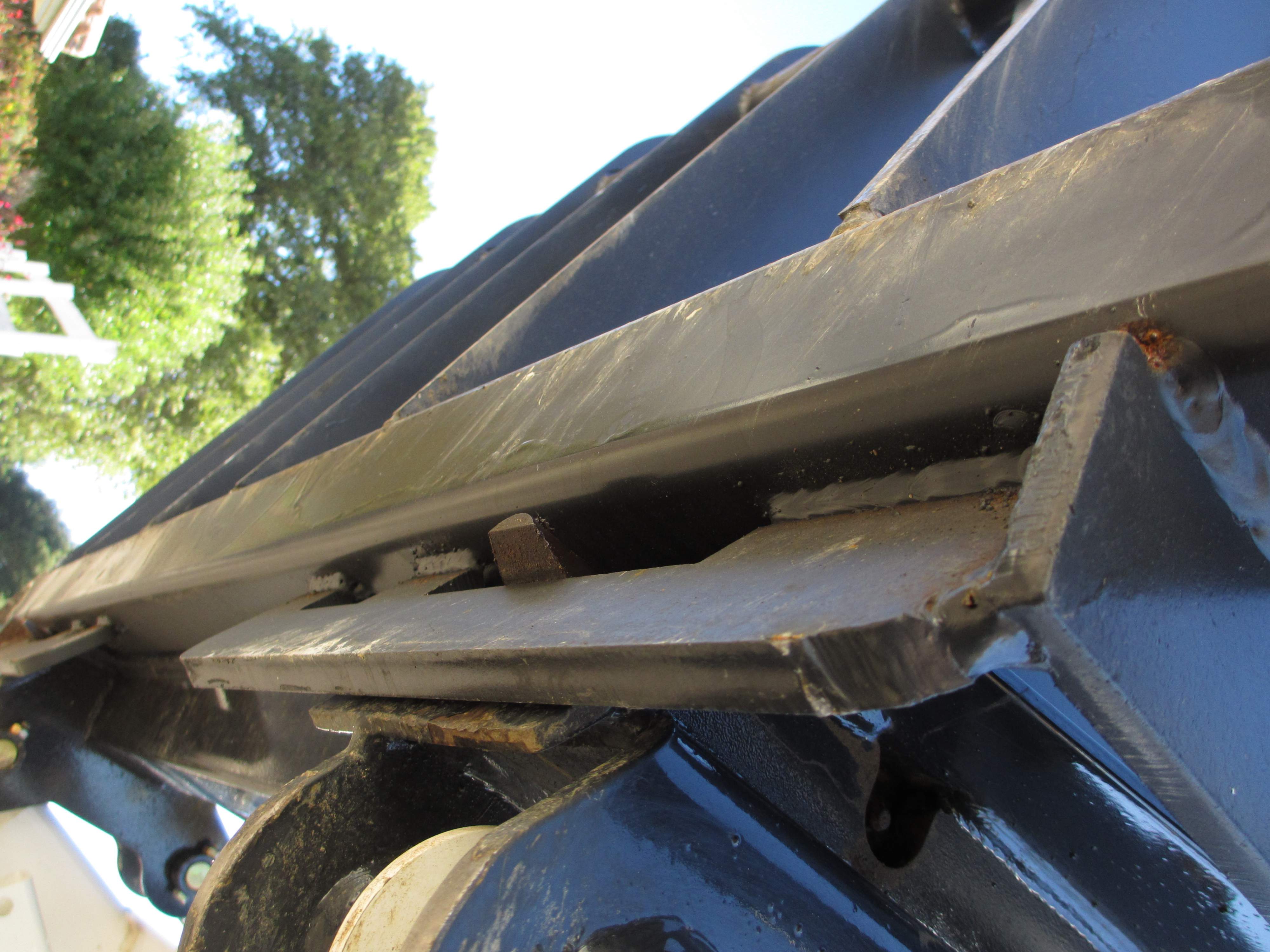

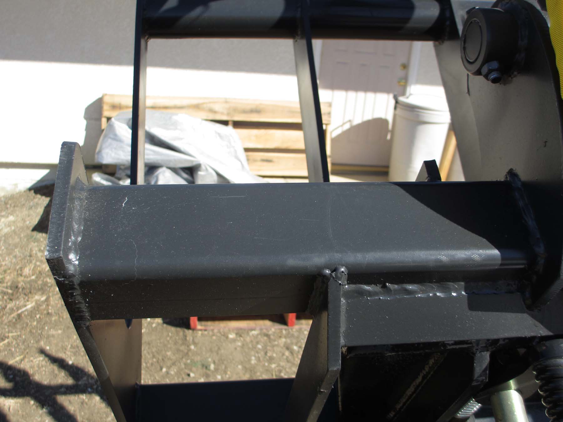

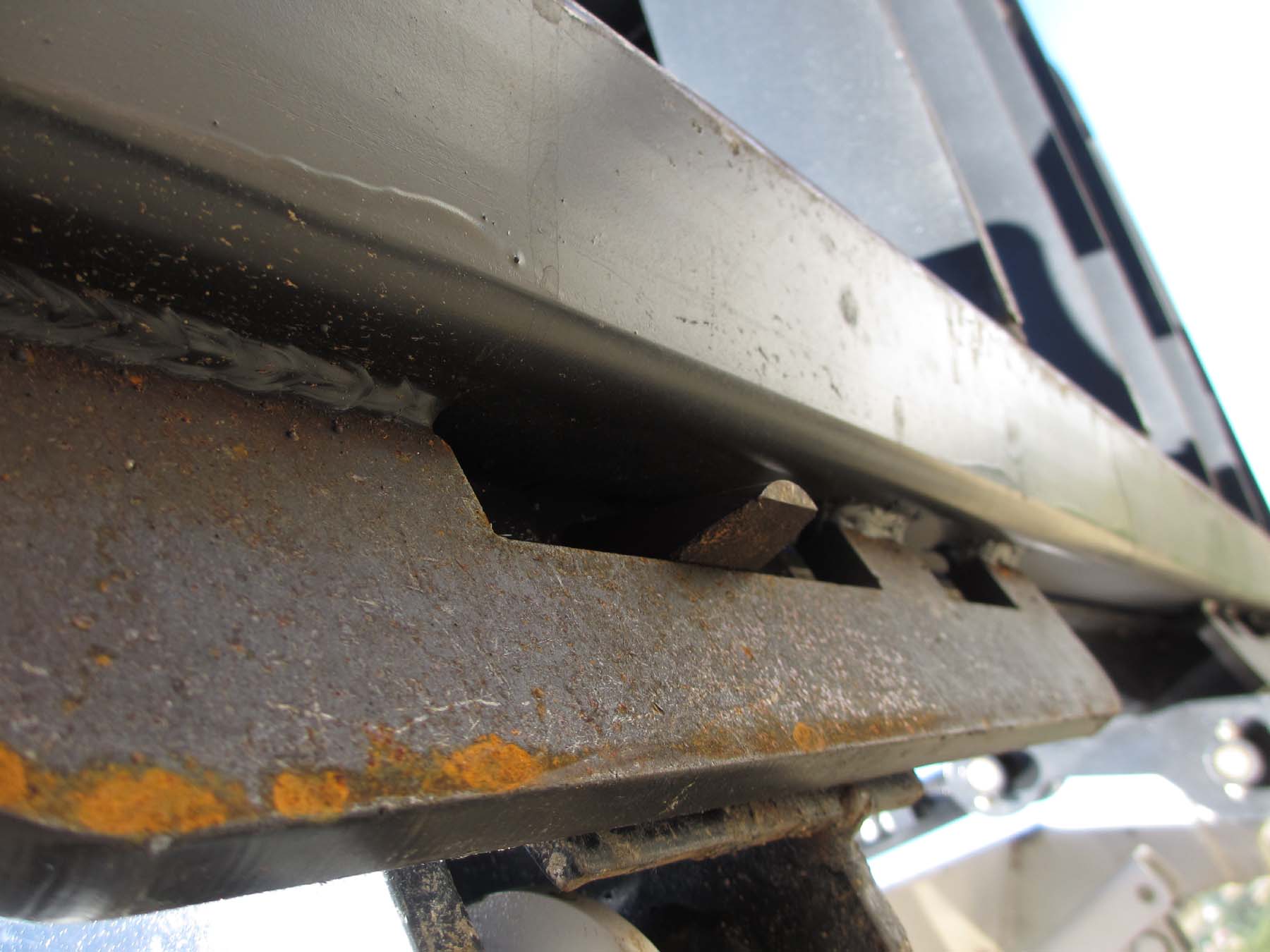

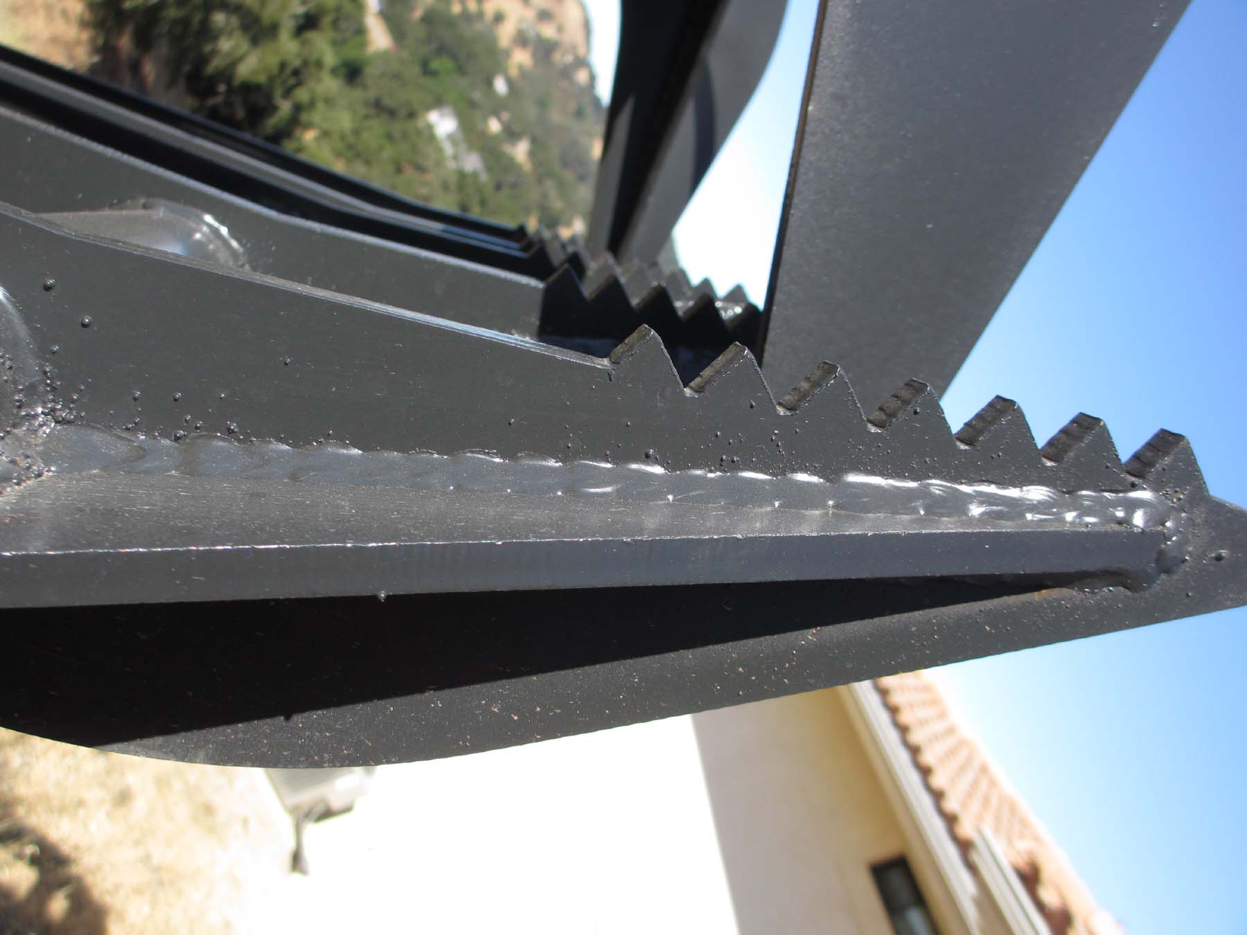

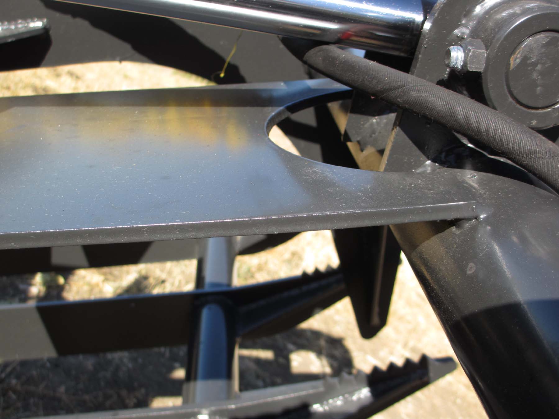

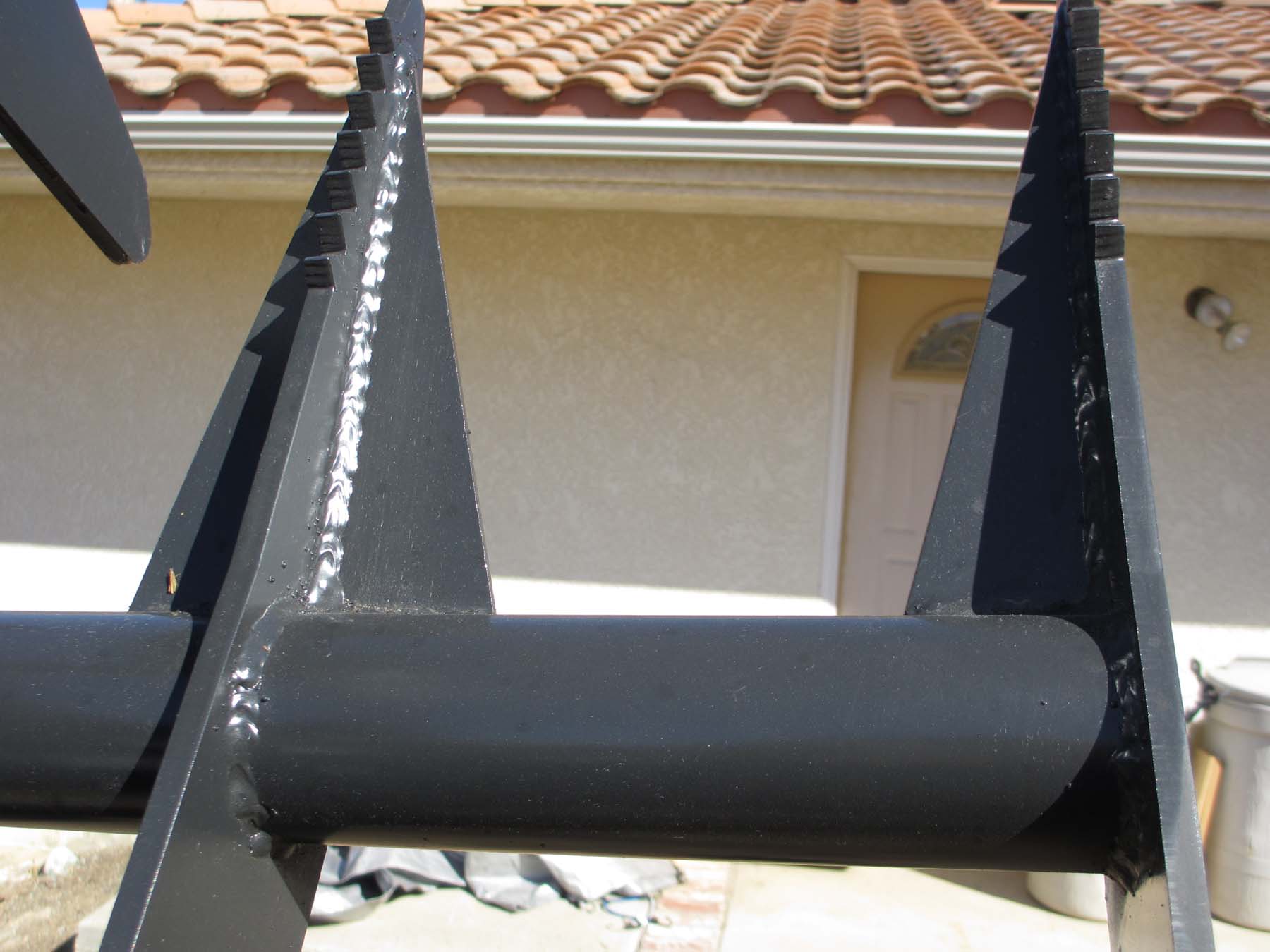

I'm considering the NAI grapple as well. How do the SSQA pins fit? Any gaps like some folks have reported on other brands?
-Jeff
Jeff, Attached are the photos of the SSQA pins. I was happy to see that they are tight and extend beyond the bottom of attachment plate by at least 3/4" on each side. The attachement plate is an impressive 1/2". The gussets are 3/8'; the front tube that the tines connect too is 2 3/4" (specs say 2 1/2"); the rear box tube is 3x3 by 1/4"; the plate below the cylinder is 3/8". I'm very happy with the construction of this grapple. IMG_0280.jpgIMG_0281 sm.jpgIMG_0285 sm.jpgIMG_0287 sm.jpgIMG_0286 sm.jpgIMG_0284 sm.jpg
   / NAI 60" Grapple delivered today - Photos #12
Thanks for the excellent pics. That's good news about the pins.
