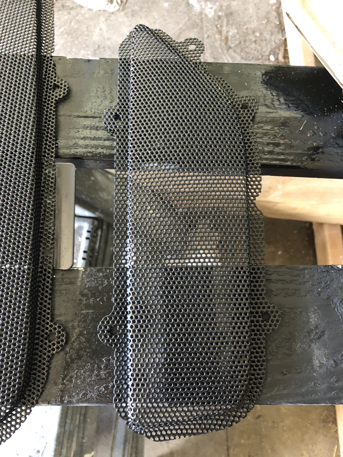

What is the perforated metal used in the bonnet/grill of many tractors. Same stuff seems to be in my LS, was in my Case DX and I need to repair/replace a small piece on front on my Kioti.
Here is a side panel of same
   / Name for this? #3
Perforated metal?
   / Name for this?
Yea, think it may be called perforated, not expanded, but curious how to get same gauge and hole pattern
Wonder if in a hardware store? Didn’t find at HD.
   / Name for this? #8
Your metal supplier should have all sizes. I buy it by the sheet but they can shear up whatever you need.
   / Name for this?
#9
Thanks, guys
   / Name for this? #10
Yes, expanded metal is something different. It is actually expanded, or stretched, in manufacturing. They cut little slits, then pull them open. This puts all the solid parts on a tilt, too. Then they may also calender this through rollers to flatten it again, or may leave them tilted, which creates more of a tread grip. Perforated metal manufacture creates a zillion little disks of scrap. Expanded metal manufacture doesn't create anything like that.
