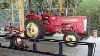

Well gents I purchased a tractor a few days ago, no its not new like I was looking at but it was a deal I couldn't pass up, atleast for the rough starter work. Its a 97 mahindra 485 Di, 45up 2wd one owner 389 hours on it, 6ft brush hog and 6ft box blade $3500! Couldn't pass up that deal, what do yay think? And thanks for all the help!! B7629C43-C332-95E4-CEF3063DE10F5D52.jpg

Well gents I purchased a tractor a few days ago, no its not new like I was looking at but it was a deal I couldn't pass up, atleast for the rough starter work. Its a 97 mahindra 485 Di, 45up 2wd one owner 389 hours on it, 6ft brush hog and 6ft box blade $3500! Couldn't pass up that deal, what do yay think? And thanks for all the help!!<img src="http://www.tractorbynet.com/forums/attachment.php?attachmentid=349667"/>
Nice. I get a lot (50%?) of my work done with "has been" tractors. Well worth it and keeps the newer tractors "newer" (less hours). Tons of life left in your tractor.

That's a lot of tractor for the money, well done.
