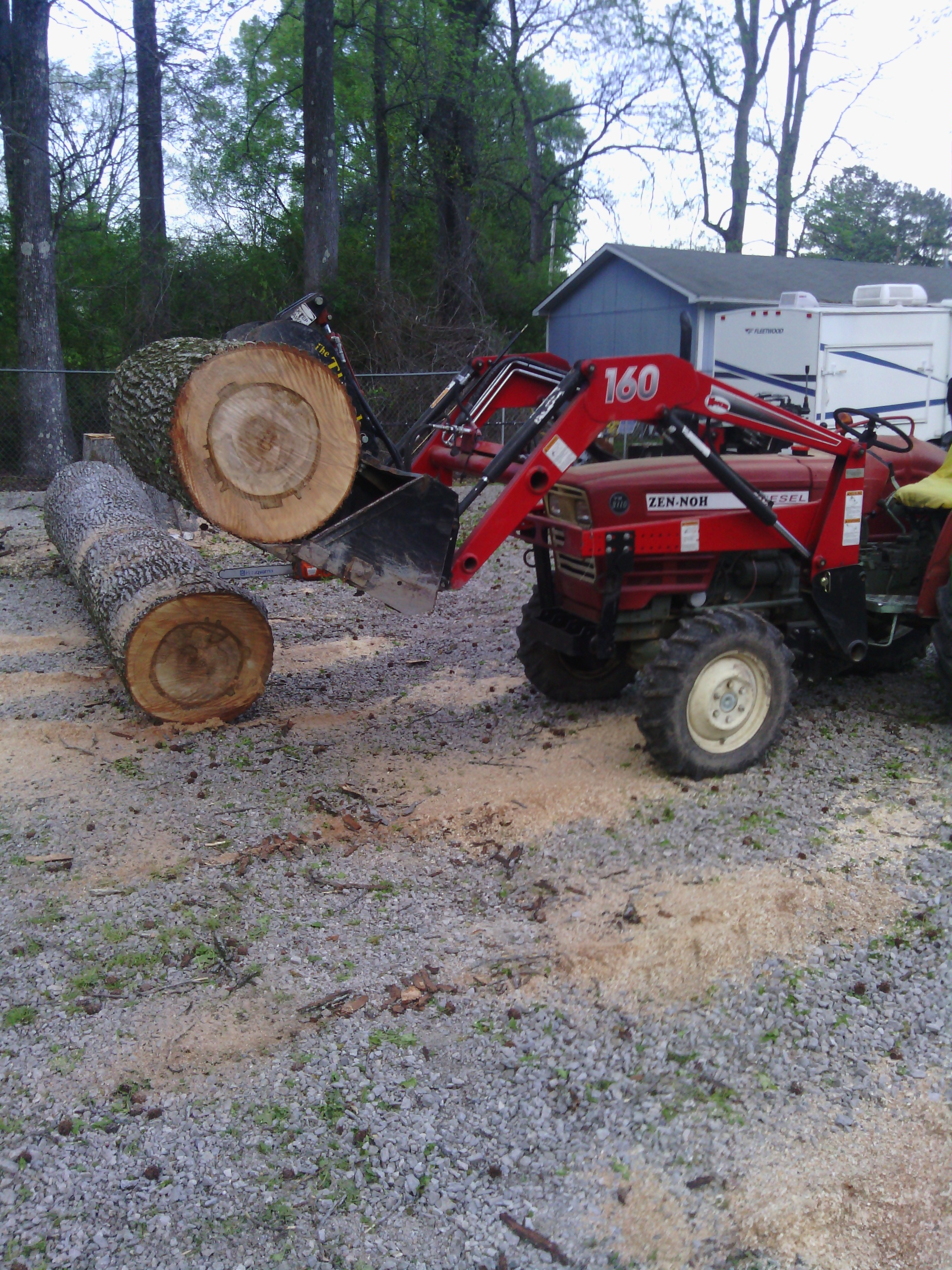

the weight will be around 2900 # then 500 #or so for the loader Those aren't rice tires on that 3110. they are AG tires.. I installed my ROPS.. Not a big deal.. Probably all of 2 HRS for the install.. This log is about all my yanmar wanted.. Loader was fine lifting the weight. Bucket ,and grapple were maxed out

well, if the rocks are very large like this tree, the grapple would be handy. I was trying to give an example of the weight the loader can pick up. A grapple would be very handy for picking up rock. Have picked up several large rock with this grapple..
My tractor was 1 of the 1 st tractors. I bought it when he was just starting out. there were no ROPS for these tractors until he had them designed / engineered for them. I had to wait until they were ready.
