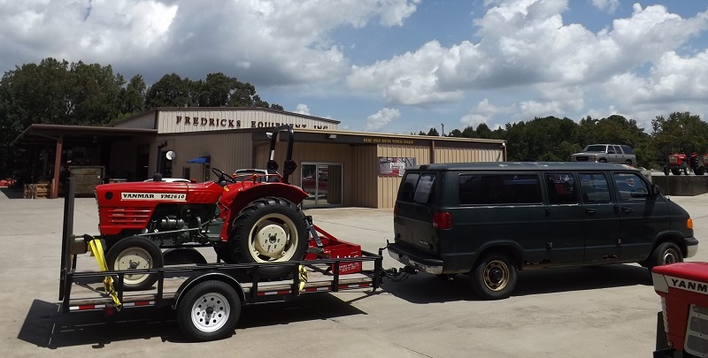

My single axle (yes, I did say single) is a 3800lb rating. The trailer is square tubing vs. the angle iron type. Plus the front hitch runs all the way under the trailer to the rear axle to ensure heavy loads are manageable.
I drove the van rated at 8,800lb towing down with the YM2610 and came back home with the YM2610 and a box blade from Fredricks. The trip was just over 3-hours, but I only did 60mph and not 75 like the traffic around me was doing. The trailer still had plenty of axle leaf room for additional weight to haul, but i was happy otherwise.
I too would agree with sizing up a trailer for the tractor and a little more room for box blade or rear mower just in case. Why make two trips. ;)
