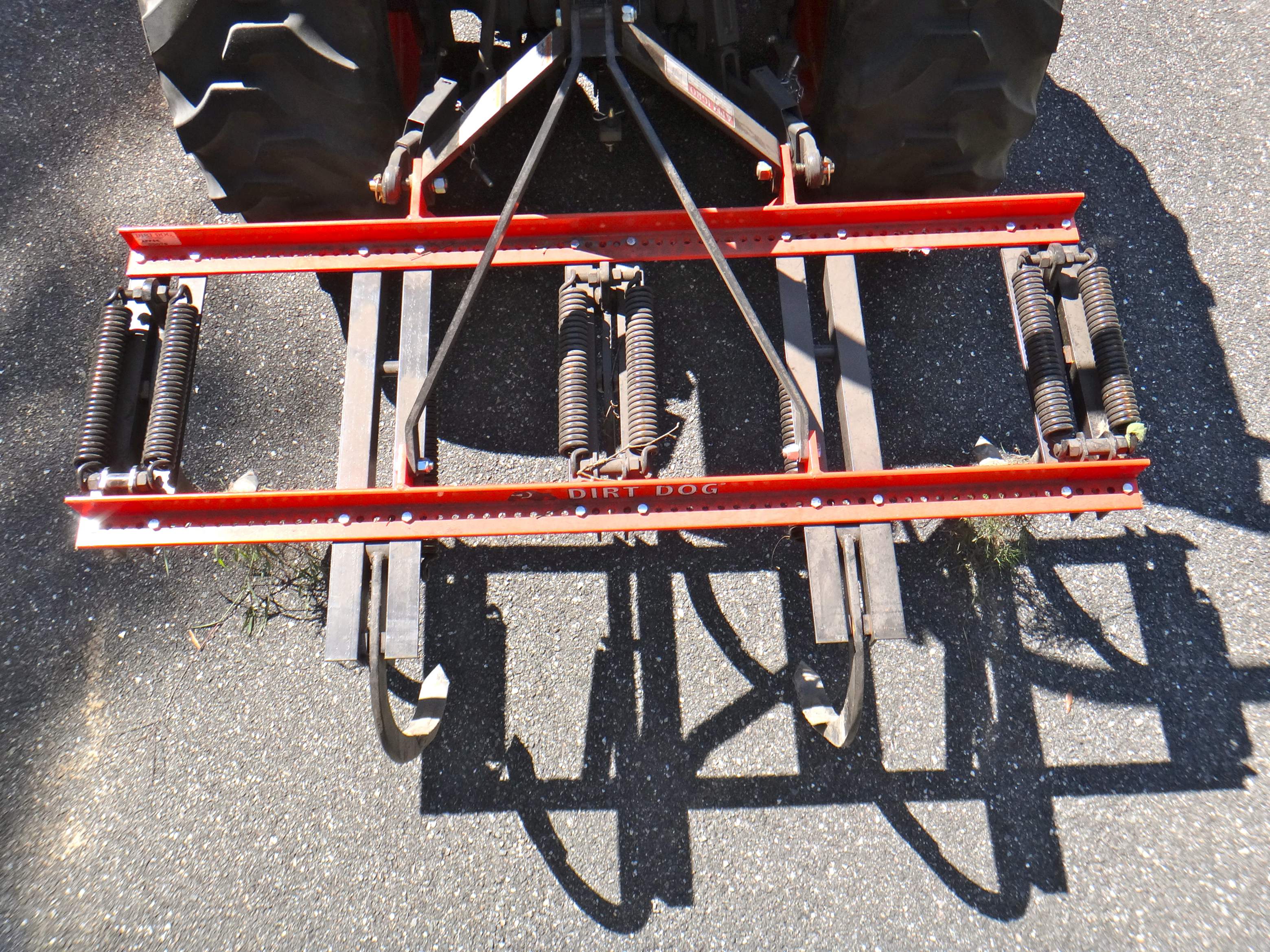

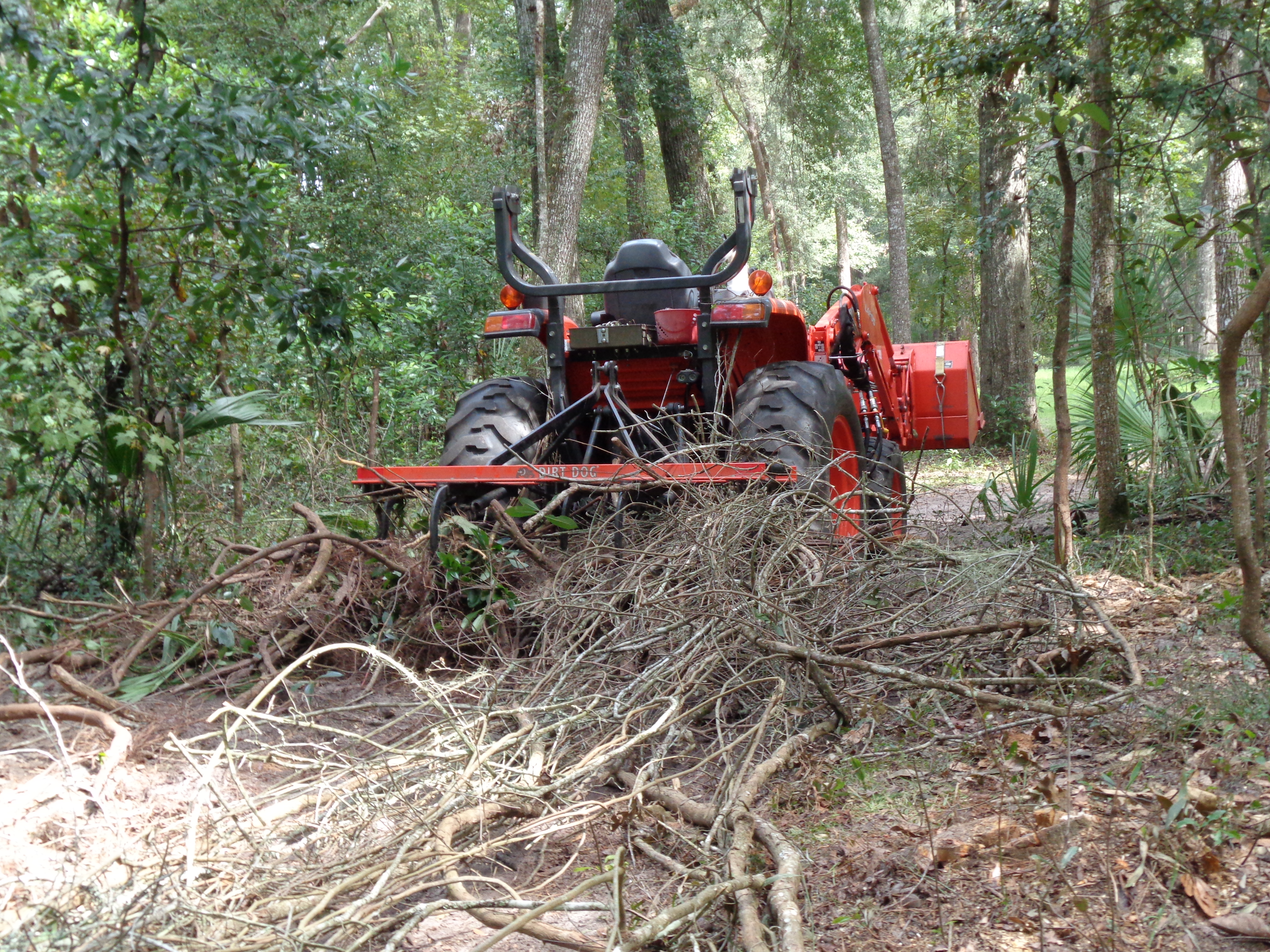

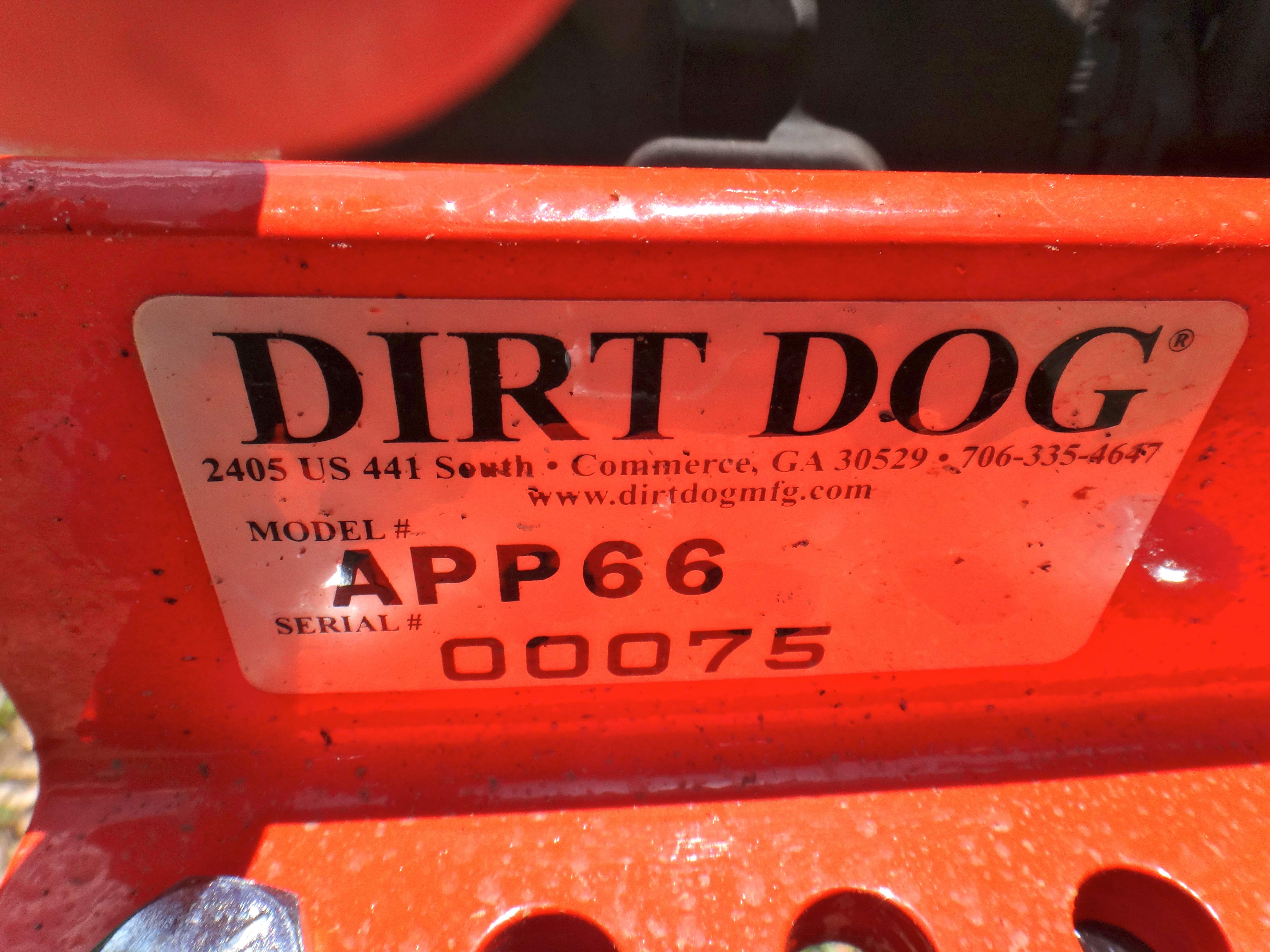

Consider a spring-protected Field Cultivator/All Purpose Plow for dragging roots out of the ground then transporting large amounts of piled, interlocked material to your burn pit. The Three Point Hitch is built for heavy work with weight bearing on the thick, solid rear axle. The FEL is not. Loads are dragged on the ground with a Field Cultivator.

You will want a large lopper on your tractor. I secure my lopper with a "GearTie" Loopable Twist Tie which I purchased at Home Depot.

Thanks for the tips Jeff! I really like the field cultivator idea. I'll have to really start looking into those now too
