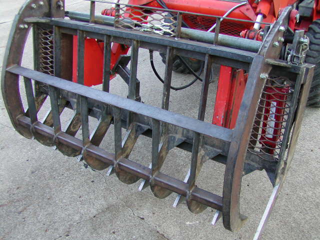

As requested by some, here are a few pictures of my recently built root rake grapple.
It is a real labor saver.

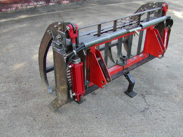

This one shows size of the closed position.

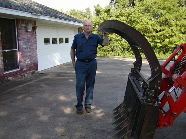

Re: Neal\'s Root Rake Grapple

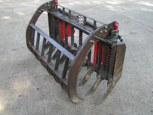

Open position & the old codger that gets to enjoy it.

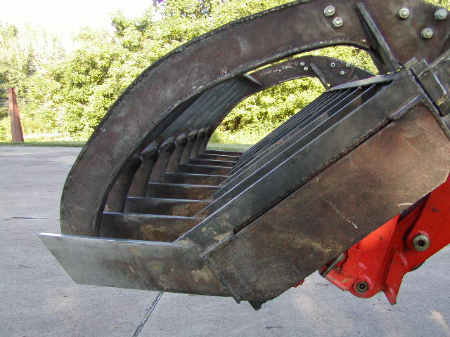

It is good for back rakeing or pulling vines out of trees, either down low or up high.

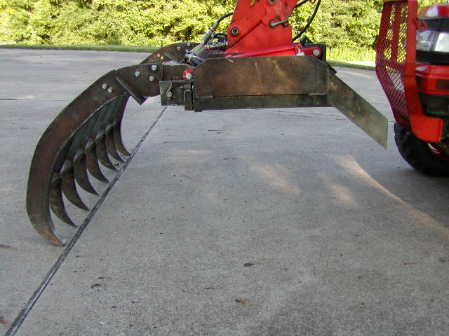

Another full open view

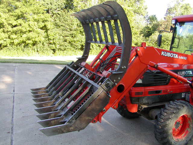

Unmounted front view.
We made stops to clip inplace along with the parking foot, so when it is removed from tractor, it will hold grapple partially open & keep all pressure off hydraulics for easy disconnect and reconnect.
