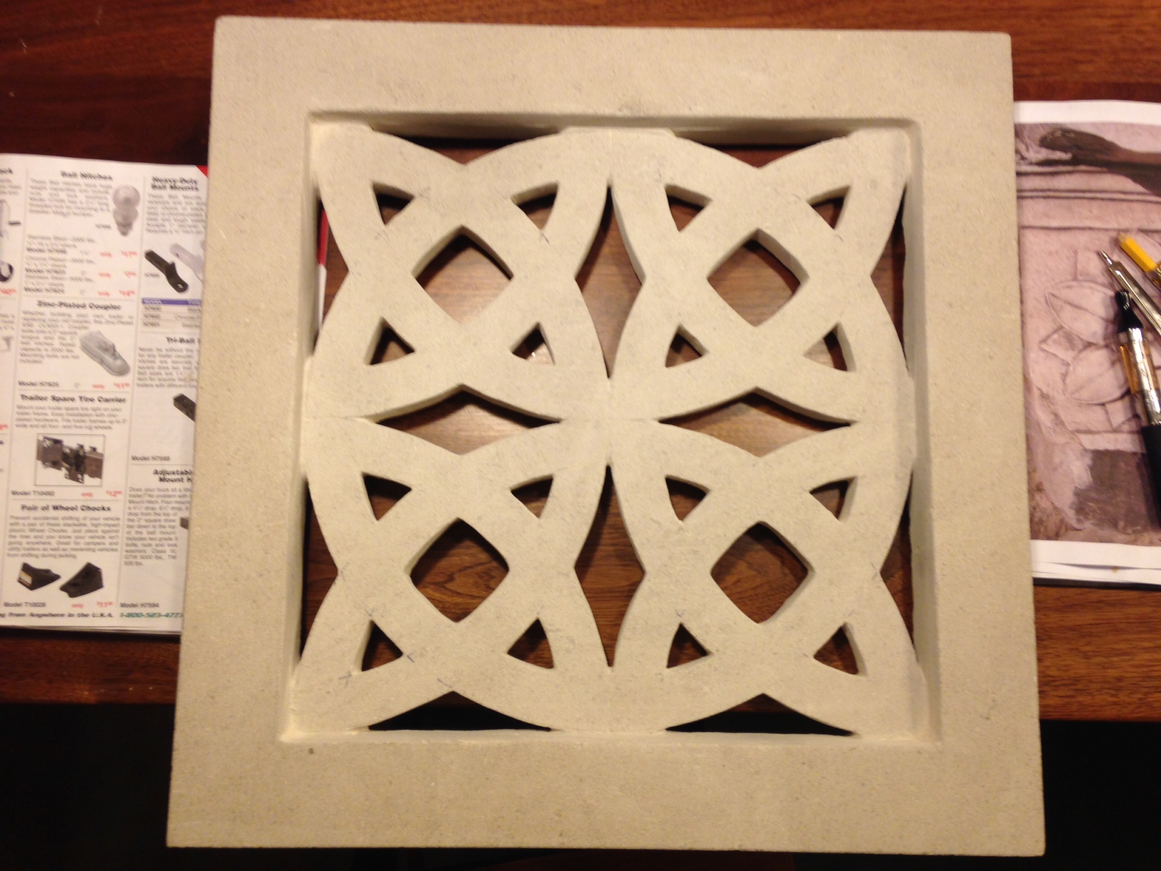

I play with stone a bit, cheaper than golf. I carve panels out of flat blanks, approx 18" by 18" at 1-1/2" thick. See a recent example. I'd want to know if you folks have mills/quarries in your neck of the woods where, say marble can be had in a similar way?? If I can ID a good spot, I'll plan a road trip

That's amazing! :thumbsup: I couldn't replicate that out of MDF. :eek:

Fantastic work on that stone. What are you cutting with? Really nice.

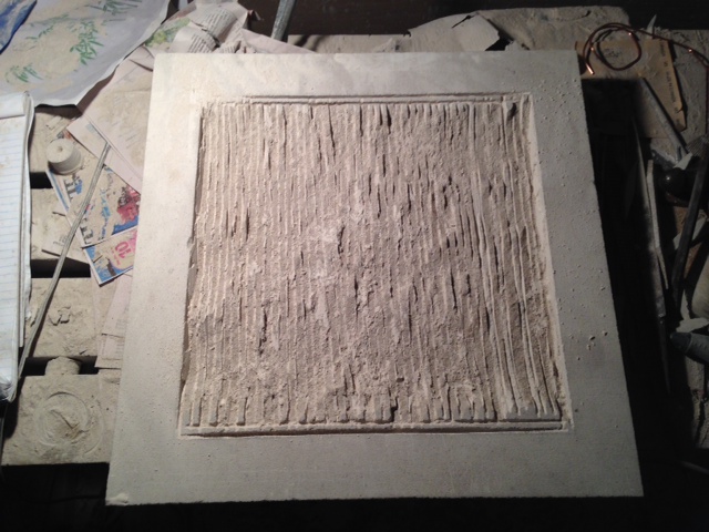

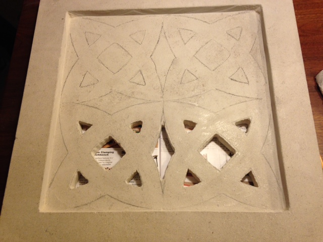

The tools I use are Circle saw with diamond blade, 4" angle grinder with diamond wheel, diamond drill bits, tile files and riffler files. In the case of this pc, a compass to lay it out.
I make panels, so the first step is to cut down the face 5/8" deep to get a frame. Once I grind it smooth, I lay out the design. Carefully drilling and filing to the line.
Limestone is not bad to work with because it relatively soft. But the grain is large, i.e. full of crinoid fossils that are harder than a bugger. I want to try with white marble because the grain is much smaller and can be polished. It is a bit harder but not by much. In fact, marble is just aged limestone. I will be in Carrara Italy this summer but can only drool : ( That is why I'm hoping to hear from my TBN friends for a marble mill/quarry that has a scrapyard. Unfortunately, counter top material is just to thin.
