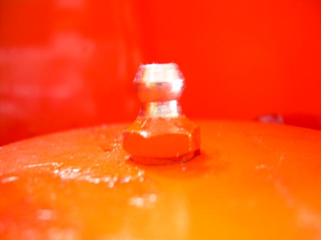

I was just curious if anyone else has this problem and if it was isolated to the type of zerk Deere uses or if it was just me.
That I wouldn't know. If Deere uses an unusual kind of zerk, I didn't know it, but then there's a lot of things I don't know.:)
   / Near impossible to remove grease gun #12

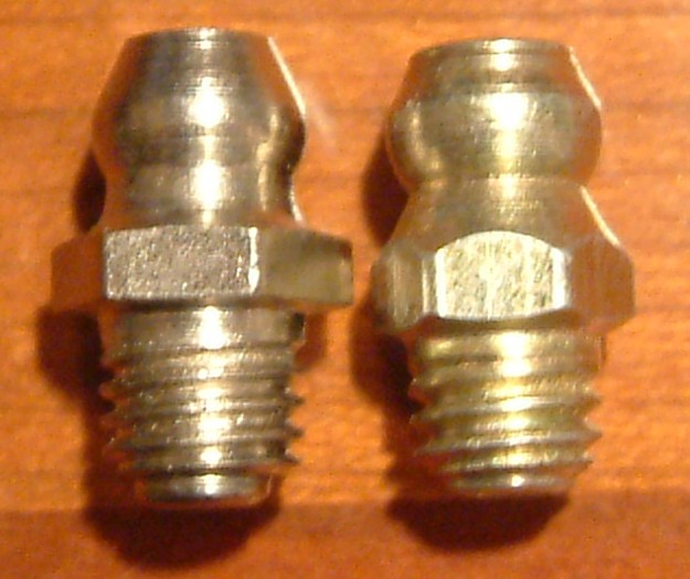

Don't feel bad; Kubota has the same problem :) Seems to be a metric/american anomaly.

Thanks for those pics - at least now I know I'm not losing my mind!
   / Near impossible to remove grease gun #14
Bird is right on with the zert problem. Just loosen the grease gun fitting a little and it will pull right off. Just have to remember to tighten it back up after or you will have grease going everywhere except where it is supposed to go.:)
Mike
   / Near impossible to remove grease gun #15
When i was greasing my fel the other day the grease gun was wanting to get stuck and it was alot easier to get it off by tipping the gun at an angle.
   / Near impossible to remove grease gun #16
after applying grease...push forward with the tip before trying to pull the tip off the zerk. This forward movement releases the fingers inside the tip head and facilitates easy removal. Remember that when pumping the grease in, you have created a "grip" and that grip needs to be released before trying to remove the tip.
