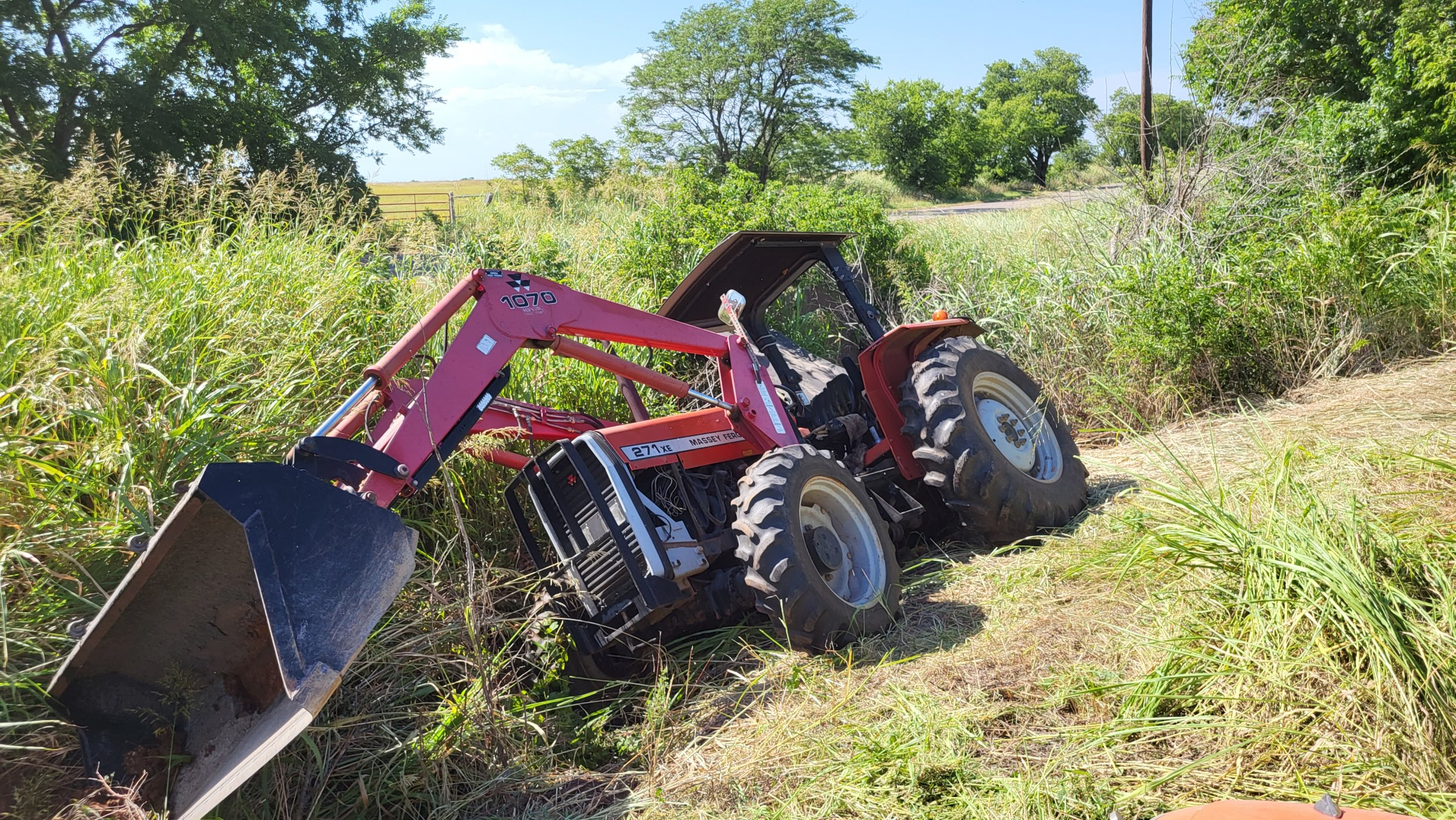

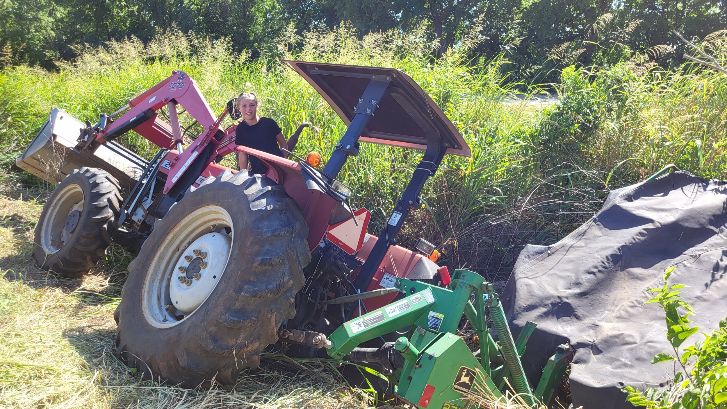

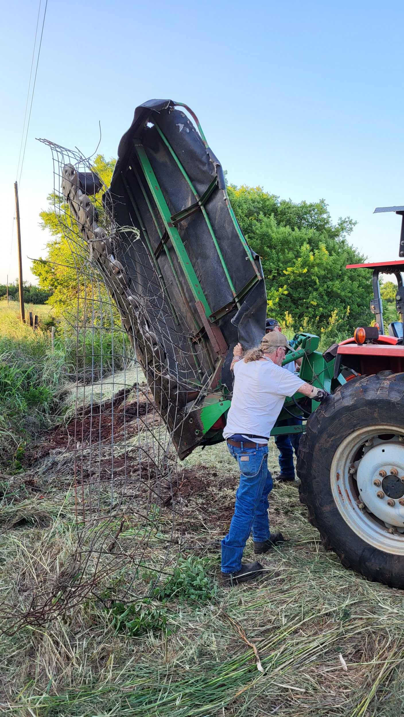

My neighbor was cutting hay at night, on his first round he came up to the fence line and didn't see it until he was in it and started turning and slid into the ditch, was lucky it slid to the bottom and didn't rollover. The Johnson grass was so tall it was higher than the fence. If he would have done this during the day he could have seen other reference points, such as the ROAD on the other side of the ditch, but at night couldn't see far. We've had highs up around 100 so he was trying to stay cool hence the late night....

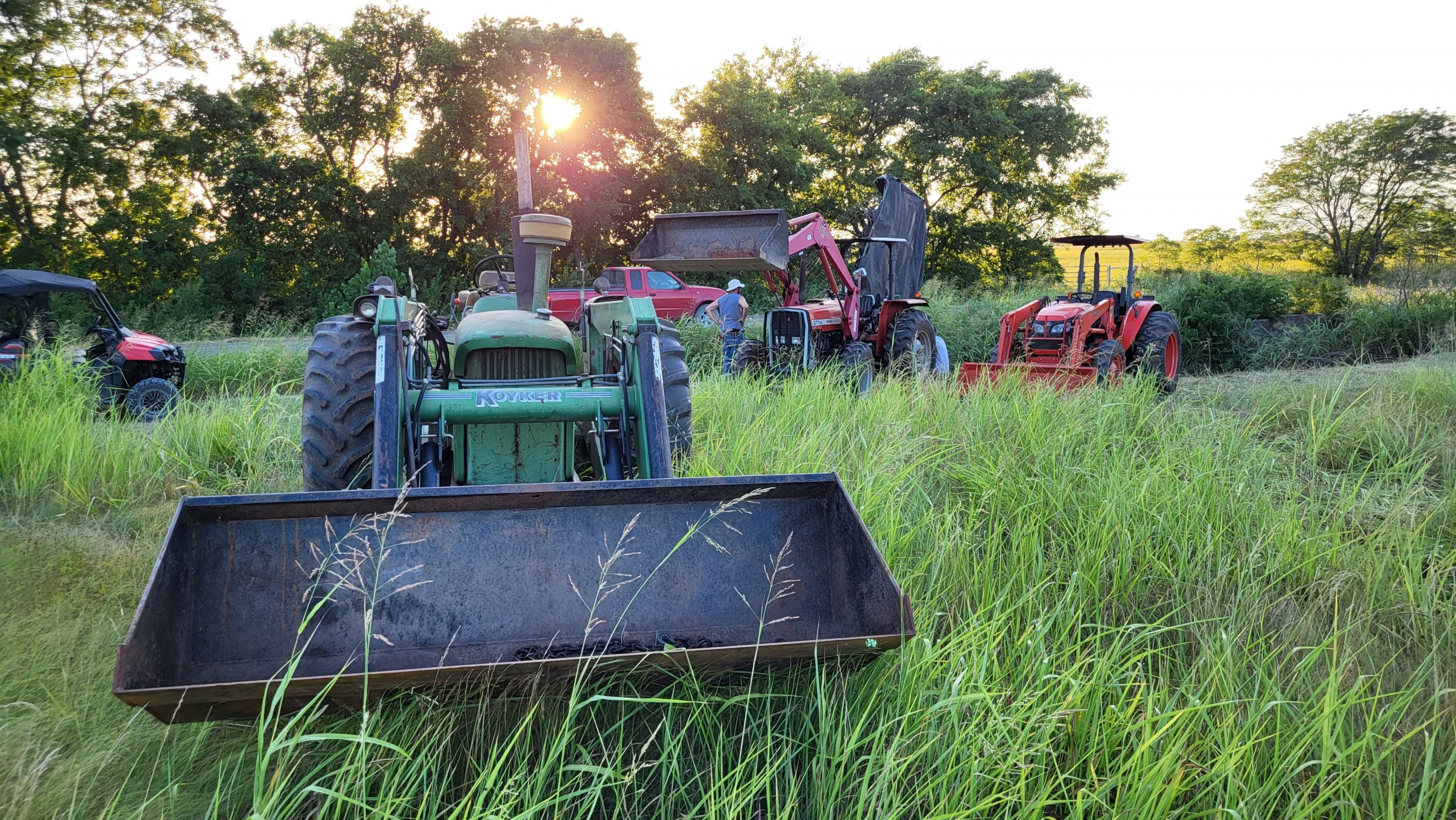

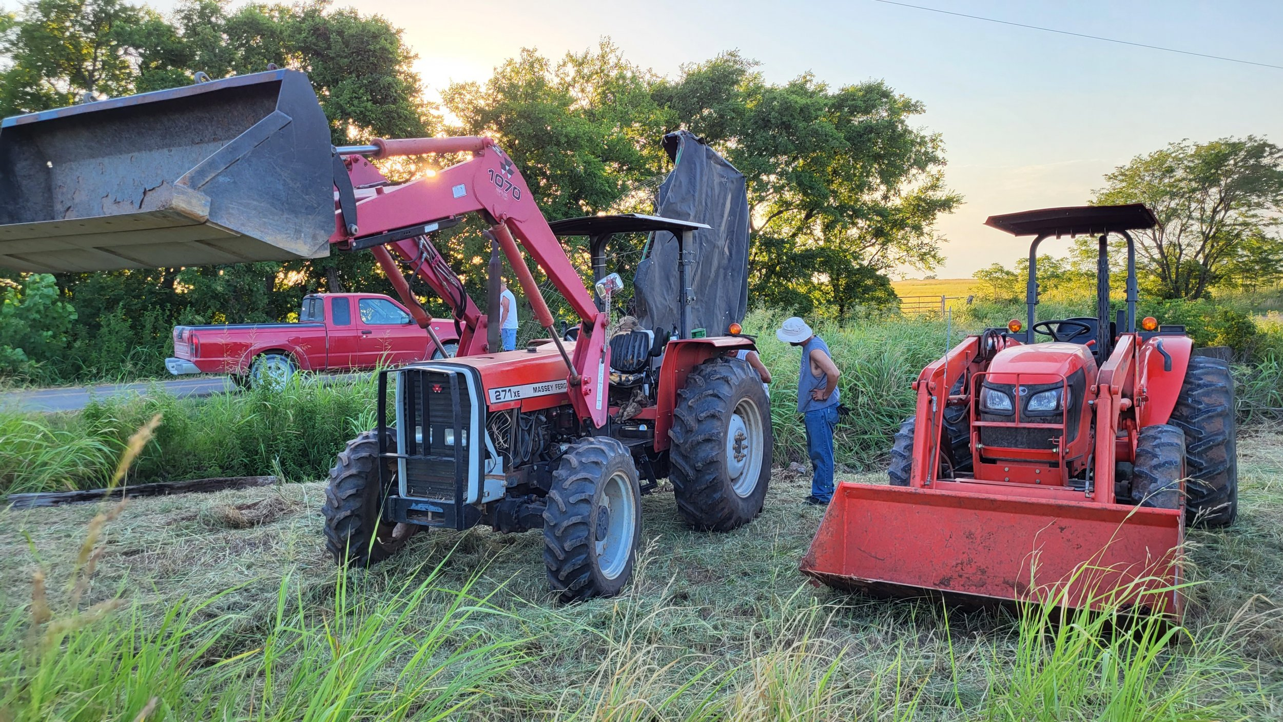

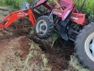

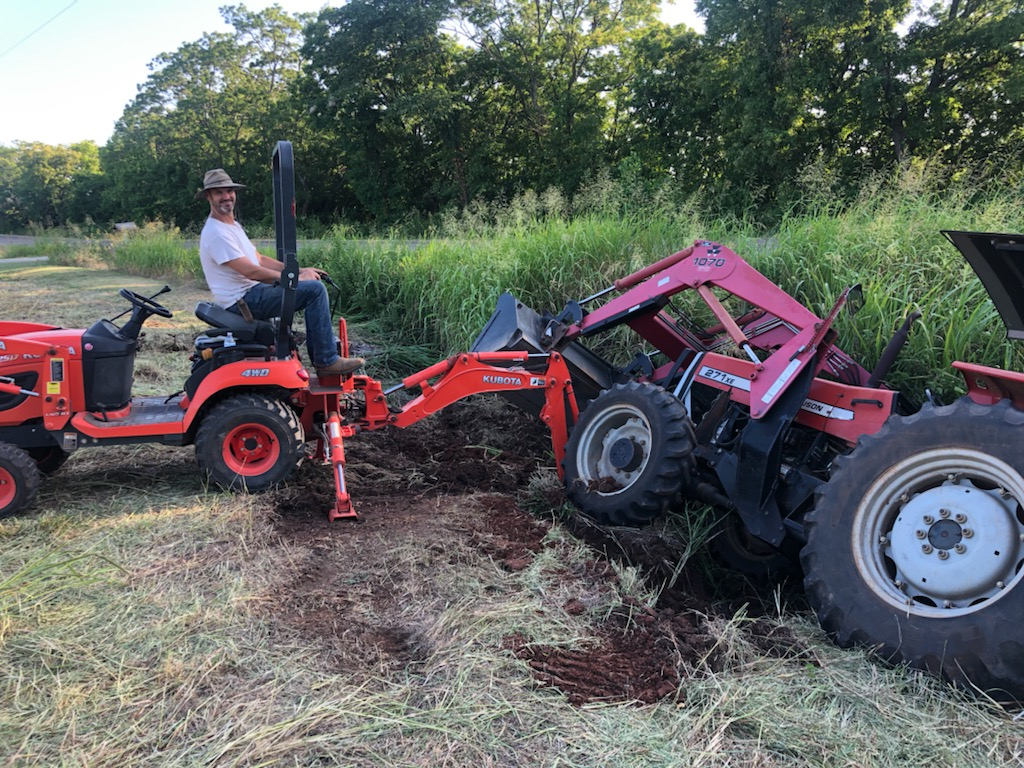

He is fine no injury. Tractor wouldn't start at that angle. I dug out underneath one side and filled the steep drop-off up with dirt to make a ramp up and out of the ditch, my neighbor pulled it out with his 4020.
Also, I've always been told to open up a field with the cutter sticking out into the field, then turn around and drive where you cut and get next to fences etc, which makes sense to me. He was going around the opposite way of what I was taught.

Sweet deal using the SCUT Kubota to get in the tight places.
Nice he had ROPS on the machine too. Glad nobody was injured except a little pride. :)
Once it was out, did the Massey fire back up? It badly needs a new seat too. ;)

Lucky guy. I can't imagine what he though - AT NIGHT - when he hit that ditch. Big ditch and everything is covered very well by tall grass. Can't see much even during the day. Good pictures. Glad things came out well. How was the mower?

I failed to mention the state of the mower.... it broke a weld that had been repaired many years ago, the frame has two main rails but now one is cracked and another piece of the frame is twisted pretty bad, I'm not sure if it's salvageable or not, either way it will be labor intensive to repair.
Once it was on level ground we drained the water front the separators and used a little ether and she fired up.

The little 8" backhoe bucket really shined at this job :)

He said it didn't go all the way to the bottom of the ditch at once, he stopped it first, but though he could get out so he went a little further and then it slid all the way down
He was close to tipping it but not that close. The weight of the mower off to that side helped tip I that way but once it hits the ground you would loose alot of momentum in the tip.
