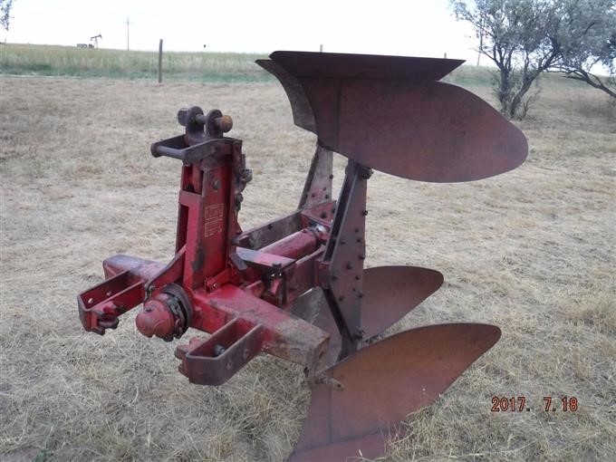

Looking back to my younger days, before loaders were affordable and popular, the concern was keeping the front on the ground. Our MF 135 pulling a double bottom rollover plow was the tail wagging the dog. Wheel brakes were your friend. Weights on the front clanging away. Plowed and planted 15 acres of corn for 3 years as my FFA project.
