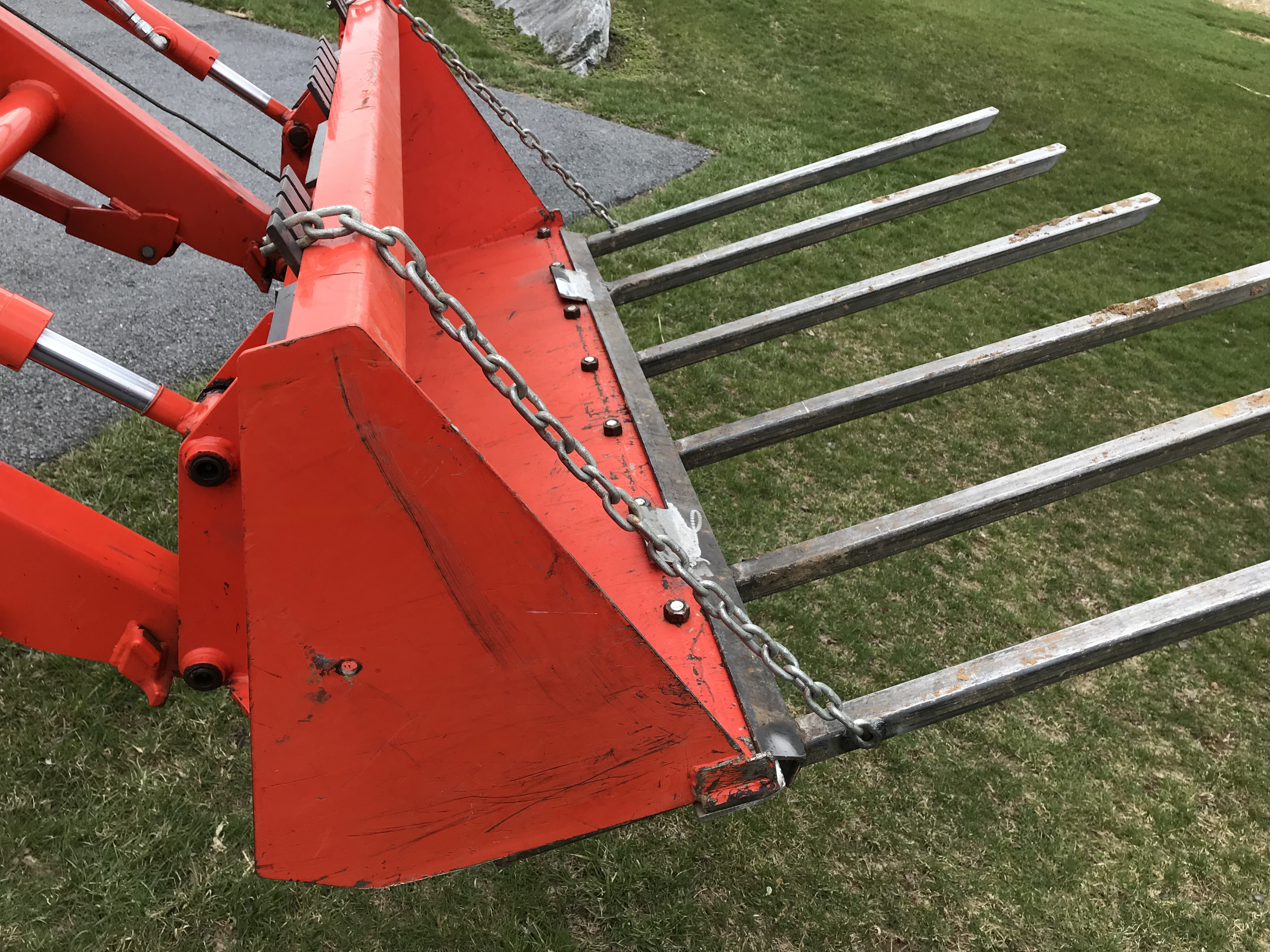

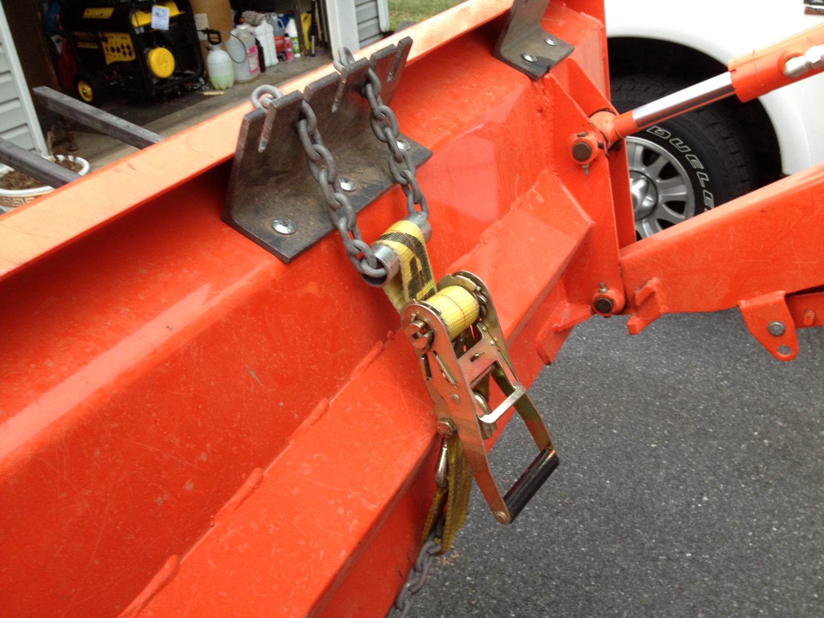

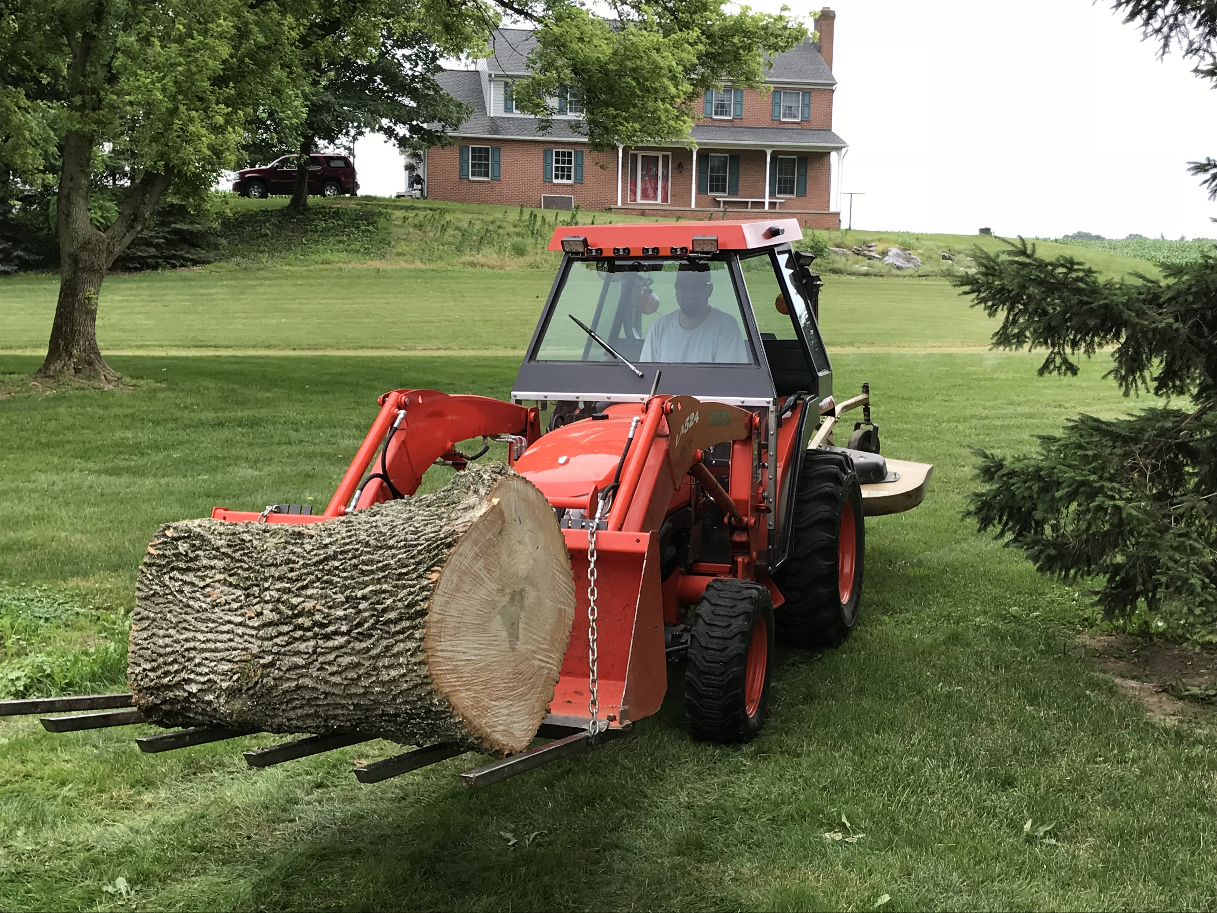

Like this? The chains in the front and two short pieces of flat bar were added after using the forks for some time for a self-install feature. The third picture is when they were first installed back in BC (Before Cab). The forks are fairly heavy. To install them I lay the forks on the ground and park the bucket over top of them. Then just drop the front chains into the slotted angles on the top of the bucket and curl it. To keep them in place, there's a ratchet binder that is connected to a chain bridle under the bucket with a piece of binder strap. Then a short piece of chain that comes into the slotted angle from the rear.
