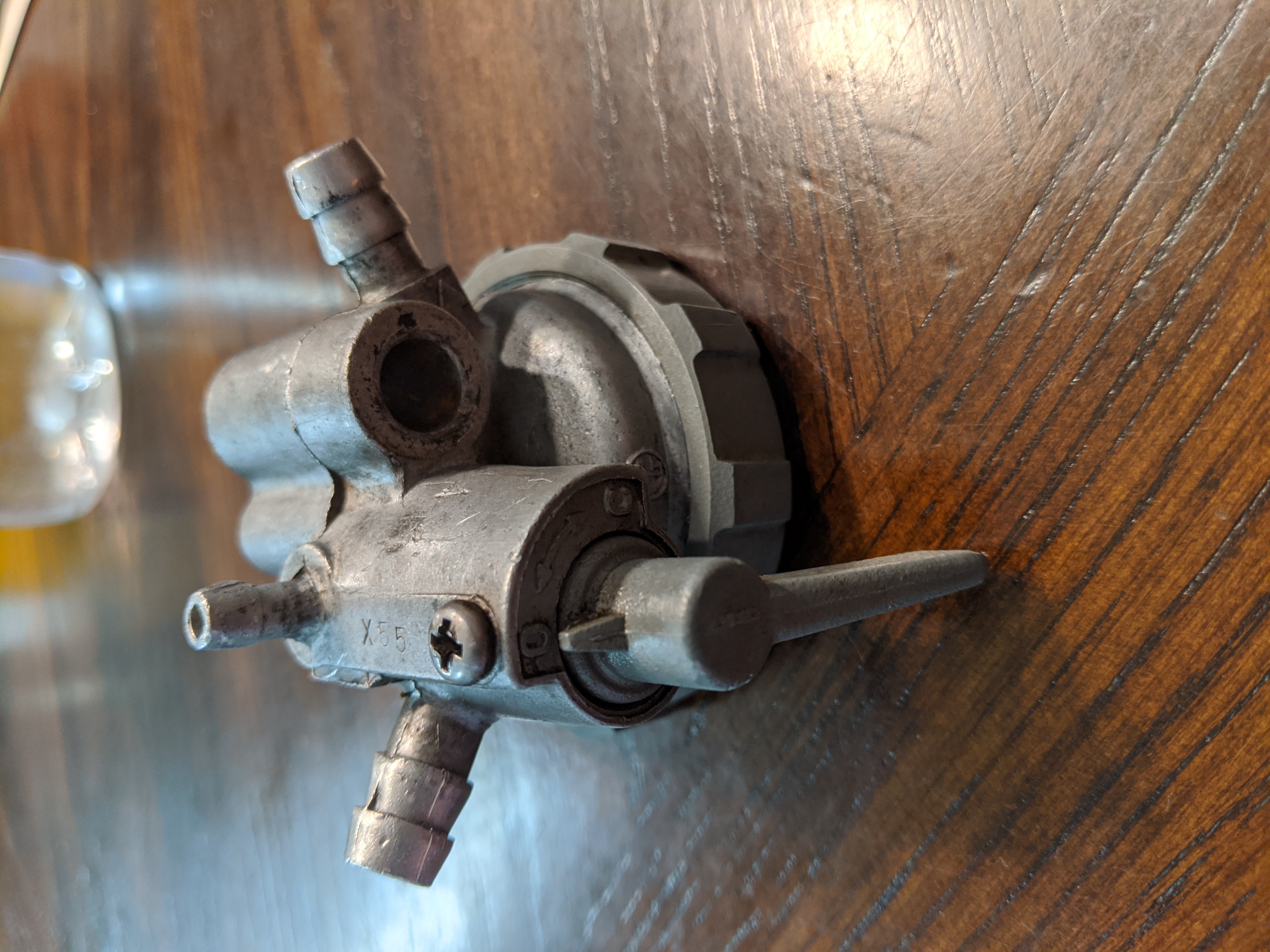

I purchased a ym2210BD a few weeks ago and I've been doing all the basic (fluid, filters, oil) services I can think of. In doing so, I ordered a new fuel filter bowl and filter that does NOT fit (original was missing). I know I can order a new assembly from Hoye but would like to identify this one and just order the correct bowl and filter for it.

When I got my YM2002D and was likewise doing all the basic maintenance and fluid changes, I ordered the set of 3 fuel filters from Hoye. When they came in, I learned the hard way that there are 2 different filter lengths for Yanmars. I was sent the longer one, but my tractor had the short bowl on it.
Is your issue a similar one?

That's the same housing STYLE that's on my JD 1070 (Yanmar equipped). There are two of them on my tractor. A larger diameter one back by the fuel tank and a smaller one up front on the right side of the motor. My JD dealer had them in stock. Filters, too.
Take it to a dealer and have them get show you the bowl and filter parts they have. EBay is probably another source.

CoyPatton, I believe so. The filter and bowl I received were too large of a diameter to fit the assembly I have so the previous owner has at some point replaced it with one from a different tractor. The bowl was busted so he had an inline filter in it's place.

The YM2000 and the YM2210 uses the same FF.. Here is the NAPA.# for that Fuel Filter. 3262. On the Fuel Bowl you also use the same US. version of the YM2000 Which is the YM240. JD. sold back in the day so they're have that or can get it.......... Is that a 2210 or 2000. Fuel Filter assembly? The hose connections are at a angle I noticed so that may not be correct.....? Take it with you.

Careyo63, your right, it is not the correct filter assembly for my ym2210bd but I didn't realize the difference until I had already ordered my parts. So now I am hoping someone can identify this particular design so I can order the correct parts for it. I'm going to a JD dealer today to see if they have one. Thanks for info.

Well I guess I have an oddball filter assembly because the JD dealer tried several different bowls and filters that were John Deere & Yanmar but couldn't find one that fit so I guess I'll be ordering the whole new assembly from Hoye. Thanks for all the input and info guys.

Napa makes 2 filters for that tractor, a 3262 & 3263 one is short and 1 is long.
The bowls are plastic and they brake sooner or later.. You could just order a new plastic bowl and filter from Hoye tractor.
