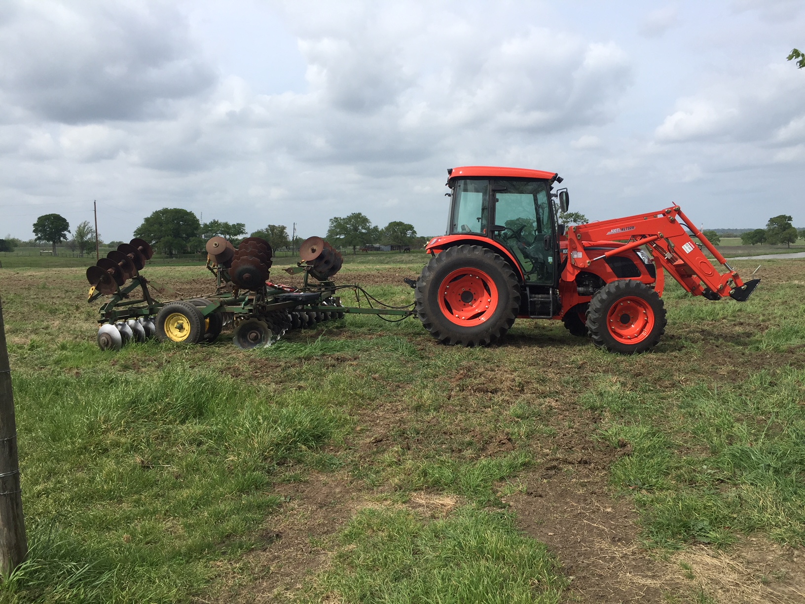

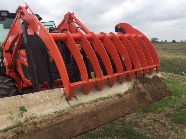

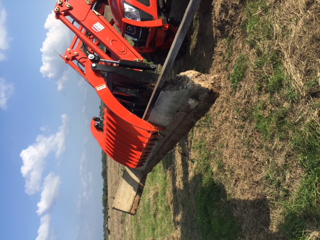

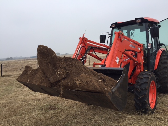

If you want a suggestion on a new one, I went with a Kioti RX7320 with the power shuttle transmission and cab. Tractor is rated at 73HP but it pulls a 12" John Deere disc way better than it should on hard ground and damp clay soil. The loader is very stout, unloaded a 10' double row cultipacker (about 2500 pounds) from the trailer and never took the tractor off of idle rpm and it lifted it just fine. Handles a jumbo rock grapple and 10' Shulte mower without problems. So far I am very pleased with this tractor.
