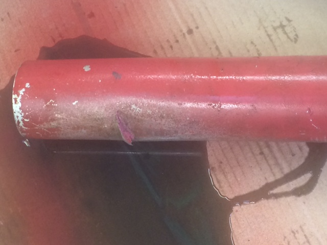

I've been having trouble with my FEL since reinstalling it. The boom would lift extremly slow, if at all. After replacing the diverter valve and then the selector valves I finally found the problem. The right side cylinder was bent. The boom cylinder looks to be 2" ID and about 42 inches long collapsed.
c The attachment points are 1.5" diameter and cylindrical with a 3/4" hole for the pin. Aluminum threaded on ends and casing. Anybody know where I might find one (or two). No data plate so I have no idea what brand it is.

A good local hydraulic shop could repair that by replacing the bent tube.
That might be worth a try. I'm not finding anything matching the pin ends and 40" collapsed length online except in Australia.

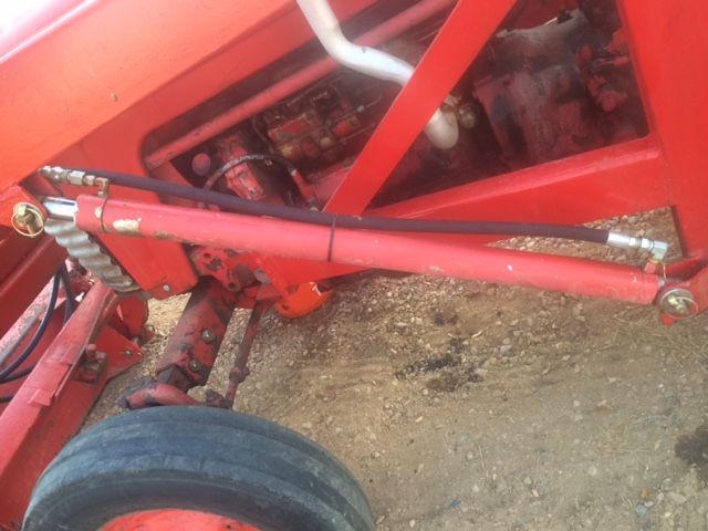

Found the cylinders that are on my FEL. Looks like a previous owner must have had access to an auto hauler as the cylinders are identical. Have the damaged one fixed locally by hydraulic shop.
