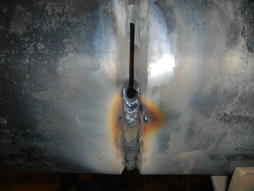

Here is a picture of open root welding with 6010. But it is a good picture of a key hole.
Shield Arc, I have turned the machine so it just makes a puddle and still get a wide weld on the under side. On another post I have about this job someone suggest using 6010 root and 7018 rest of the way out. I don't have any 6010 on hand so I used 3/32 6011 on a coupon. by using a little more amperage than I was using with the tig I got an acceptable weld on the back side. The only problem is the flux on the back side. I can't get it off inside the pipe and as it breaks off over time it will destroy the pumps. I have a 110 wire machine I am tempted to use and see what I get. Can a guy get any different results with an inverter tig machine or would the end result be the same?

For TIG prep, I grind the bevel to 37 Degrees with feather edge landing. Depending on the size pipe or length of plate in your case, a gap of 1/8 to as much as 3/16" or more is set. The gap will close a bit during welding and if the weld is large enough like for instance a 24" or larger pipe, you may start with with 1/4" at the bottom and use a 1/8 or 5/32 rod then switch to 1/8 as the gap tightens and perhaps finish with a 3/32. I have had to take a grinder and widen the gap when it closed completely up.
In your case, I think you are running too many amps, not feeding enough wire and possibly travelling too fast. You need to keep the key hole open in order for the bead to be above flush on the inside. If it closes up due to travelling too fast, stop and grind the weld thin so you can burn thru it and then continue with keyhole welding.
Gary, Thanks for the input on this job. It is a little more complex than I originally thought. I have everything cut and drilled for this piping job but the tig welding part is not yet acceptable. I have been looking around locally for someone to weld this but have had little luck so far. I wanted to get this installed by this fall but that is not going to happen.

Gary, I ran a couple of coupons on 3/16" hot rolled material with the 1/8" gap and ground to a point , no land, it looked pretty darn good. A few more of those coupons and I should be up to speed. I ran roughly the same amps as I did before with the land, But with the land and a 1/8" gap I could not get the key hole. So the problem was having the land.
I do not have the cape ability to do hot oil flushing or a high pressure/high temperature steam blow so I would assume filling the piping with citric acid before it is installed and let it sit for awhile would be sufficient. Then flush with water, Yes, no??? If so how long should the citric acid sit in the pipes? The pipes are two, 2 1/2" pipes about 3 feet long and Two, 2 1/2" pipes a little over a foot long, and one two inch pipe about 16" with caps on each end.
