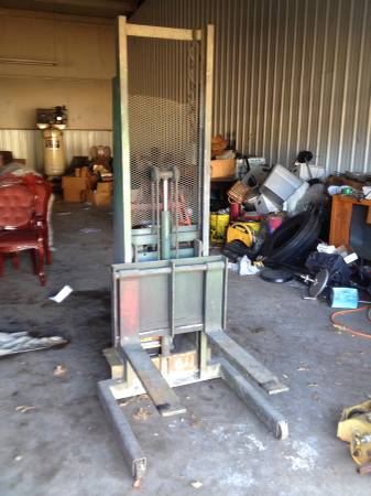

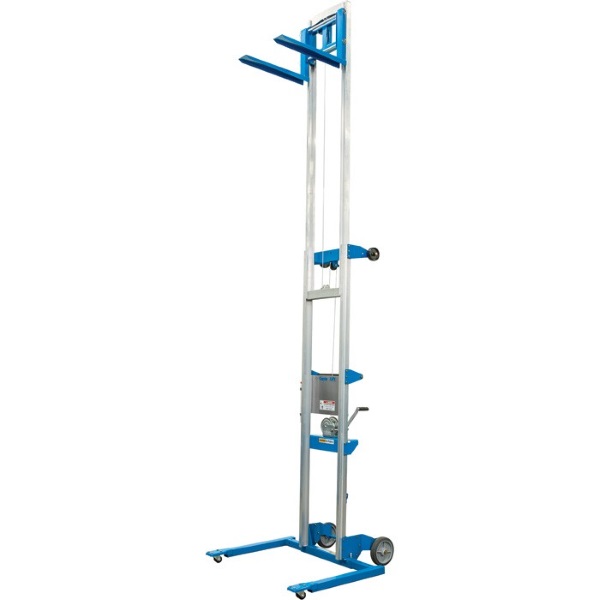

   / Need a lift idea #20
Here is one in the OPs area, its a push around, not a power drive like the one we have, but it would be a lot easier than cranking a hand crank one up: Electric Fork Lift Stacker plus 3 units HD Shelving - business/commercial - by owner - sale
