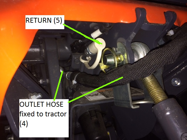

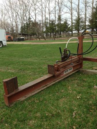

As one other poster has done, I picked up an older Bush-Hog brand Log Splitter 3 Point mounted.
I want to just try running it with the BX25D on board pump and hydraulic ports, but confusion crept in and I'm hoping to get some input and help.

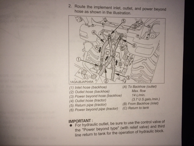

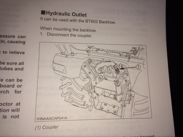

I have doctored some pictures and taken a shot from my manual.
First question What is Power Beyond? Or what does that refer to.

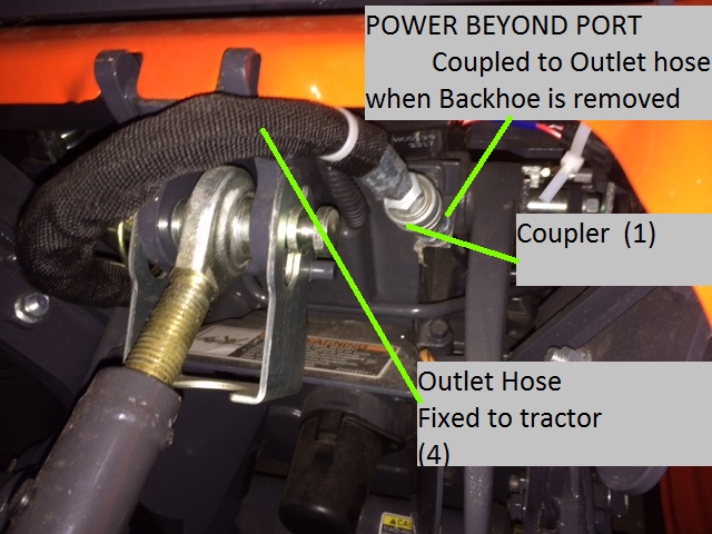

I have two lines on the splitter to couple to the tractor. An inlet and an outlet. HOWEVER... the tractor has an outlet hose, that loops to the Power Beyond Port on the tractor. And the Return pipe has a cap.
I would guess that the splitter return line, would go into the return pipe (white capped on tractor)
The mystery is trying to understand what the hydraulic fluid is doing when the backhoe is removed and that looped line is there.
If I hook up my inlet to the splitter to the (4) Outlet Hose Tractor (looped when backhoe removed) what do I do with the "power beyond" port that appears to be a return.
ALSO... If I combined the Power Beyond and the "tractor Outlet... would one get higher GPM. The tractor pump is rated at 6.2 GPM, but the Tractor Outlet hose (per the picture below) is only 3.7 GPM. I'm guessing the Power Beyond is also just an additional pump outlet? Would they be common or equal pressure from the pump? Would they combine to make close to the 6.2GPM. That's nearly double the output that could go to the splitter ram.
It's all a bit confusing so take a look at the pictures and tell me what you think.
Thanks for the help.

I also have a BX 25. The Operating manual does not provide much info on what you are seeking. I have studied the hydraulic system in the Workshop Manual. I always recommend on these posts that if you are doing any mechanical service or work yourself then the WSM is a must have. You can order through your dealer, any other source is violating Kubota's copyright.
As far as I know the GPM is the same throughout the system, that is what the PB circuit does. The PB circuit is a continuation of the power (P) output of the pump. I goes from P to PB to P as it continues through the BH, FEL and then the 3PT control valves. You cannot connect it any other way. Each valve cluster has a return to the hydraulic sump/tank the T connection.
You can connect the splitter to the P and T connections leaving the PB hose hanging plugged. You need the splitter set where you want it as once connected w/o continuing the PB the FEL and 3 Pt will not function. You will get the full GPM to the splitter.
With that used splitter you need to purge the hoses, valve assembly, and cylinder with new SUDT2 fluid as you do not want to mix UKN fluid and maybe dirt into the tractor system. You need a QC fitting to put in the T hose to do this. Purge each posistion of the valve till you get clean new fluid flowing from each side. Dispose the purged fluid same as crankase oil. You may need up to a gallon or more depending on cylinder size.
If you are mechanically inclined you should understand this dialog and fill in the blanks as it is not as detailed as if I was standing over your shoulder. If not you will probably be dependent on your dealer's shop/friend/neighbor to help you. LOL

Ok, the outlet hose from the left side is (P) and disconnects from the right side (PB Steel pipe hard fixed to tractor)...so If I understand your description of the Hydraulic system, the P and the PB are the same potential. So...by combining them with a brass "T" (or equivalent) will not gain me anything in GPM?
Will combining them essentiall keeping the loop (when BH disconnected) keep fluid going to my 3PH arms and FEL, so I can pick up the splitter. Seems like a PITA to have to unhook the splitter hoses, and reconnect the jumper hose...P to the PB port to have hydraulic lift. Win Some Lose Some type problem? Very curious if there is a way to connect to keep all things working.
Completely understand the fluid issue, and will order some Super UDT2... Best I'm seeing it at is $`$28 a gallon (Messicks) to the door in a 5 gallon, I'll call the dealer too, but they are quite a ways away, so gas money time etc comes into play. Lowest price I saw on 1 gallons was $28 and $9 shipping.
I glaze over when it comes to Hydraulic couplers too, You mentioned a QC fitting to put in the T Hose (fixed port on tractor?). Is the QC what's on the Kubota BX 25 stock? I can work through this, as I have a hydraulic hose supplier nearby that I can get all of it figured out, but knowing some of the numbers helps. On the splitter, one hose is open right now, and one has a Pioneer fitting on it, which will come off, so I can purchase any correct fitting to complete the connection.

Perhaps I can help.
Your hyd system is an open center hyd system, and the log splitter should have a open center valve on it to work correctly.
If your valve has two lines, the PB out of the tractor should be connected to the IN port on the log splitter valve.
The log splitter return line should go to tank/return line. Like your capped return line
All PB pressure lines can handle the pressure developed by the pump and hyd components, and connect from valve to valve in a series configuration.
The loop is the PB feeding the 3pt.
The return pipe with a cap, is for a return flow like from a log splitter or a BH.
If your log splitter has three hoses or outlets, the log splitter PB line would go to the 3pt in port, and provide all functions including 3pt.
Option 1,
and I don't recommend this, but if the log splitter valve has two hoses, the return could go to the port for the 3pt and provide a complete path..
The only problem with this is that the log splitter OUT port is not designed for high pressure, and by routing the flow through the series hyd circuit, the log splitter OUT port could see up to 2500 psi. If you simply want to position the log splitter, you can probably get away with the configuration.
When you remove the log splitter, re-connect the loop hose.

One can not tee into a series hyd path for this reason. The fluid will go to the path of least resistance.
Where the BH PB line goes to the tractor, that is a high pressure port and feeds the 3pt.
Since your log splitter valve does not have PB, and you don't need the 3pt, use the tank port.
If you need the 3pt with the log splitter, then you have to send the OUT flow from the log splitter to the 3pt in port.
There should not be any pressure on the 3pt hose if not coupled to the PB port on the tractor.
If the PB hose has a QD on it and you start the tractor, you will put the first valve in the hyd system into relief, and the hose will get tight.
If you plugged a hyd gage in that QD, you would read system pressure.

It's beginning to make sense. I think my biggest confusion is the Kubota Owners Manual diagram. After looking again, it says PIPE meaning a metal pipe (item 6) the verbage in the description is still confusing. The "B" hose has an arrow pointing up to the PB PIPE on the tractor, suggesting that the fluid is going into that port (PB).
I'll start getting things cleaned up and my fittings sourced. will probably try it first with the old ENERGY valve and do some timing, then replace the valve if it's horribly slow.
