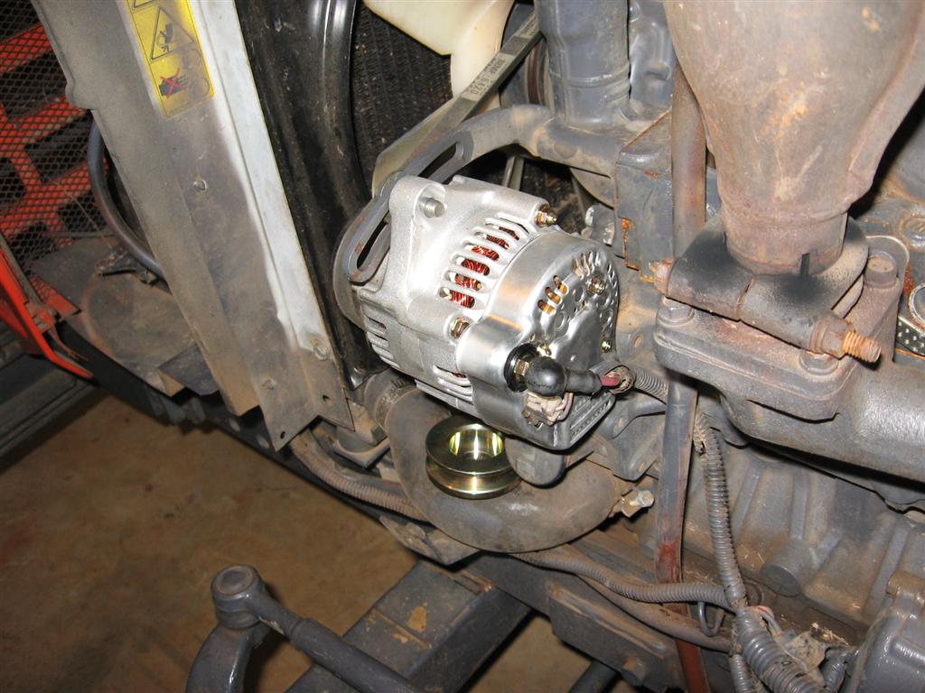

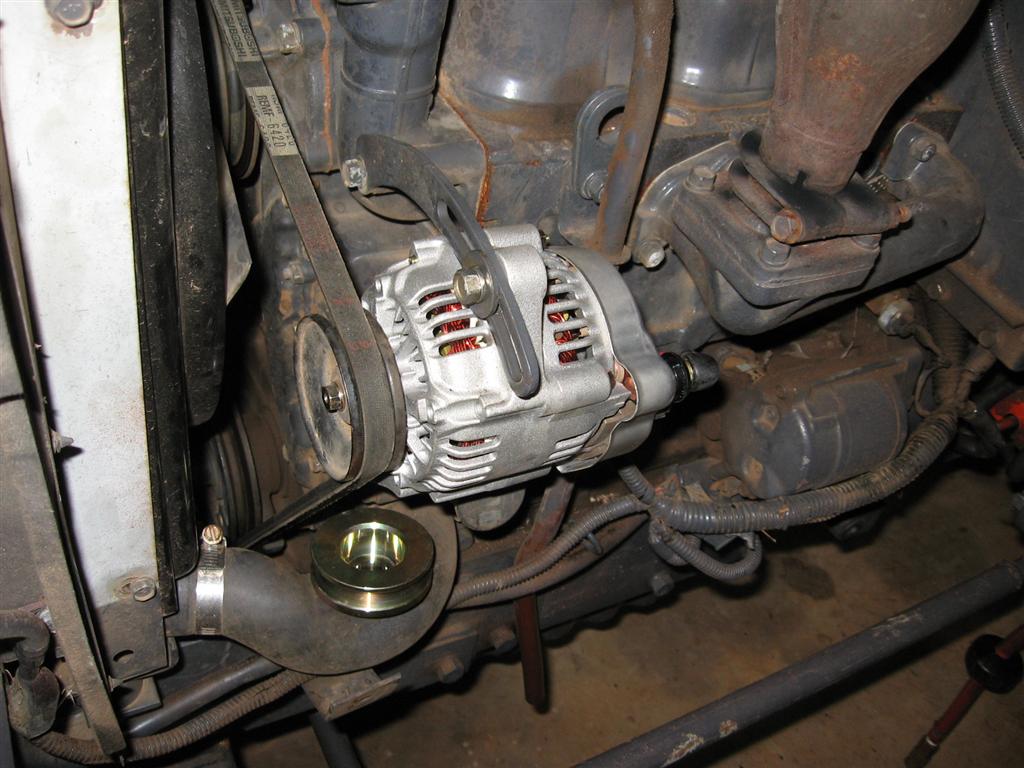

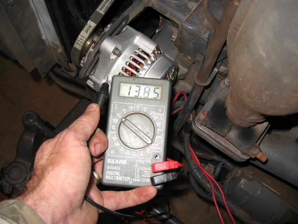

Well the alternator works just fine. I did have to change out the pulley, just a bit smaller than my old one...good eye there Barry!! Through some testing the key does have to be on for it to entergize it. When it went out I had the habbit of turning off the key (L2500 is a gear tractor, pull rod to kill motor). I had about 3.5 hours of seat time yesterday and all is well. Could hear it pull on the motor a bit at first. Since the idiot light does work, I'll probably not put the gauge back on.
And some pics of course!!
Milkman, shooting you some pics later.
